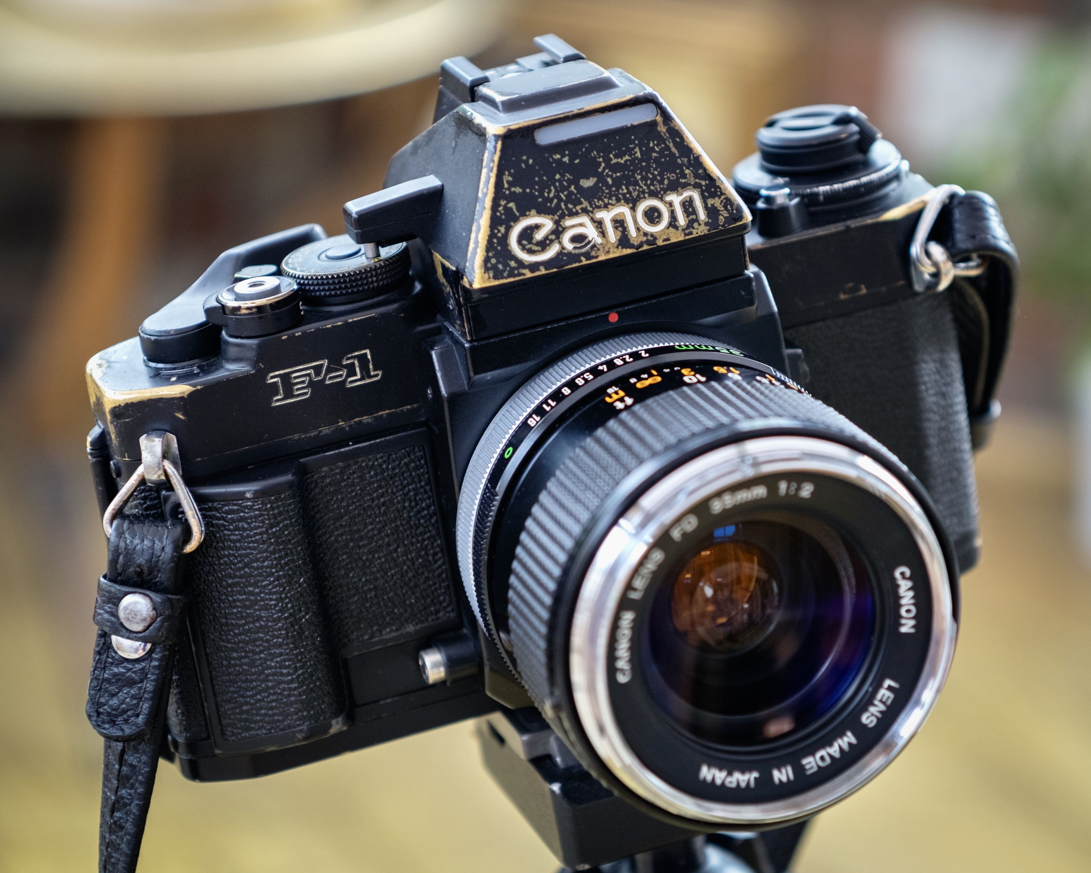

This is possibly my favourite SLR - attached pic of my camera.

Looks like a well loved well used example
I think these had a reputation for the paint finish being a bit prone to scratches/flaking. This came from a shop in Japan - the brassing had been badly covered up with a Sharpie marker pen and it looked a right mess. I noticed the viewfinder/focus screen were pristine and it all worked correctly so bought it. I think it was a well used and serviced camera. Later I found under the door film plate, there were about 15 service stickers one on top of another… This F1n has the best ‘wind on experience‘ of any camera I’ve used - it’s so mechanically satisfying and like loading a gun.
