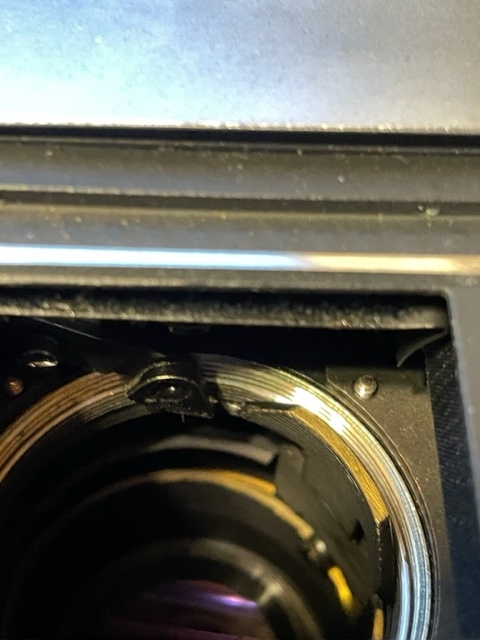

I received a Canon 135mm 3.5 LTM lens that won't mount on either of my FED 5B cameras. I suspected that the rangefinder arm was getting in the way and I was correct. I put the shutter on B and mounted the lens by suppressing the rangefinder arm from the back and I was able to complete the mount. Is there a right way to do this without resorting to these extreme methods? Leica lenses and Industar lenses do not have this issue as their rangefinder driver is circular. Please see photo for reference. Many thanks for your responses.

Not really. It is generally telephoto lenses that have this issue of the "tongue" rangefinder cam - other telephoto lenses besides Canon sometimes have it. Normal and wide angle Canon lenses usually have a rangefinder cam that goes all the way around and don't have the issue.
The Canon RF camera bodies have a circular RF feeler that is free to rotate, but the Russian RF bodies have a feeler with curved surface, with a pointy end that jams on the end of the lens's tongue RF cam when you mount it.
