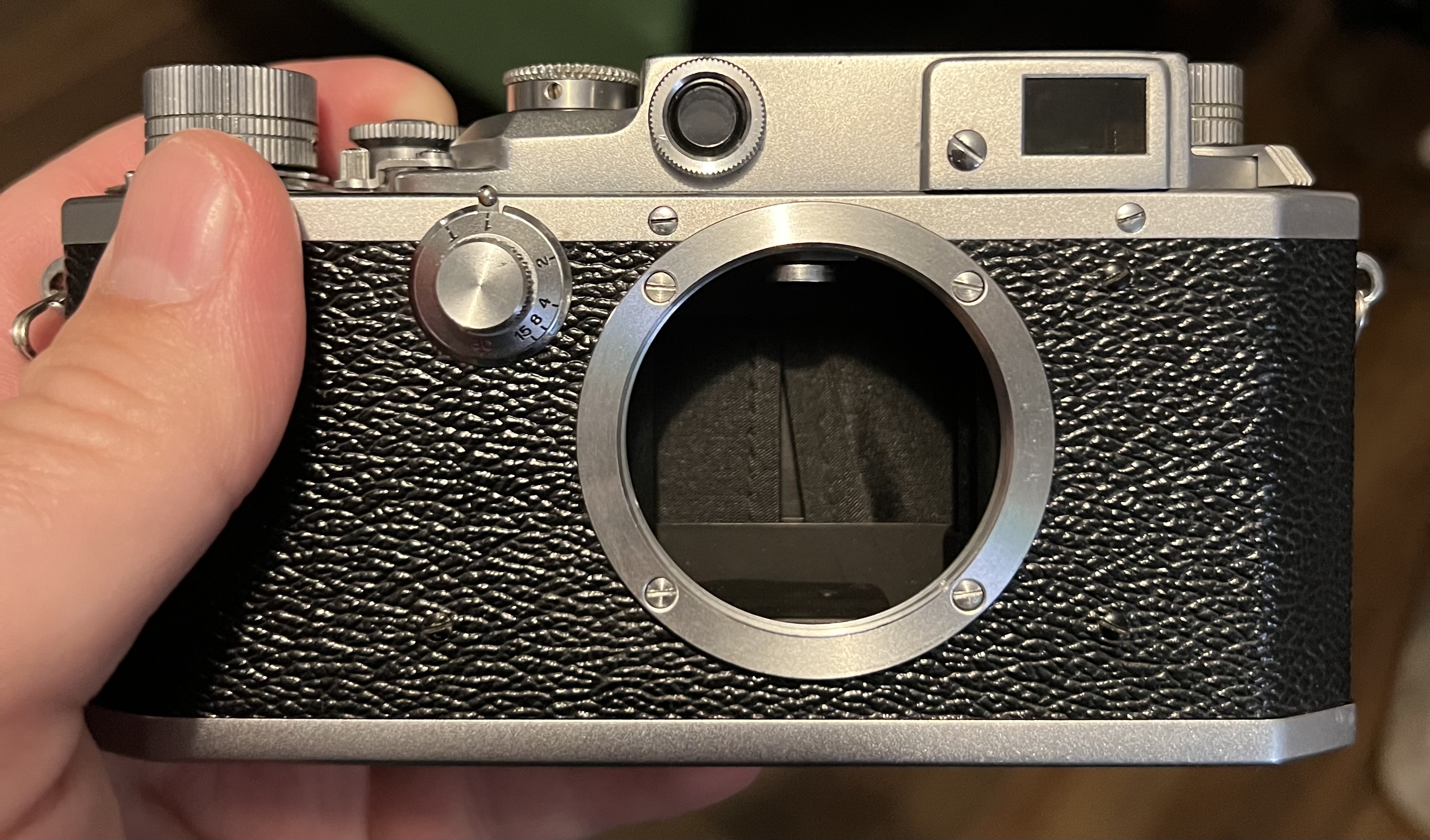

I just got a Canon IIF2 from KEH. It was graded EX+ and is indeed in very good cosmetic condition. Unfortunately, they seem to have missed a problem with the shutter. Specifically, when winding/cocking the shutter, as the curtain edges travel across, the bottom edge of the first curtain is behind where it should be leaving a (triangular) gap between the curtains.

Photo of the problem (midway through cocking the shutter):

It looks like the lower first curtain strap has detached from the roller or is torn, or has detached from the curtain.
You would have to take the body apart to see the curtain straps.
If it is just detached from the roller, you should be able to glue it back on.

Fixing and tensioning shutter curtains is not trivial. I would return the camera to KEH for a refund.

KEH called back today to tell me they're giving me a $100 refund because the camera was graded incorrectly and should have been As-Is instead of EX+. That means I paid $49 for it, which is close enough to pennies that I'm comfortable at least taking it apart and evaluating it. Having done so, it appears that the ribbon has come off the "bar" at the end of the first curtain (not sure what to call it) due to the stitching holding it on coming undone. The curtains themselves and the ribbons are otherwise in good shape.
