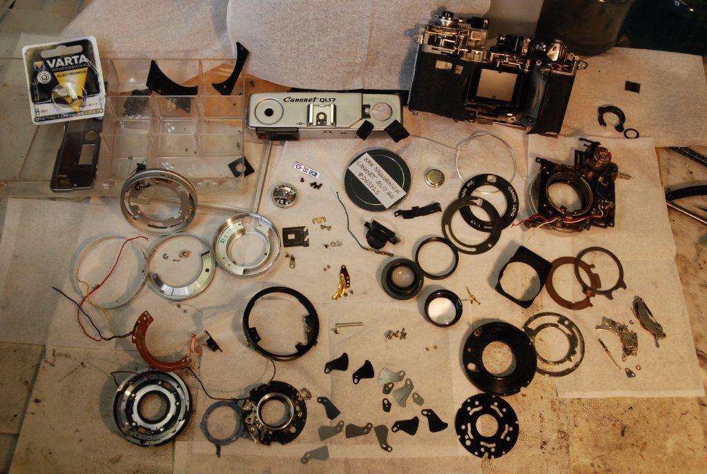

Wonderful camera. But they are reportedly very tightly toleranced. Word is, once disassembled they are a challenge to reassemble without the proper custom tooling and knowledge. Lots of stories of correctly working ones opened, only to then become donor parts cameras.
Here is a picture of mine with the front end disassembled and laid out. A professional technician did the work you see, not me...
Ken
It's a very tricky operation to remove the lens and reattach it.
And the foam is some really messy stuff. It will take a while to remove all of it.
However, the good news is that it will be worth the effort. Excellent camera overall. Nice build quality, a sharp and fast lens and a really nice viewfinder/rangefinder.
