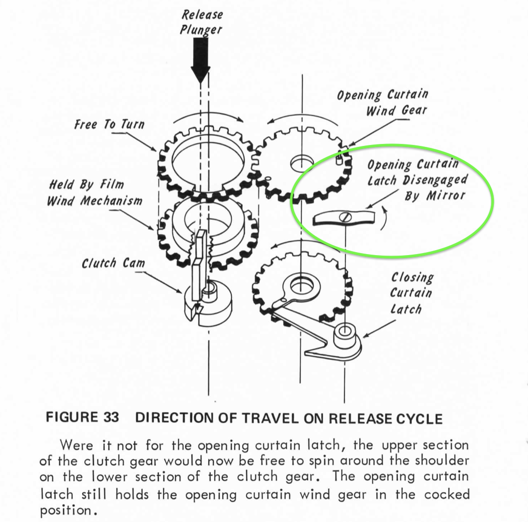

Mid roll started to shoot while advancing to next frame. Shutter wouldn’t cock to press shutter button, it just fired itself.
Worked fine on last roll.
Any ideas why this is / where to look to troubleshoot? Was hoping to take this overseas in a few days!
Thanks
May be the opening curtain latch is not catching.
