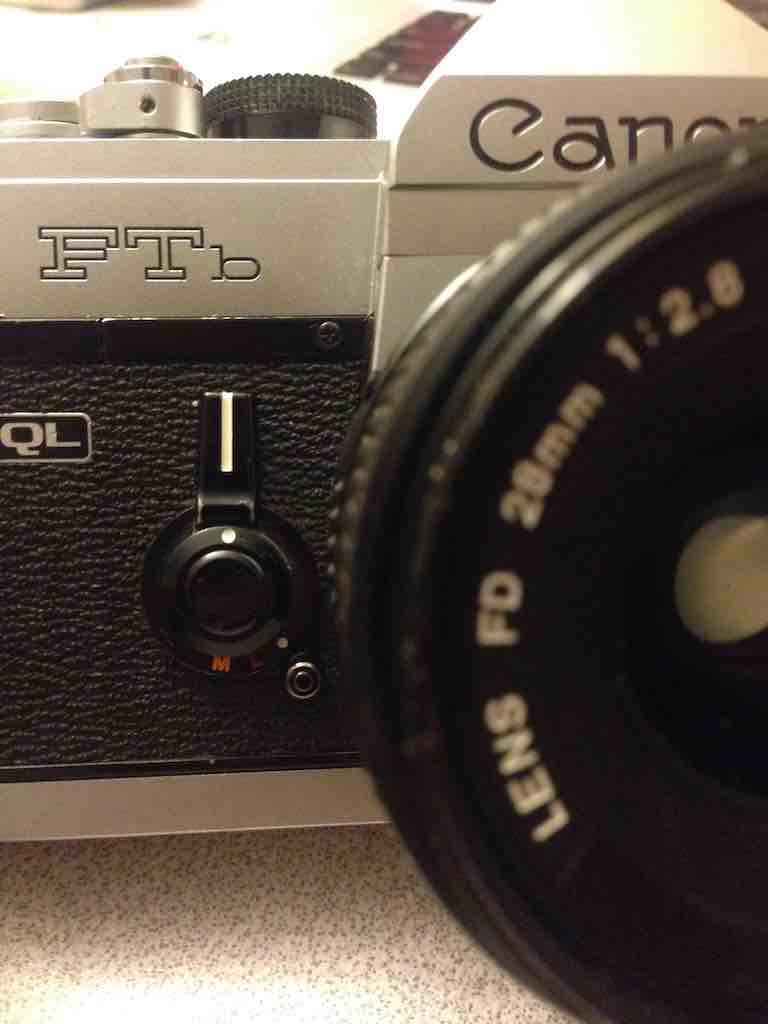

This is a picture of the outside thing that I know can mess with aperture settings. It's on the white circle.

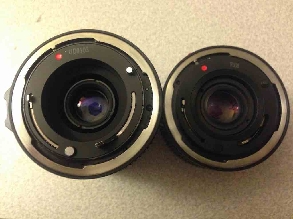

These are the backs of the lenses in question: on the left, a 50mm f/3.5 macro, which works with the body; on the right, a 28mm f/2.8, which does not work. To my untrained eye, these mechanisms look the exact same, other than that the 28's seem to have gaps under the silver things while the 50's mechanism has full, silver-colored bars.

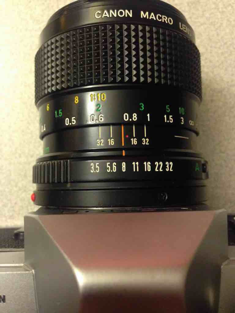

I set the 50 to f/8...

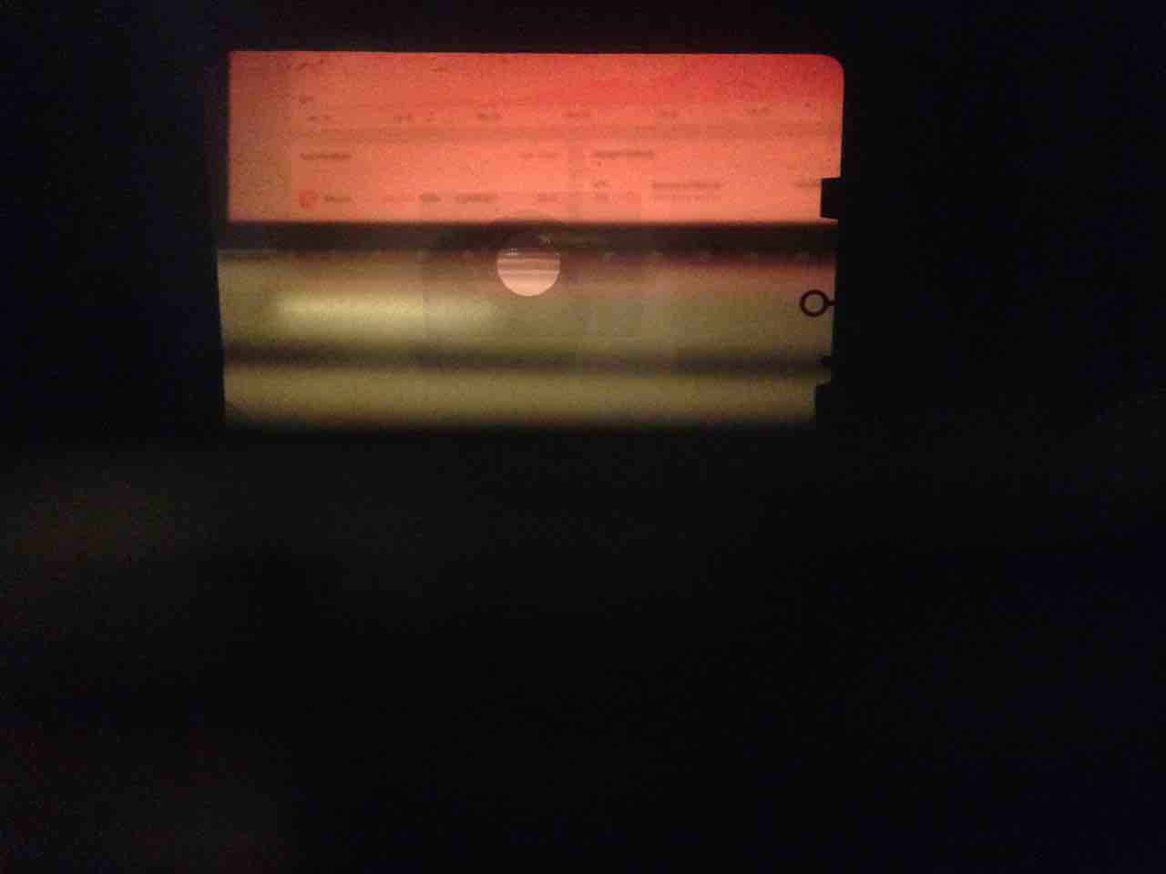

... and the lollipop moves! Just like it's supposed to.

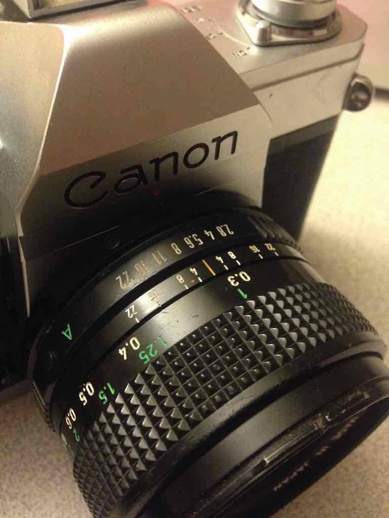

It's set to f/5.6...

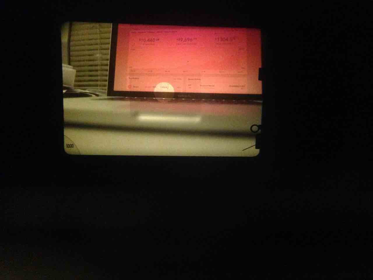

And yet the viewfinder lollipop is set as if the lens is at 2.8.
To me it looks like the lens on the left has 2 aperture levers and the one on the right has one.
The lens on the right aperture lever appears to be shorter than the lever on the lens on the left.
Use a fine graduation ruler and measure the aperture lever height from the lens back, all lens of this type should be the same, if not check that the lever is not pushed in.
Also check that the body aperture lever is not bent or pushed in from improper lens attachment/attempt.
Just my observations from reading the thread several times.
While the aperture levers are the same height and length on both lenses, I found something interesting while checking it. On the lens on the left (the 50 macro, which works), the large aperture lever, when pushed on its track, locks at the very end of the track. However, on the non-working lens (on the right, the 28), the lever does not move the entire length of the track (stopping about halfway), and does not lock in any position, just springs back to the original. Does anything stick out there?
