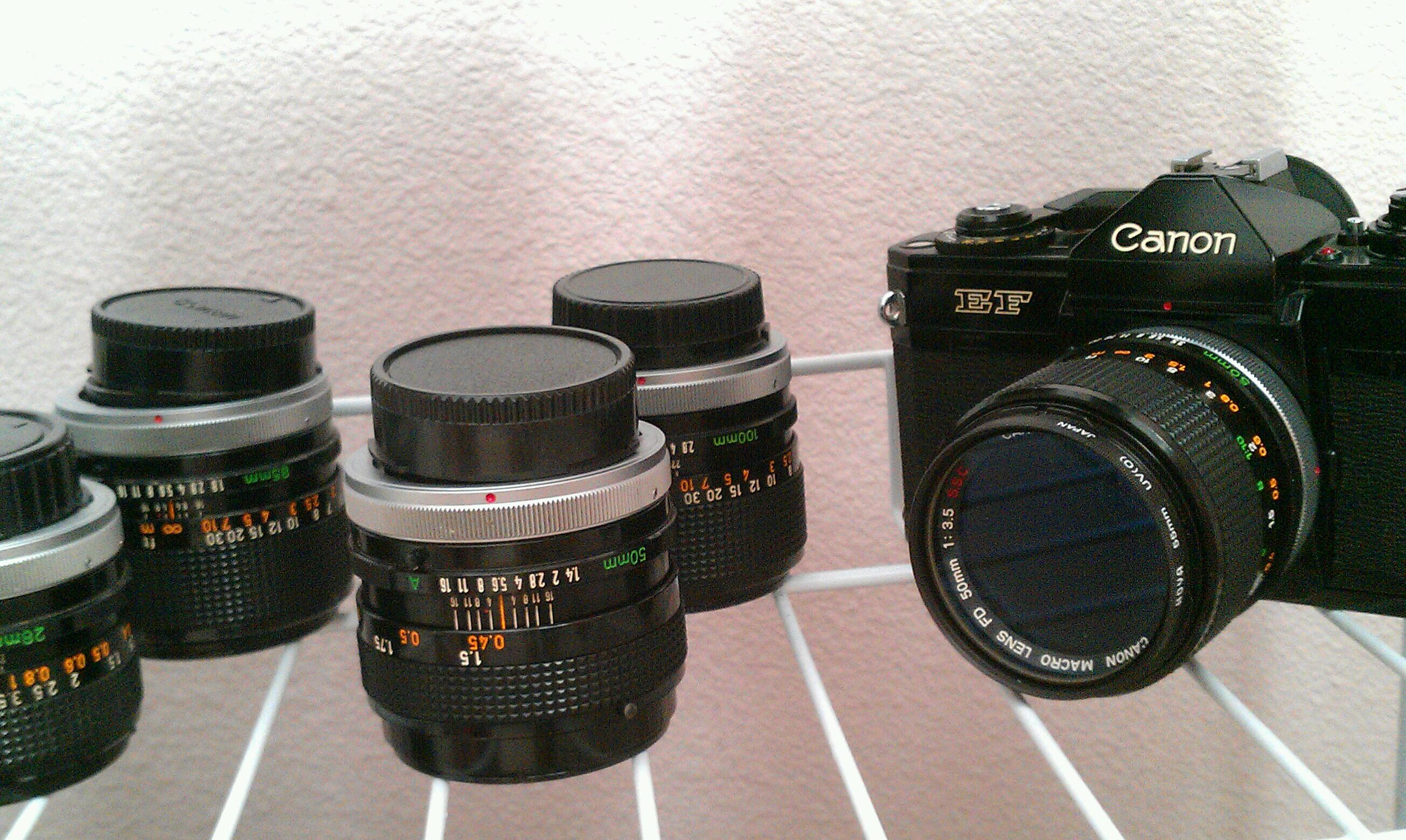

Are you sure it isn't for the Canon EF camera, not to be confused with the EF mount? If so, it will allow shutter priority AE with FD-mount lenses on an EF.
The Canon EF allows shutter priority with FD lenses already, no special adaptor required.
For example...
