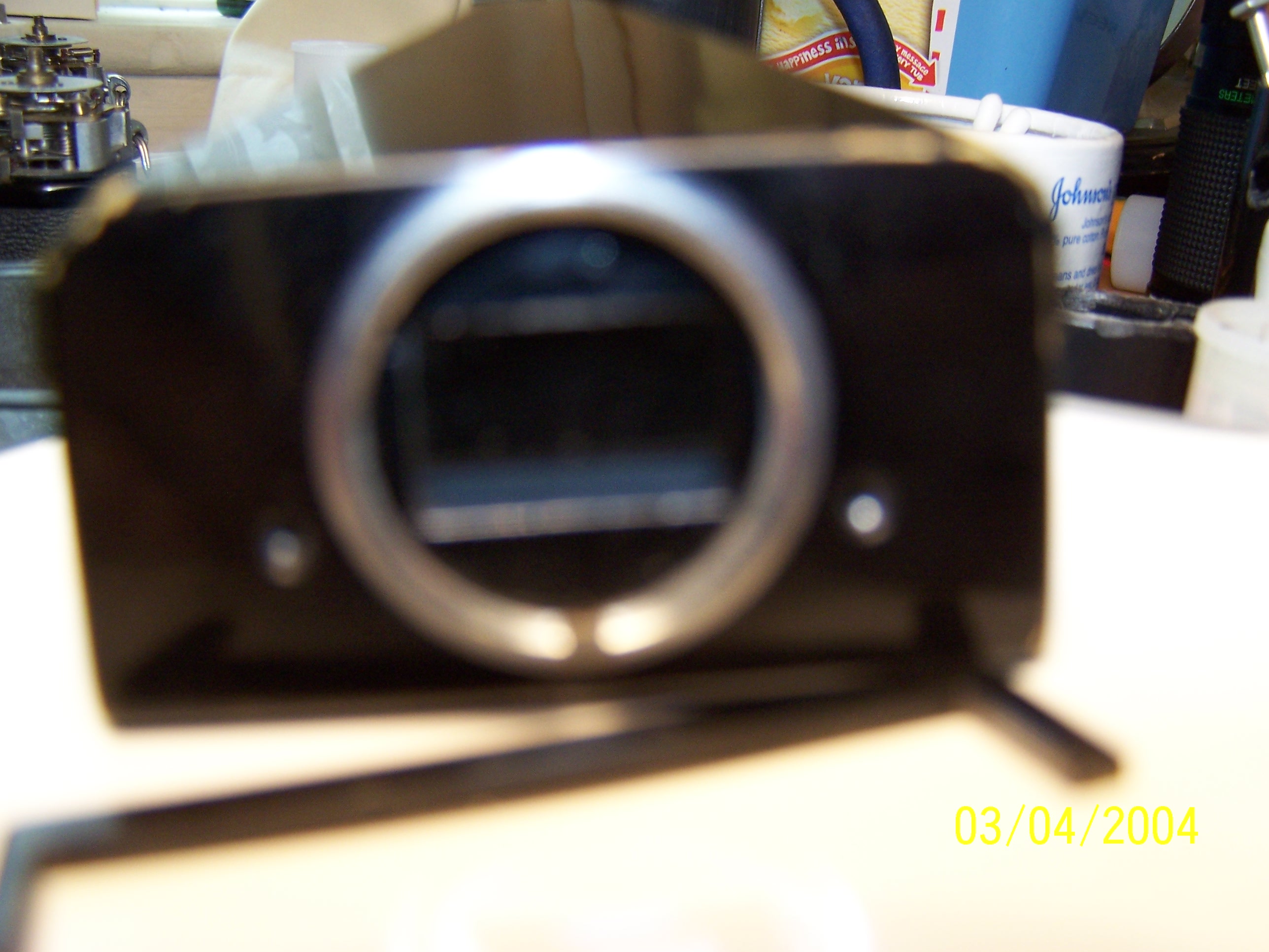

I recently purchased a Canon F1n fitted with a standard finder pentaprism .One of the release buttons has been pushed into the body and the glass window for the meter is broken .Can anyone tell me how to open the prism/ viewfinder body .I have removed the 4 screws and the glued plate but it still seems to be solid . I have looked in the repair manual but i think that that is a slightly different finder

The eye piece just has one screw ether side of it . Dose the round silver eyepiece unscrew i cannot see any way to release it
101_0598.JPG My one is different to the one in the F1n manual theres 2 screws on the front and that's it .Nothing is removable in the silver part of the viewfinder it is just brass sheet the same as the rest of viewfinder
Inside the finder, through the chrome eyepiece there is a black mask. Carefully remove that mask to reveal the last screws to remove.
You are all correct the screws were under the eye piece mask .I just never thought Canon would cover them in metal .Thanks everyone
