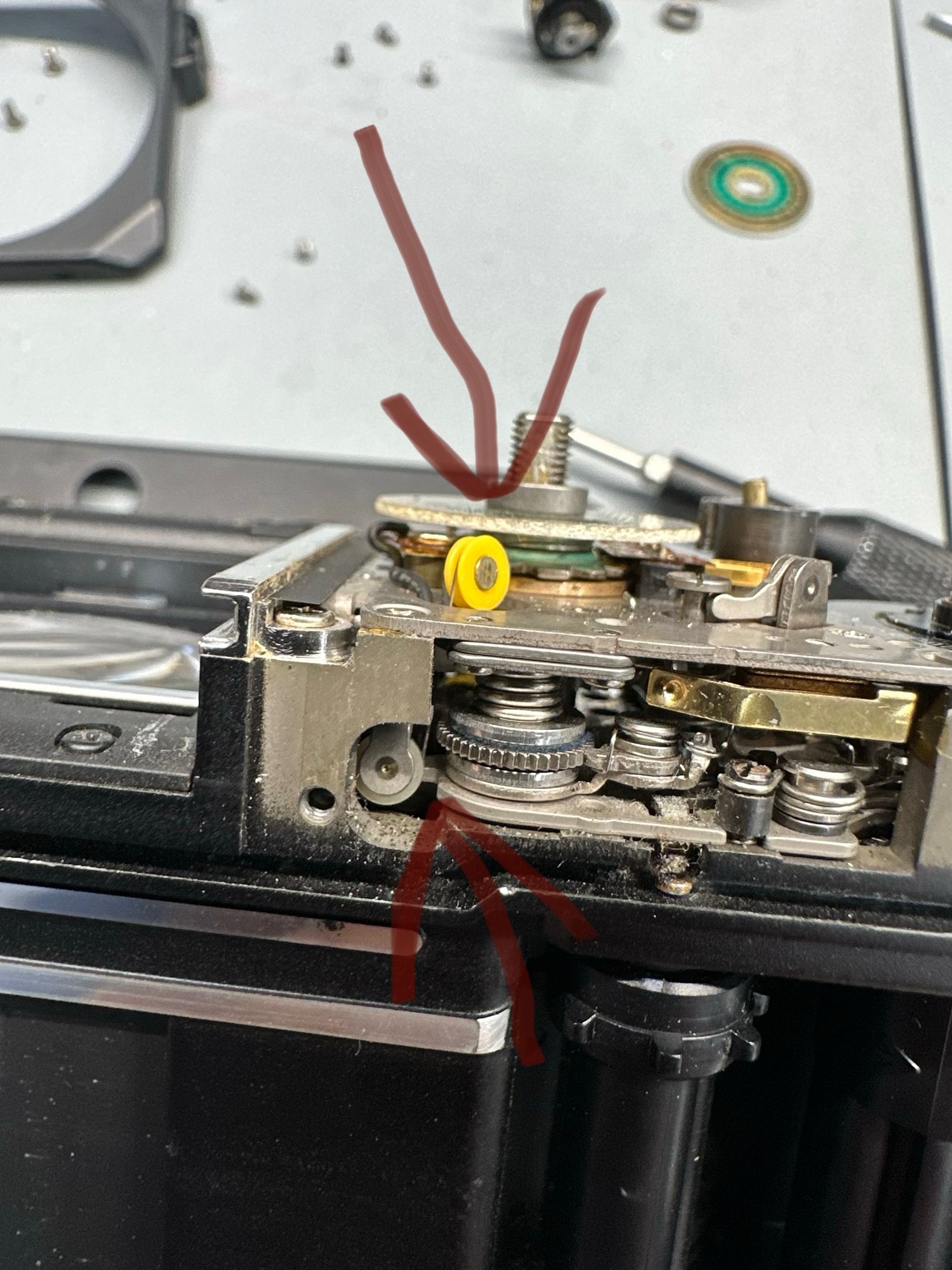

OK, finally had a chance to use my F-1N today only to discover that with the AE Finder there is a problem showing the proper shutter speed. On the dial on top of the camera set to 2000, in the finder it's 125. If I move the dial to 1000, the finder shows 60. And so on. Any idea what might cause this? @benjiboy
Unfortunately as a victim of the same problem, I know exactly what the cause of this is and it may be bad news.
There is a tiny tungsten wire that runs deep inside the camera from the shutter speed dial under the prism to near the expsoure comp dial and it can be a horrific pain in the ass if it breaks. Mine luckily only came off of the little pulleys near the shutter speed dial so it didn't require as much disassembly, but if it breaks somewhere deep inside you're talking about essentially disassembling the whole camera :sad:

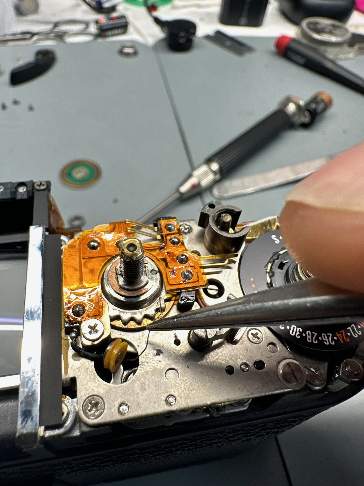

Here is what it should look like. The arrows are pointing toward the little pulleys with the wire in place:
Here is what the little wire looks like up close as well when it comes off of the pulley:
The only way to know for sure is doing a partial disassembly (which is a great time to do a CLA if you're in need of one!) and seeing if the wire is totally broken or just off the tracks. It cost me about $200 for a local repair guy to fix and it works beautifully now, but takes a lot of labor just to even diagnose and do the "quick" fix of just reattaching the wire if it comes off. Would have been way more I'm sure if the wire had totally broken somewhere inside. Some repair shops didn't even want to touch it and said I was screwed because it is such a pain and the chances it totally breaks is fairly high.
Ugh, this looks unpleasant but thanks for taking the trouble to post. So, this is an issue with the body, not the AE Finder? Exposure seems to be fine so it may just be an annoyance. I probably won't go to the trouble of taking the camera apart.
Yeah, it's an issue in the body. The finder is just displaying what the dial is set to through a complicated mess of gears and cables but doesn't actually change anything. All of the calculation for exposure is based on what you have the dial and aperture physically set to and is done via the electronics in the body. What you see in the finder is just for your info basically and that shutter speed you see in there is simply another geared dial on the opposite side of the body (think like an old school odometer) that rotates when you change the shutter speed and is displayed and magnified in the VF.
This is my super simplified layman's explanation so if I need corrected, anyone can definitely jump in.
