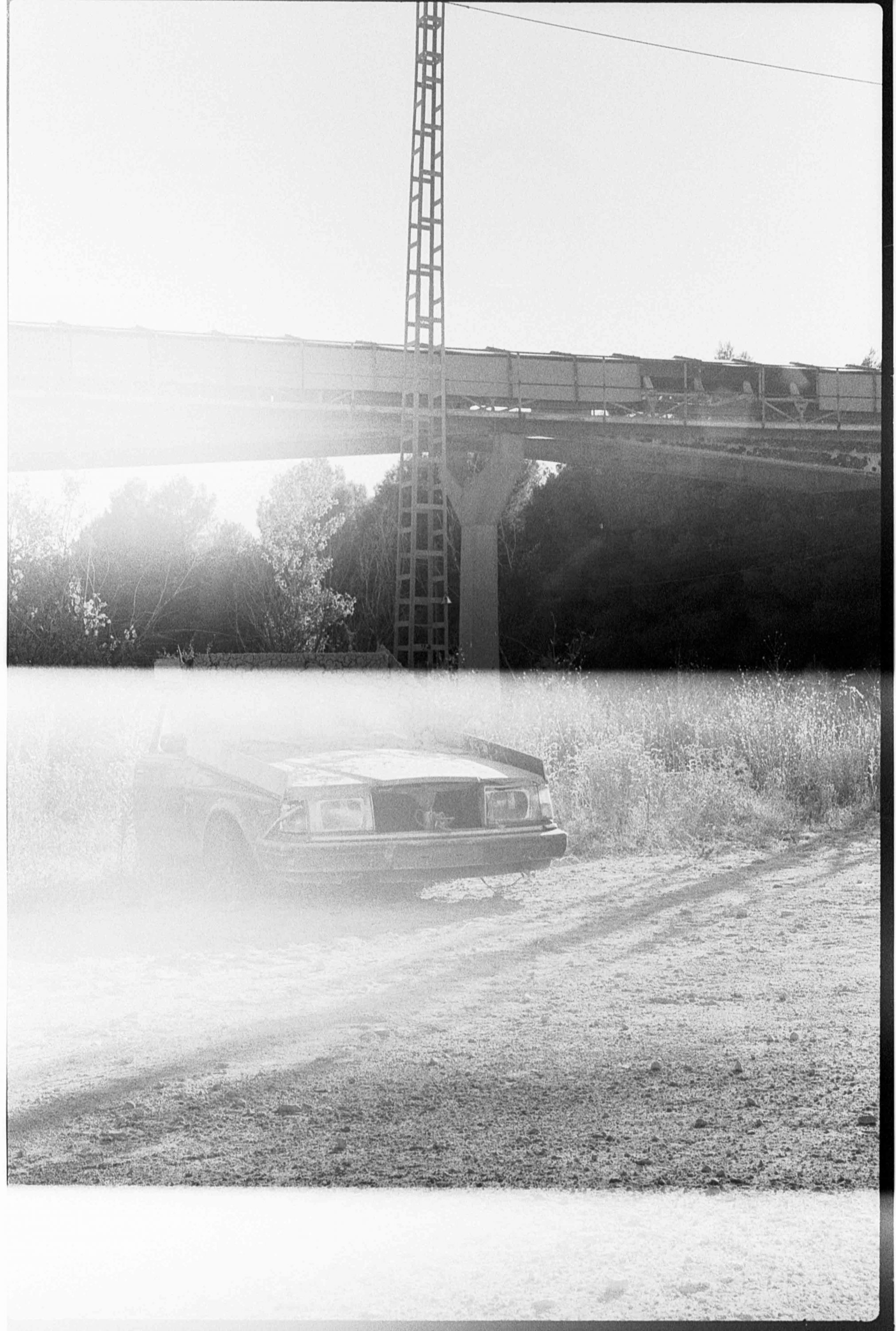

My Canon F1 new has started to show some issues when shooting at certain shutter speeds (Image attached). I have been reaching out and it seems that the shutter tension looses along the years. I am wondering if you could help me to find the way to fix it by myself.
Thank you guys!!

That's not shutter tension problems. It needs to be disassembled and completely cleaned and relubricated. This is NOT a job for an untrained person. If you increase spring tension, you'll destroy the shutter.

I am interested on knowing the reason why you determine it is a lubrication and cleaning issue. Is it usual to get this results at different shutter speeds?? If that was the case, shouldn´t the result be similar in all shutter speeds? Do you know some technicians to approach it here in Europe? As far as I know, this camera is one of the most complex ones of its decade and because of that , mantainance and repair usually costs almost the same as buying a new one nowdays. What do you think about that?

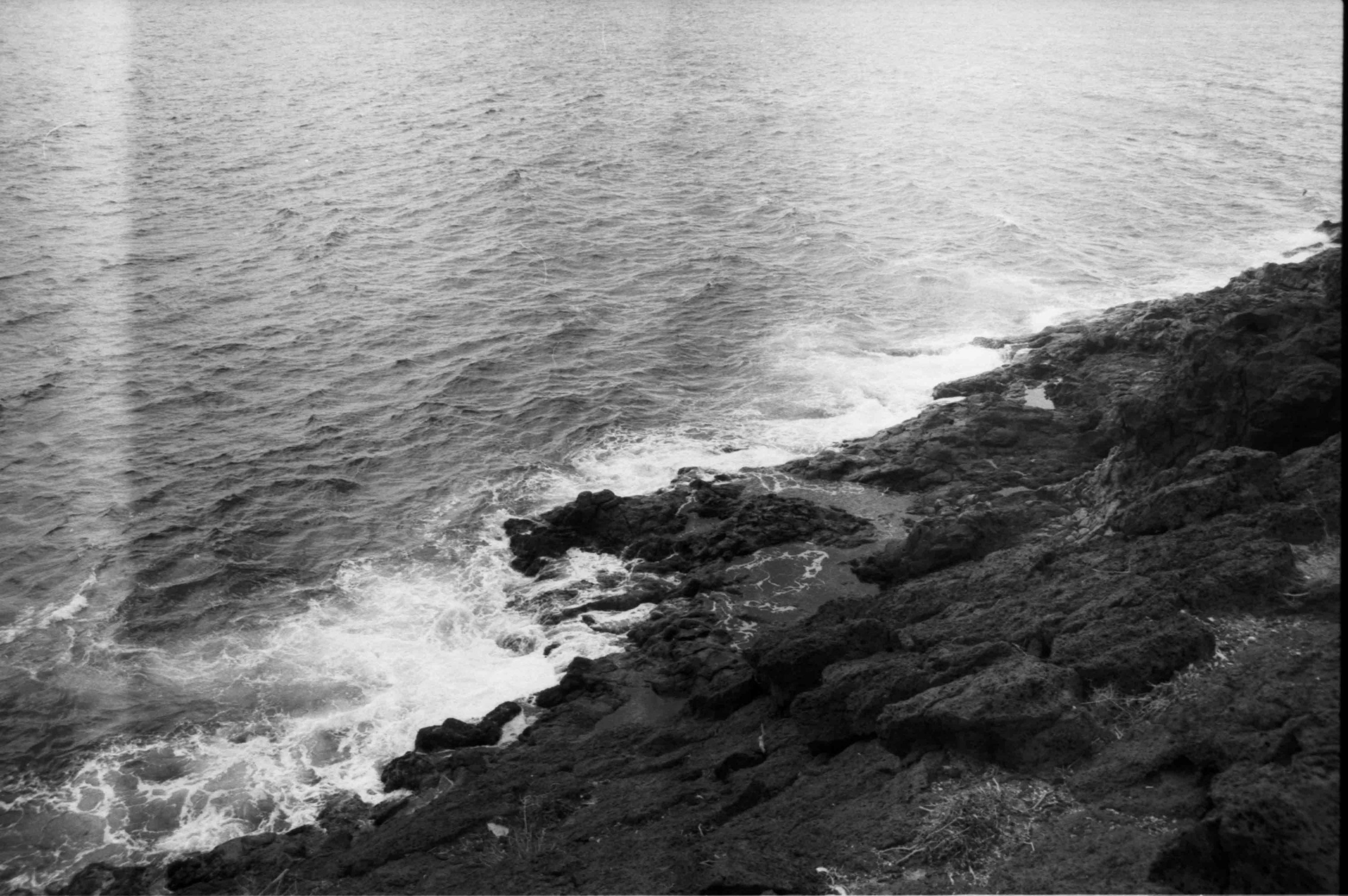

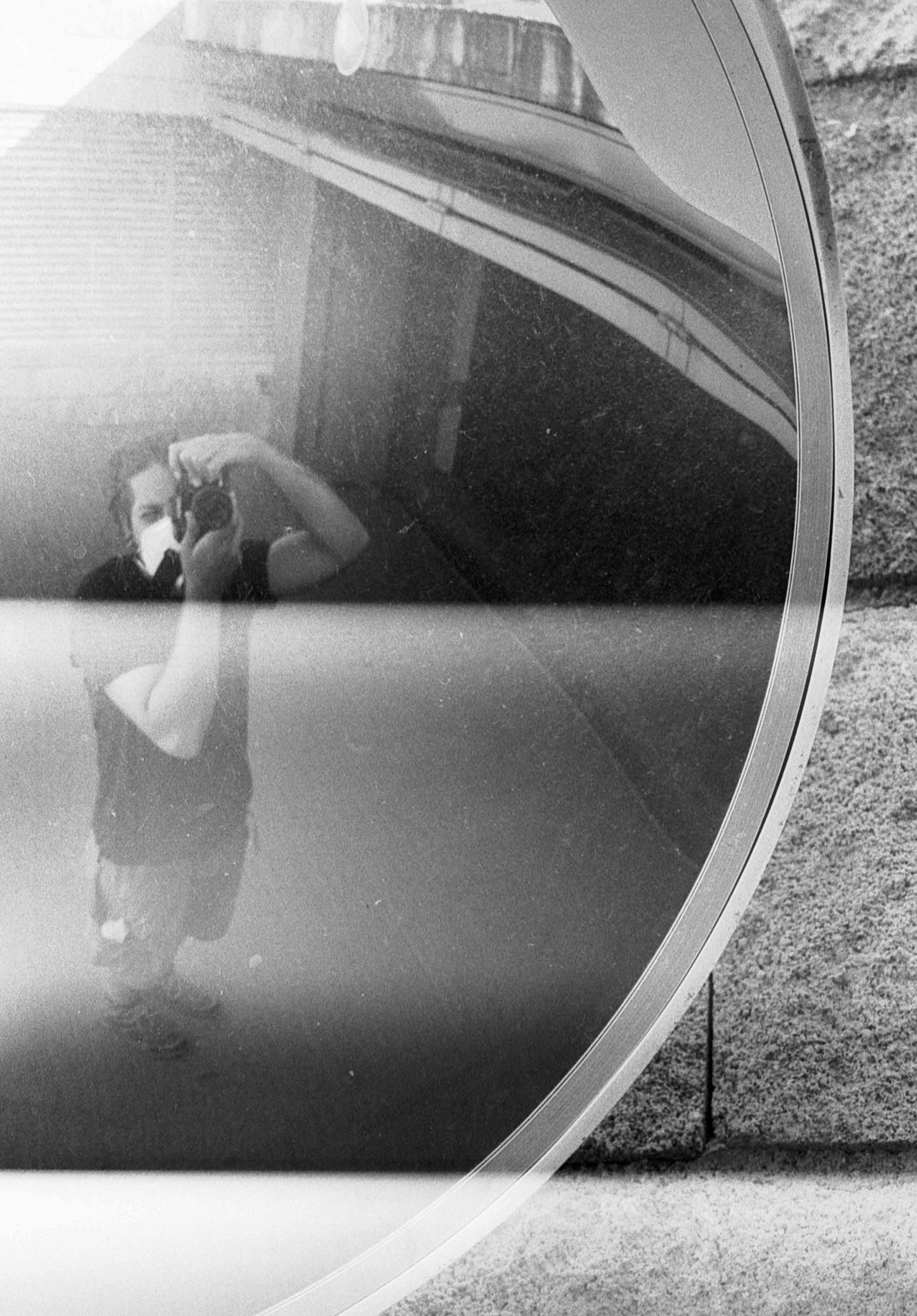

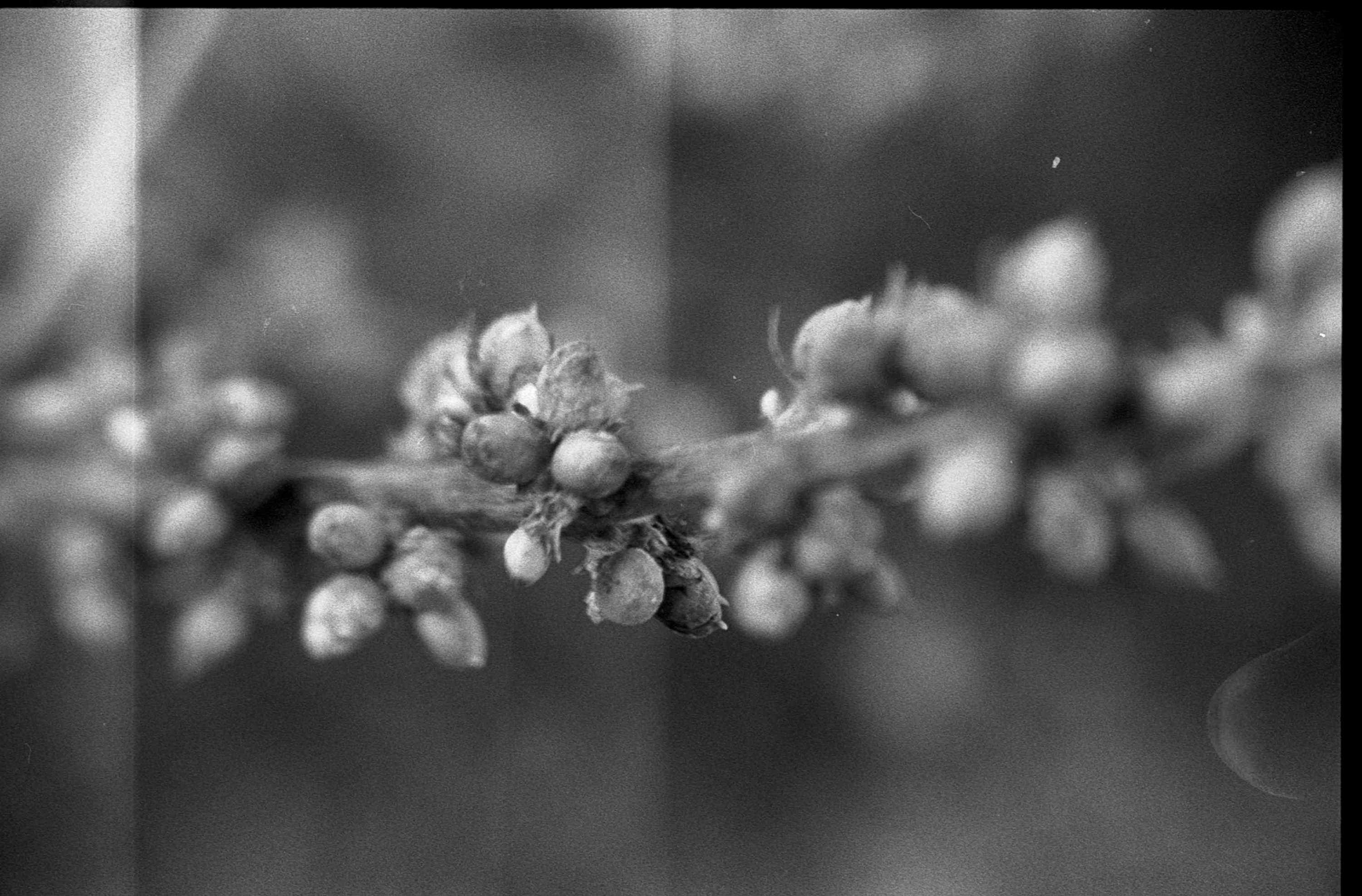

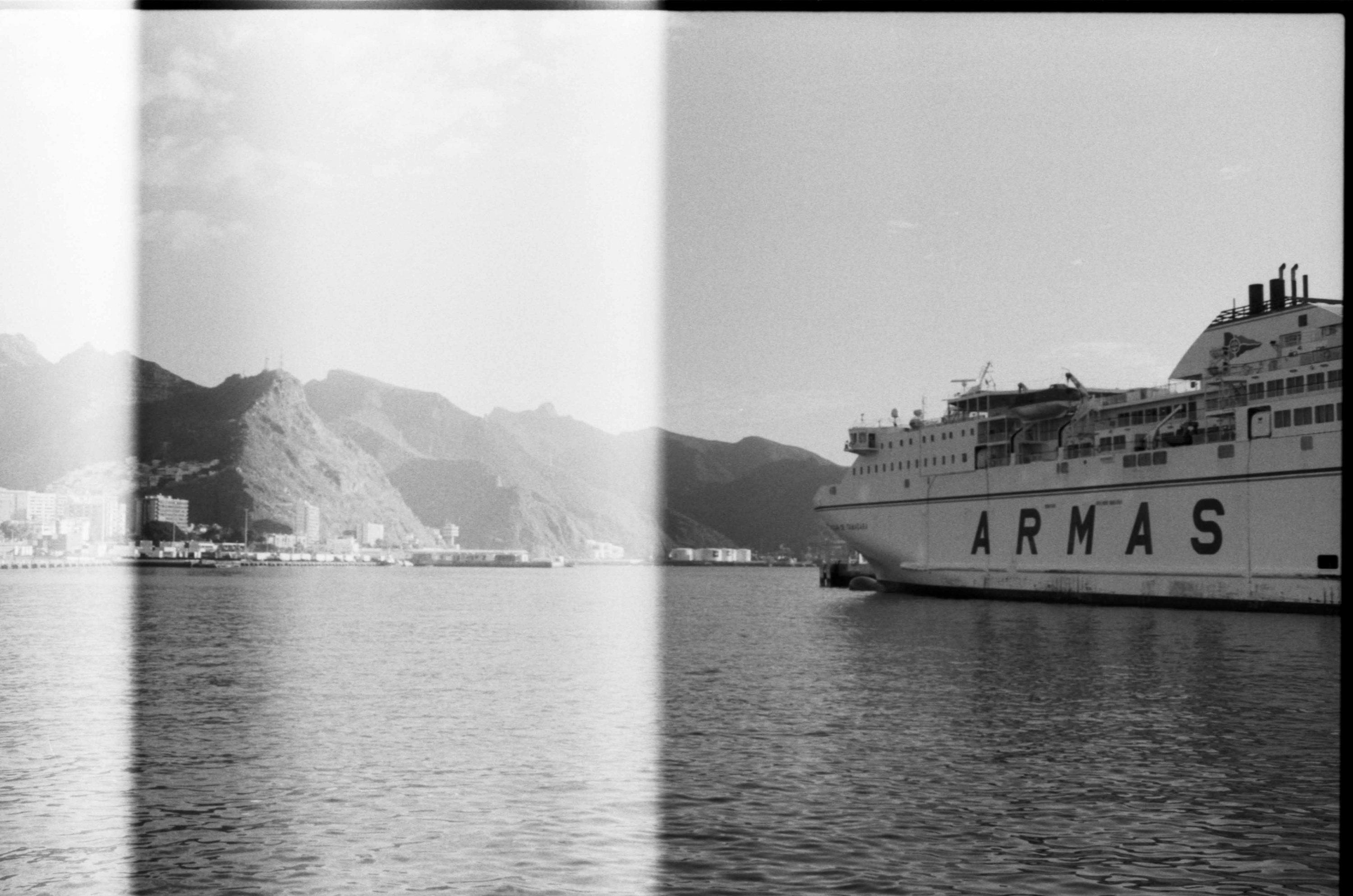

Without you showing more negatives the problem can't be diagnosed. It looks like shutter bounce, which won't be solved by adjusting curtain tension btw...

I leave some more images.
Thank you all guys!
