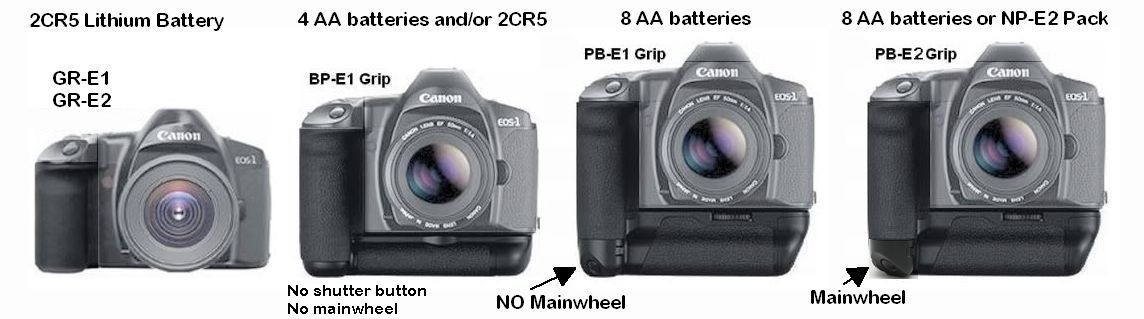

One nice thing about the EOS 3 is that it shares all the same battery grips as the EOS 1 series. Lots of battery options, and also size and weight options.
Thanks. I wasn't aware they share battery grips. So they must be pretty comparable in body size.

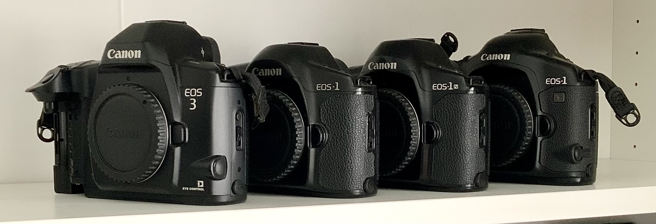

The EOS 3 is a very large camera. It is actually larger than the EOS 1 and EOS 1n, and nearly identical in size to the EOS 1v. The EOS 3 uses more plastic construction, and is lighter than the 1 Series.

Really, the 'best' (and that term is very subjective!) of Canon's analogue EOS cameras is not the 3 or the amateur bodies, but the 1, 1N, 1V, 1VHS, etc. You'll note these 'big guns' didn't have, nor would they have benefited from, eye control focus.

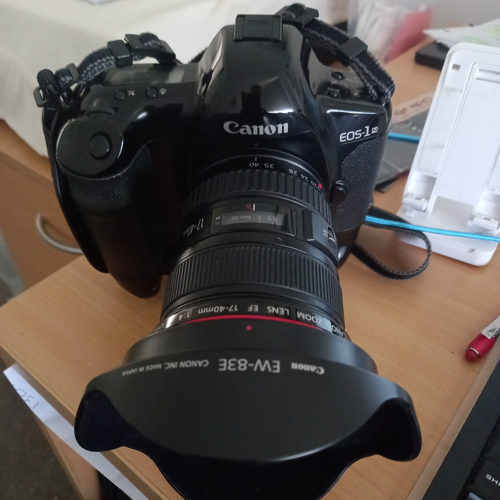

I owned a 1V for ~4 years before paring back my system (for simplicity) and keeping the 1N (which I still have, originally purchased in 1994). EOS 3 and its much-vaunted eye control (which Canon improved considerably with both landscape and portrait orientation over the 5's epoch-making, but blighted feature in this regard) didn't hold a great deal of appeal in the market — nowhere near as long as the preceding EOS 5 / A2 / A2E / 50E (the 50E also claimed brownie points for eye control in V/H format) and certainly nowhere near as long as the 1N — mine has passed its 30th anniversary and still chopping along! 😀
