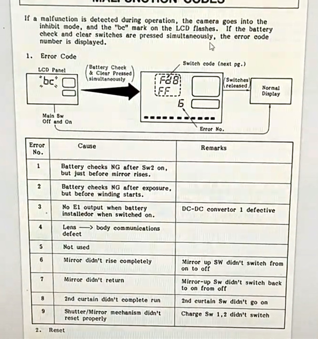

Hi, everyone. I recently bought a Canon EOS 3 with this BC problem. When I fire it the mirror goes and stuck halfway and the BC message appears. When I fire it again it release the mirror.
I already cleaned up the contacts and hit the mirror's magnet region.
Any ideas?

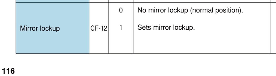

That sounded like the shutter fired when the mirror went down. I would check the Custom Functions to make sure Mirror Lockup is off. But even if it is enabled, there shouldn’t be a BC error.
