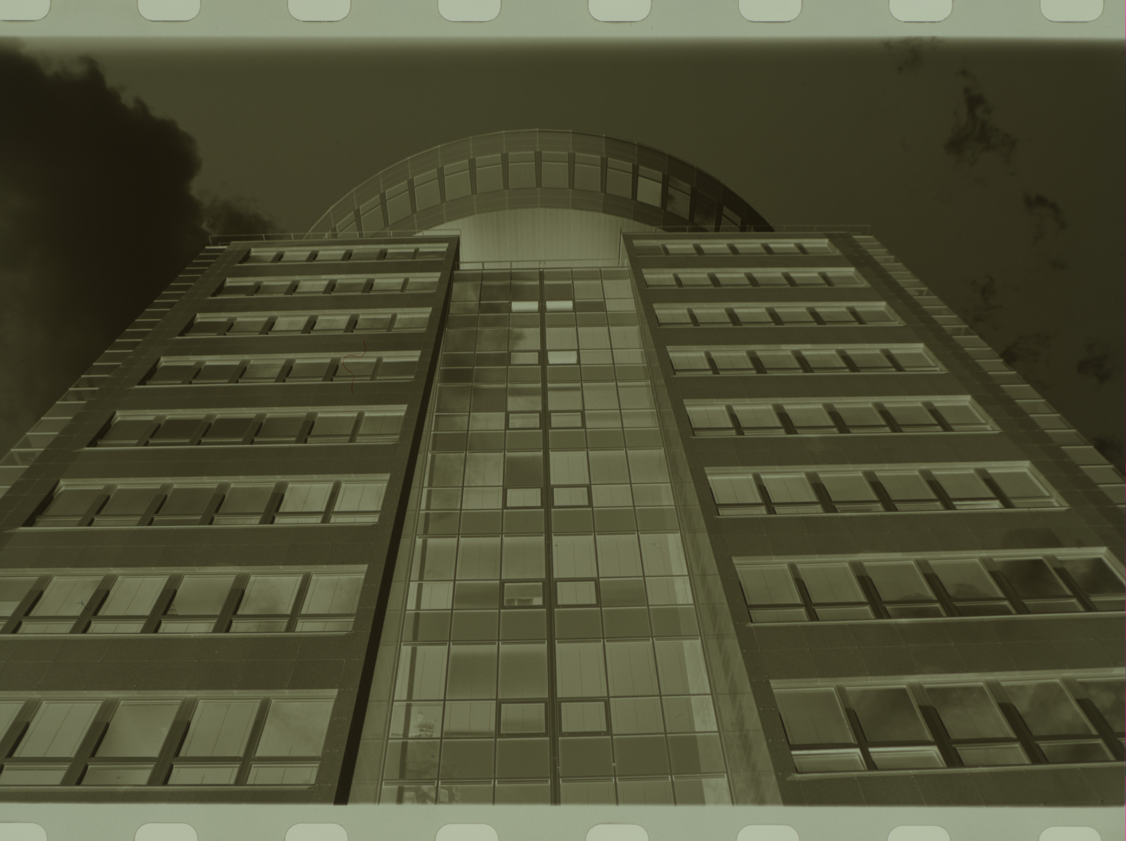

i bought a canon eos 1 today, and i was really excited to develop the film i shot with it however to my sadness i saw that many of the images have been completely skipped while two have been only incredibly lightly exposed, since the side marks appear completely normally I could only conclude that its the cameras fault and the main culprit seems to be it thinking that its back is open and thus shooting at 1/8000th, is they any precautions i could take to prevent this

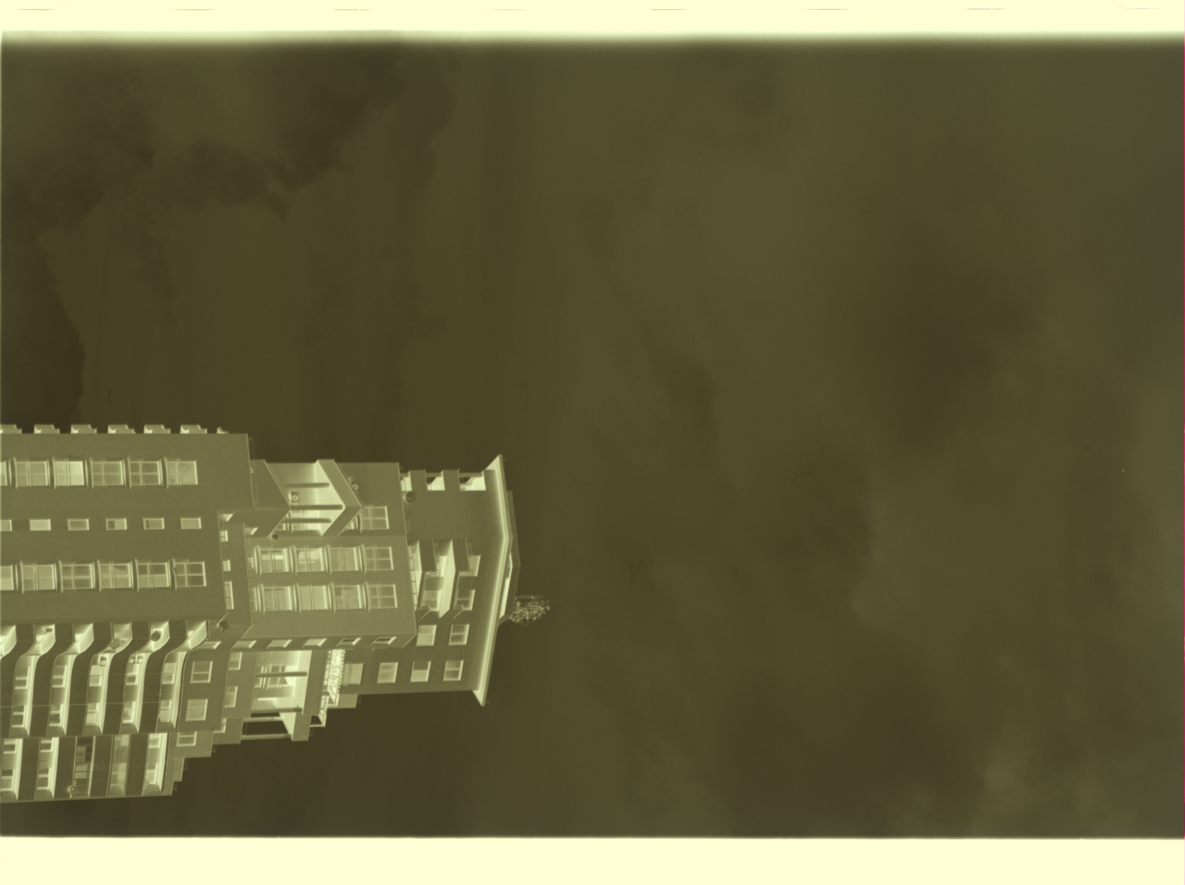

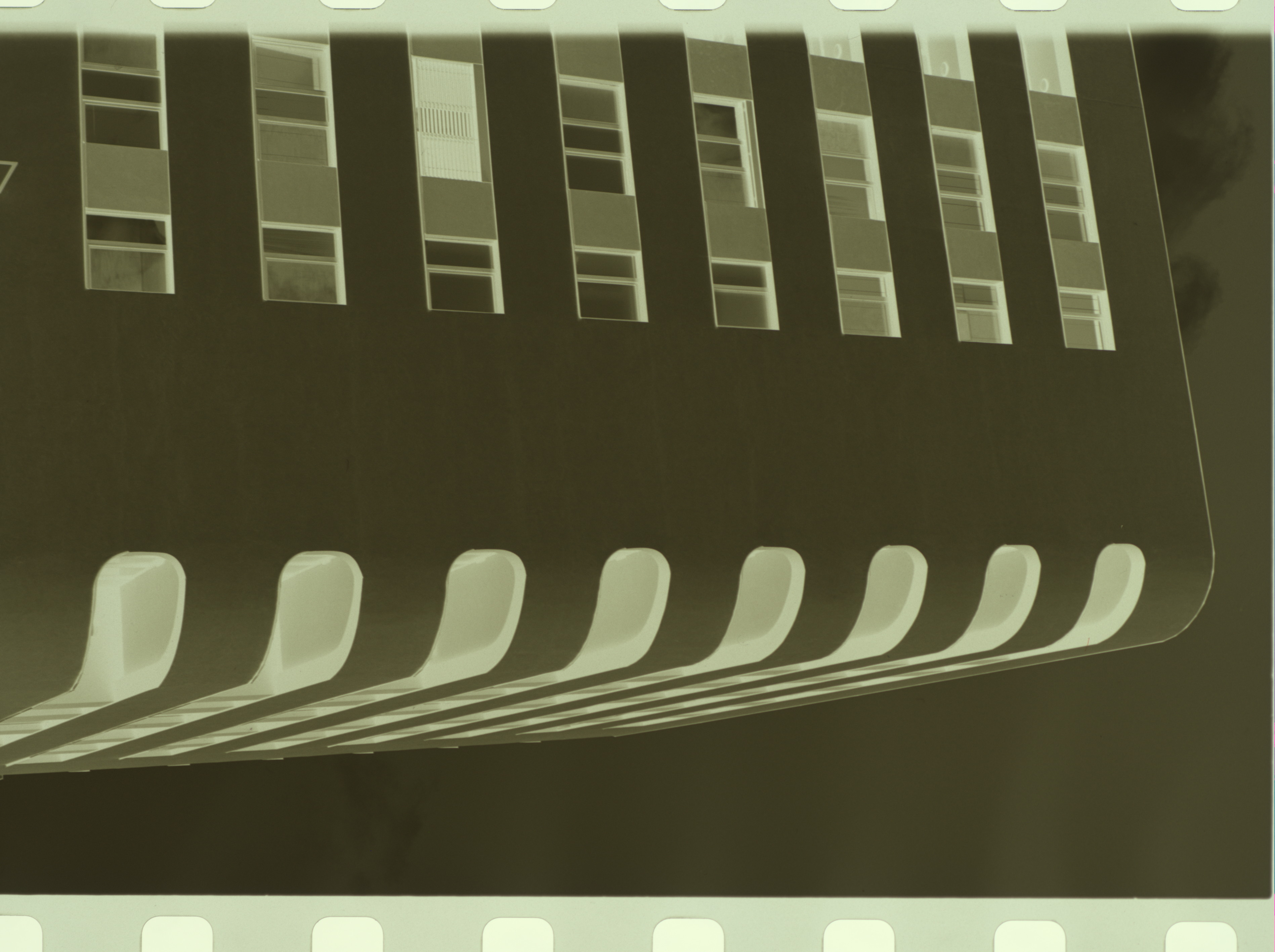

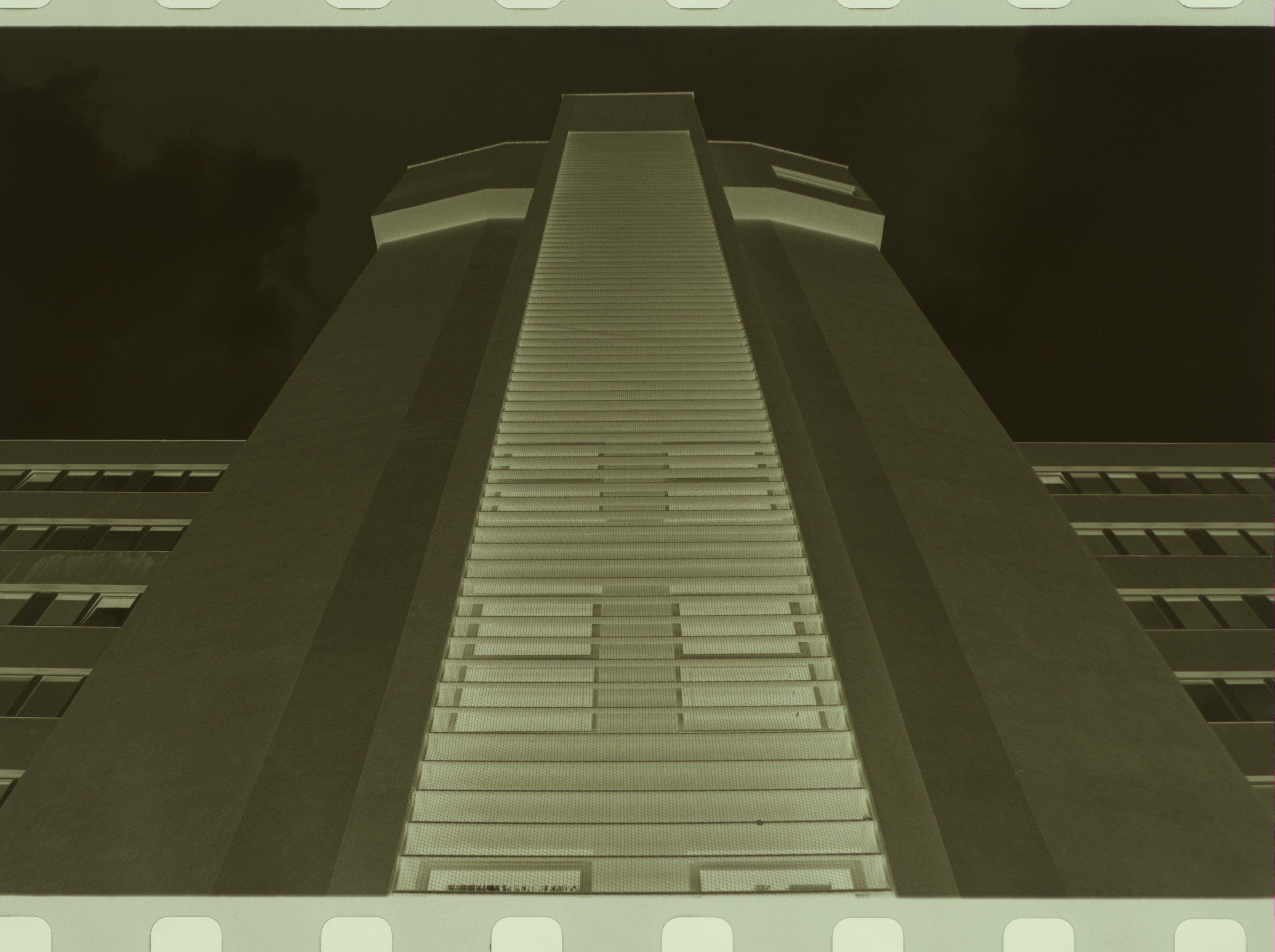

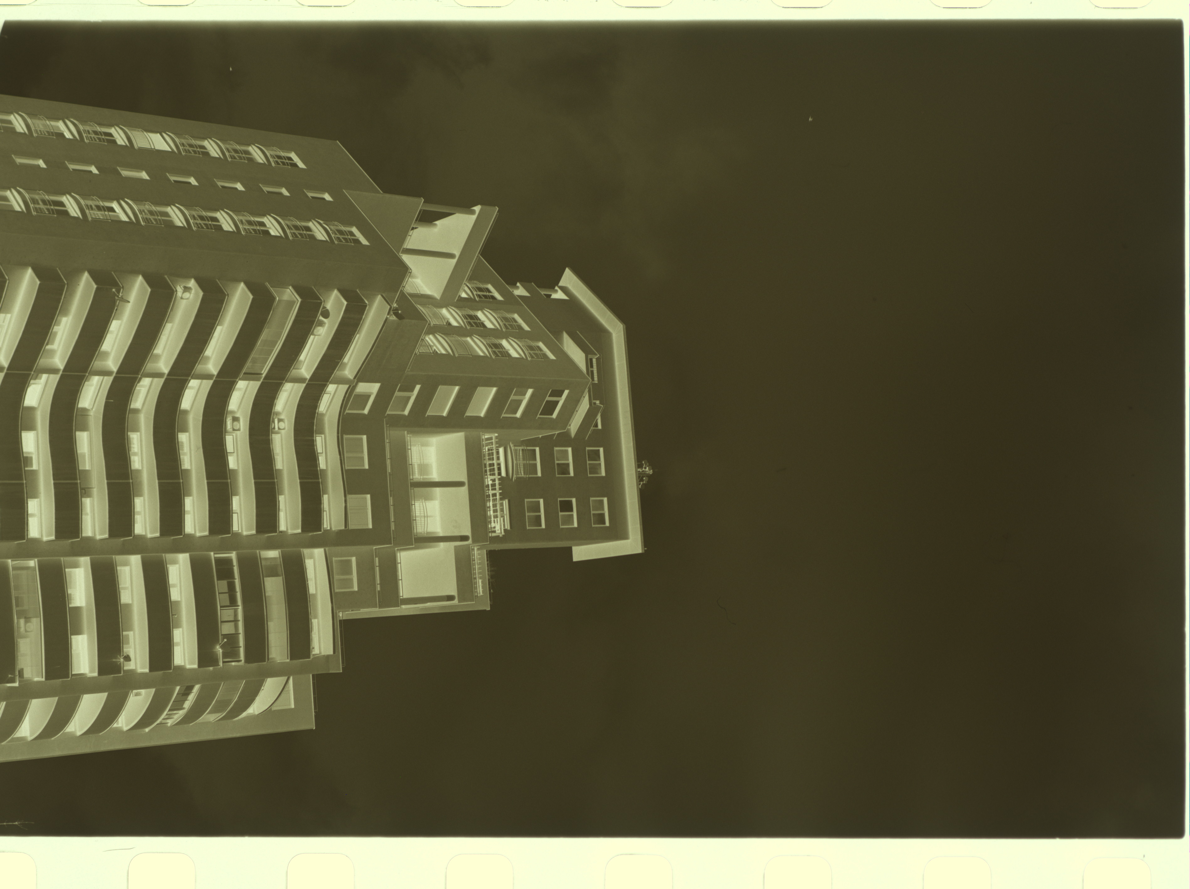

yeah i remember taking pictures that would have appeared in the blank spaces here are the unaltered negatives

Thanks for the quick follow-up. There's an interesting phenomenon along the top edge of some of the negatives you posted where something has evidently partly blocked the image; note the gradient:
The frame edge should be the same along all edges.
I suspect this is a problem with the mirror system as I proposed earlier, and that it manifests itself intermittently. My first guess would be sticky parts of foam that sometimes prevent the mirror from doing its full cycle.
Shutter capping is also conceivable, but most of the time I say it, it's not specifically limited to the edge of the frame.
If you open up the camera back and look at the shutter blades, is there any shiny black goo anywhere?

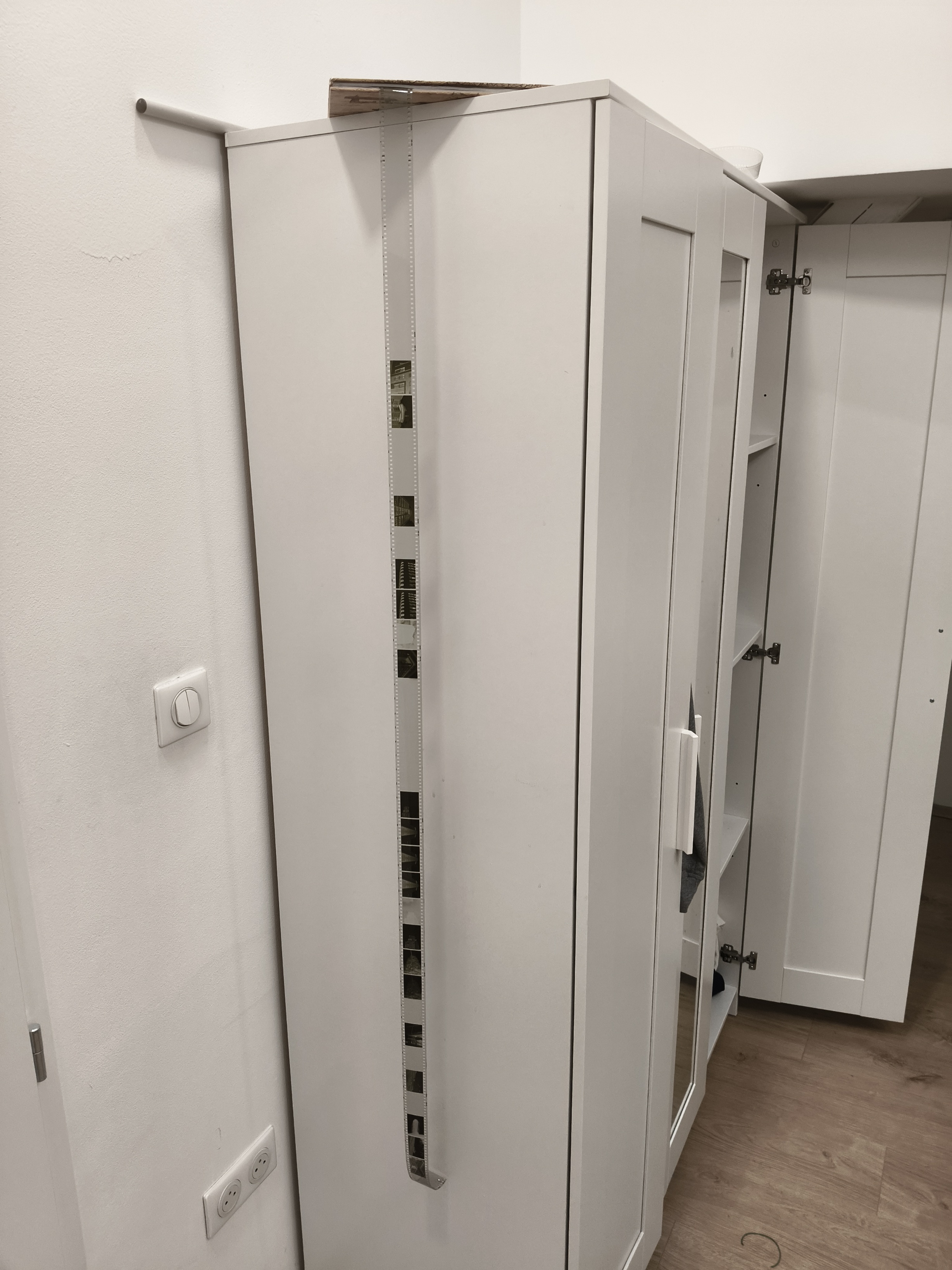

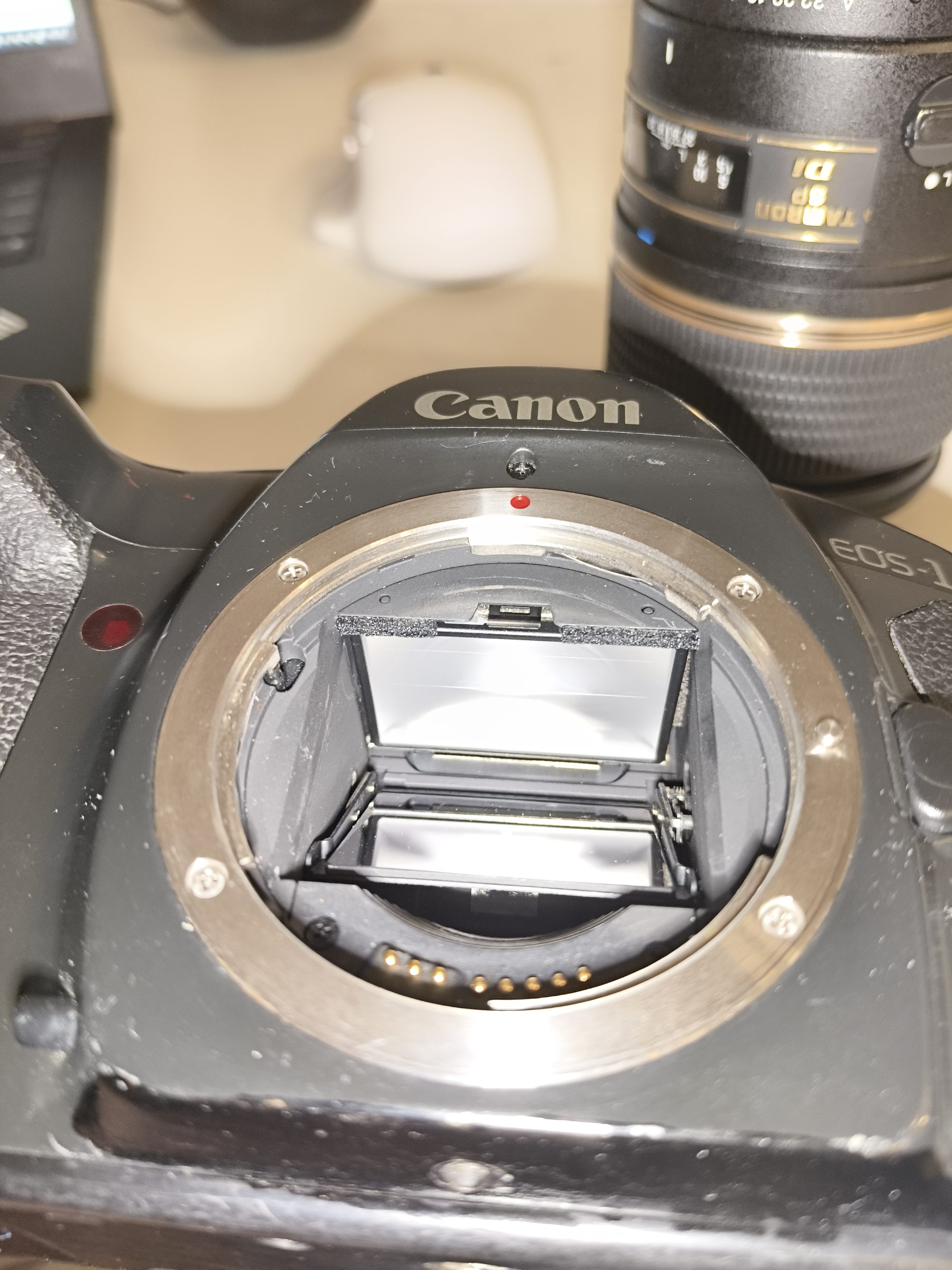

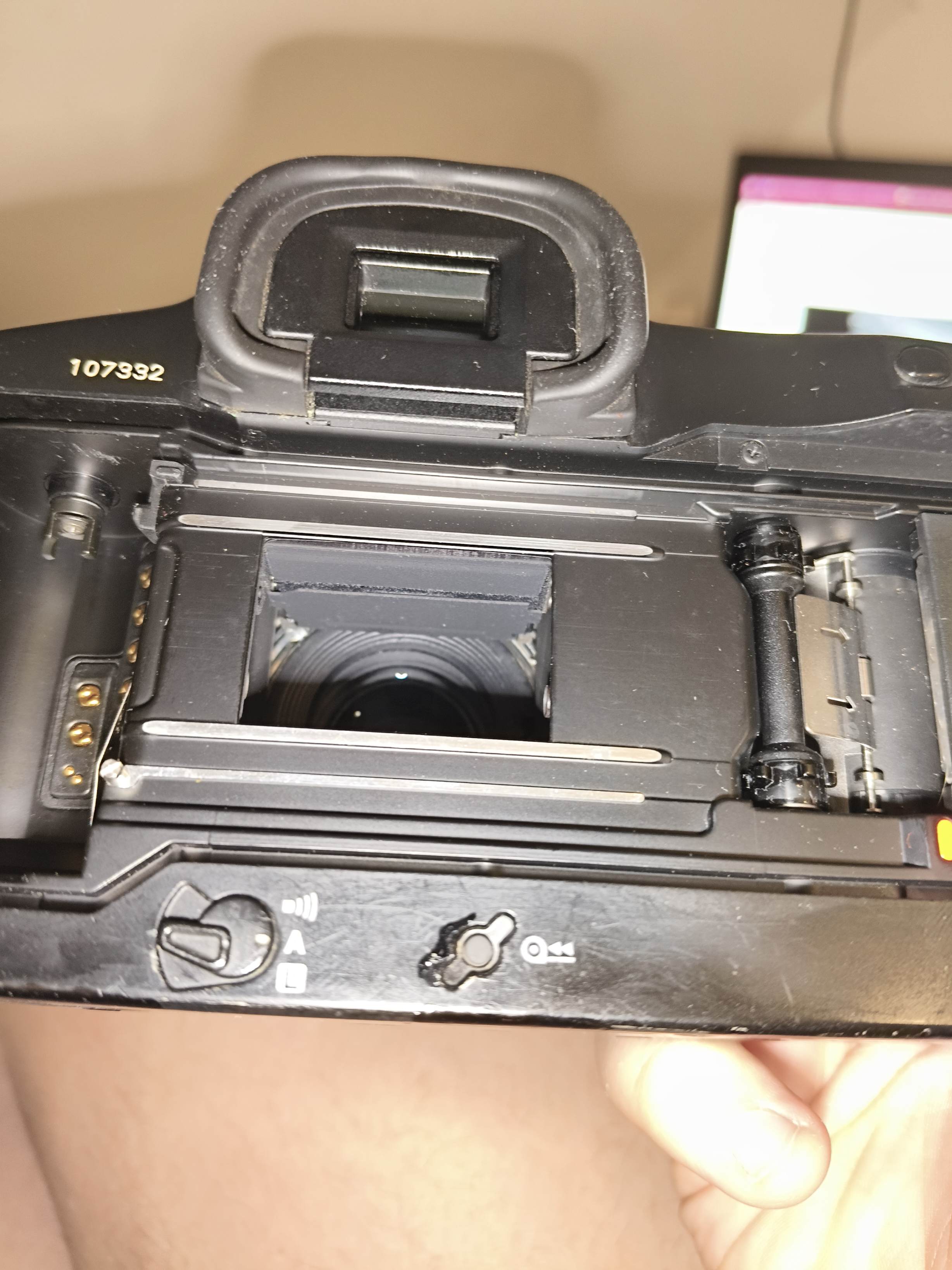

no there isnt any, this is how it looks like while exposing and, the state of the mirror ligth seals which are also not sticky, this is also my 3rd canon film camera that I've used but my first expensive one, and i never had anything similar happen on the others
Thanks; I see no major/obvious problems, but that doesn't mean there aren't any. And in fact, given the problems on your test roll, there's evidently a problem with either the shutter or the mirror. You could try doing some test exposures with the lens removed and the back open and observing the mirror and the shutter to check for any inconsistencies. If you do enough exposures, you may be spot an irregularity at some point. For the mirror you could do some slow (1-2 seconds or bulb) exposures and see if the mirror flips up entirely and to the exact same spot 100% of the time. Note that you may be looking for only a minor misalignment. If you're 'lucky' you may see it lag or even not flip up at all once in a while. If it's the shutter, try doing short exposures (1/4000 or so) with the camera pointed at a light source while looking through the back of the camera; again if you're lucky you may be able to see some variation in the light intensity or even dropped frames every so often. This should help you determine at least whether it's the shutter or the mirror.
