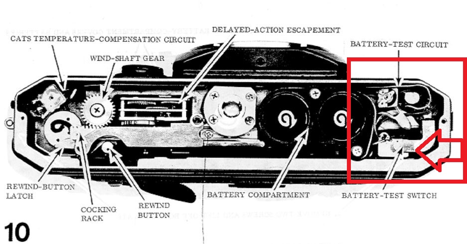

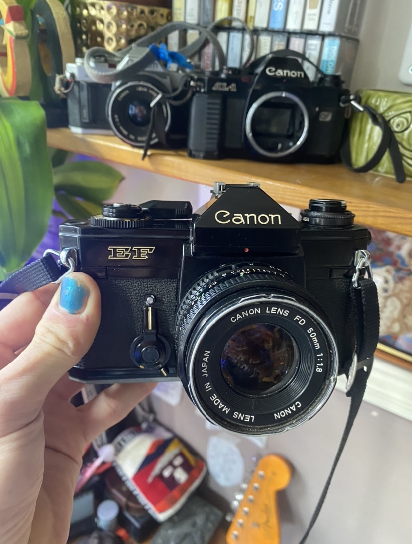

Hello folks! I come to you with an issue with a Canon EF body. Everything seems to work correctly, except for the battery check light is constantly on, even when the power switch is turned to off. I've cleaned the battery terminals of any corrosion, and also given the battery-test circuit a bit of a cleaning too but nothing seems to be solving the issue. Has anyone else had the same problem? I found a wonderful service manual, but honestly I'm not sure what part of the circuit is acting up. Any help would be much appreciated. Cheers then! -Jonathan

I haven't worked on one of these cameras before, but after glancing at the repair manual and seeing the battery check button is on the bottom plate, I would remove the bottom plate and check for corrosion or loose parts bridging the contacts.
Thank you Kino! I have already looked around that area and have failed to find any bridged contacts yet. I’ve also checked the top side of the camera around the LED to see if there’s anything making contact that shouldn’t, but no luck so far.
According to the repair manual, the LED is supposed to flash during slow exposures and when you push the battery check button.
Maybe this indicates something much deeper in the camera body itself. Sorry, out of quick-fix ideas; best to check with a camera repair technician.
