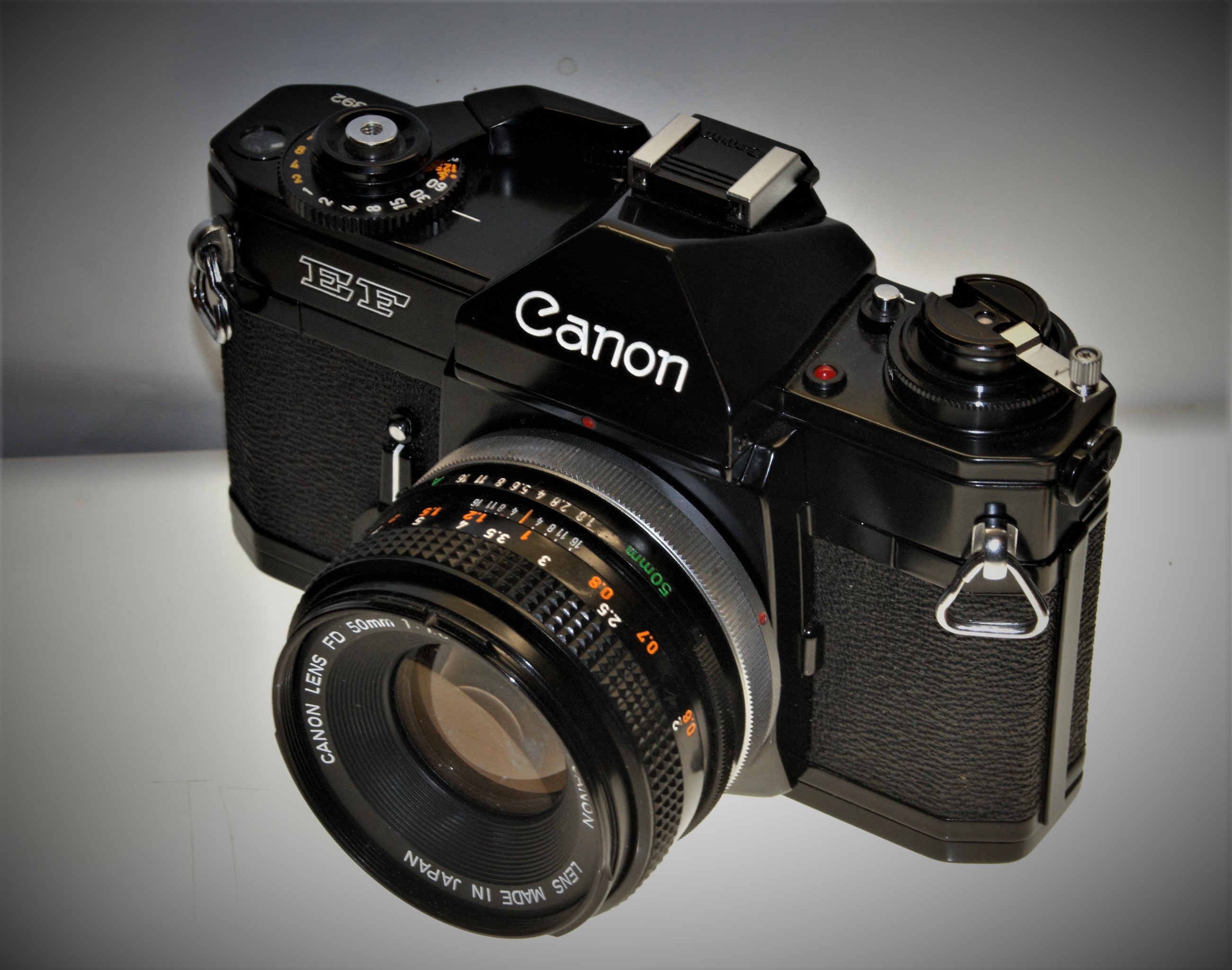

Broken ones are going for £55 on the net and are selling .I am after a spare as i am hope to swap viewing screens .
The viewing screens aren't user replaceable Colin, but there were two versions of the EF and the later one had a split image if it's any help.

Posting here, my EF had very very bad battery life, losing the charge after about 1 month of leaving the camera on the OFF position.
I removed the bottom cover and examined the battery holder.
The battery holder assembly actually is a "sandwich" of two assemblies, the top one is a metal frame where the battery caps screw into; the bottom one is a plastic one with contacts.
This assembly is held by two screws AND... the important part is that there are minute white nylon washers that electrically insulate these two parts. On my EF, a washer was misplaced, so it did not insulate. I corrected this.
Also, the EF service manual out there on the internet has a handwritten recommendation for taping the underside of the battery holder with insulating tape (electrician tape). Yes, the wires on the battery holder sit very very close to the (metal) camera body, so it's a good idea to do this.
I am now in process to evaluate whether there was an improvement (battery was installed 1 week ago). Apparently, I am already feeling an improvement, because the battery checker light is flashing at roughly the same frequency as when the battery was installed, despite leaving the camera in ON for about 8hrs during my trip. Where as before, in a matter of few days the battery checker light's frequency would have diminshed noticeably.
