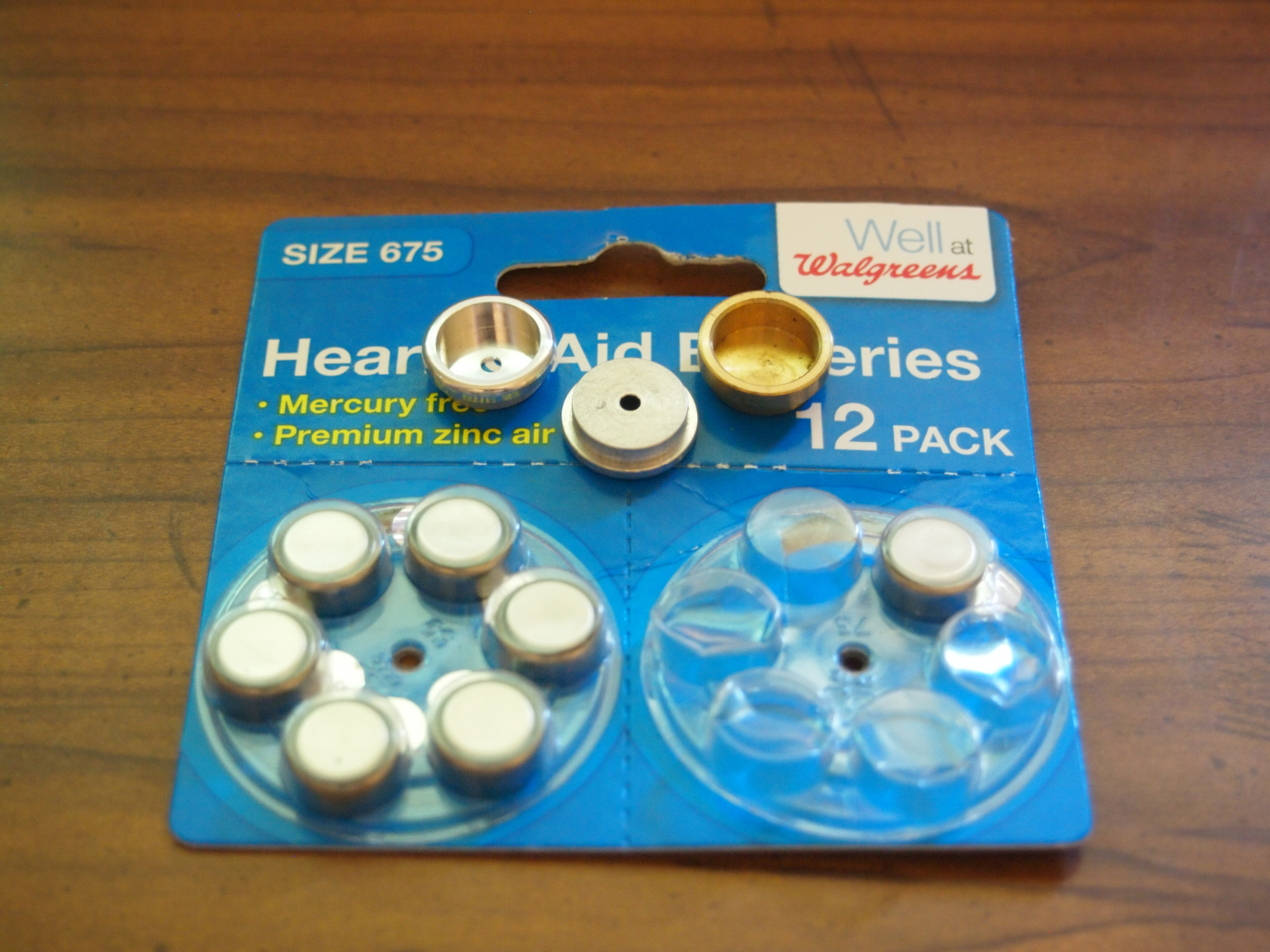

This photo shows 3 of the adapters but for the Canonet GIII you will only need one. Just wanted to show the aluminum and brass as well as the vent hole in the back of the aluminum one. The 675 zinc air batteries can be bought in value packs. the card I have in the photo was from a 24 pack if I remember correctly.
