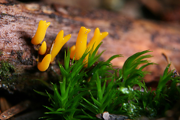

Great looking image, koraks!
When my system works together, I think the results are good.
Absolutely, that looks nice! And thanks; the fungi shoot was from many many moons ago; certainly >15 years. I used to do that a lot for a while. I used a Canon 20d at the time and as said a pair of Canon flash units. I mostly used those in an eTTL setup with a 580EX on the camera and a wireless-controlled 420EX auxiliary unit on a little stand.
