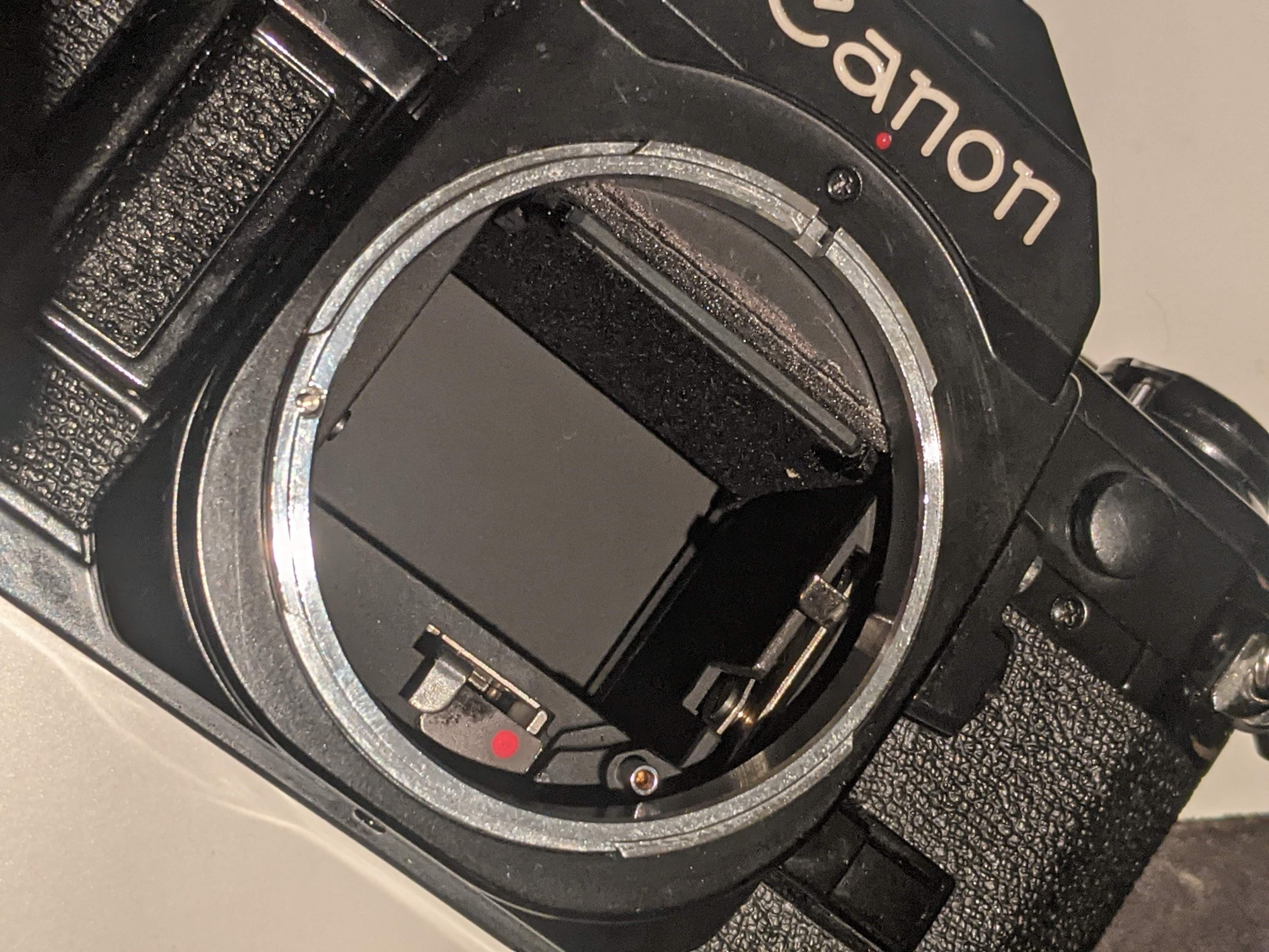

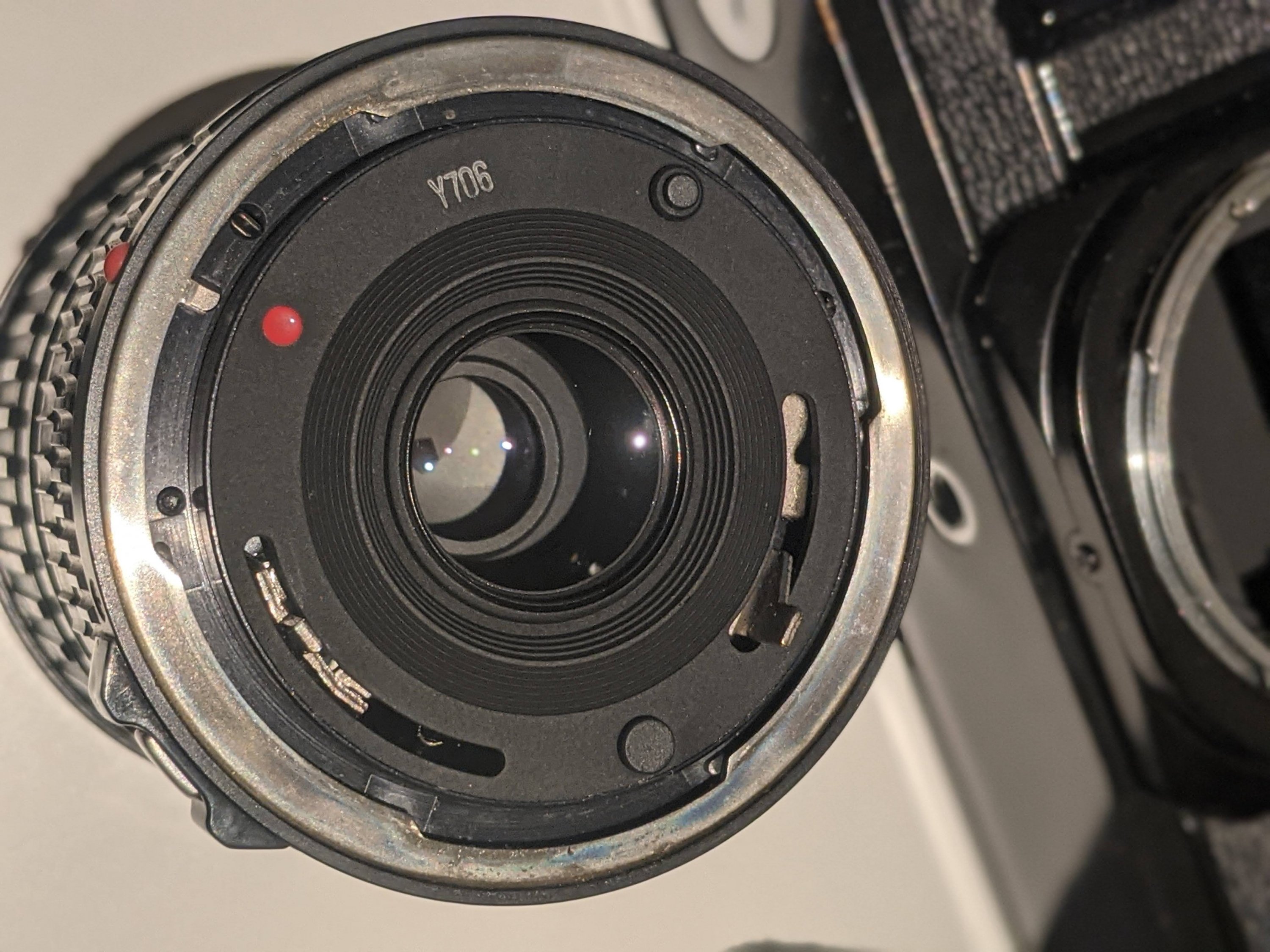

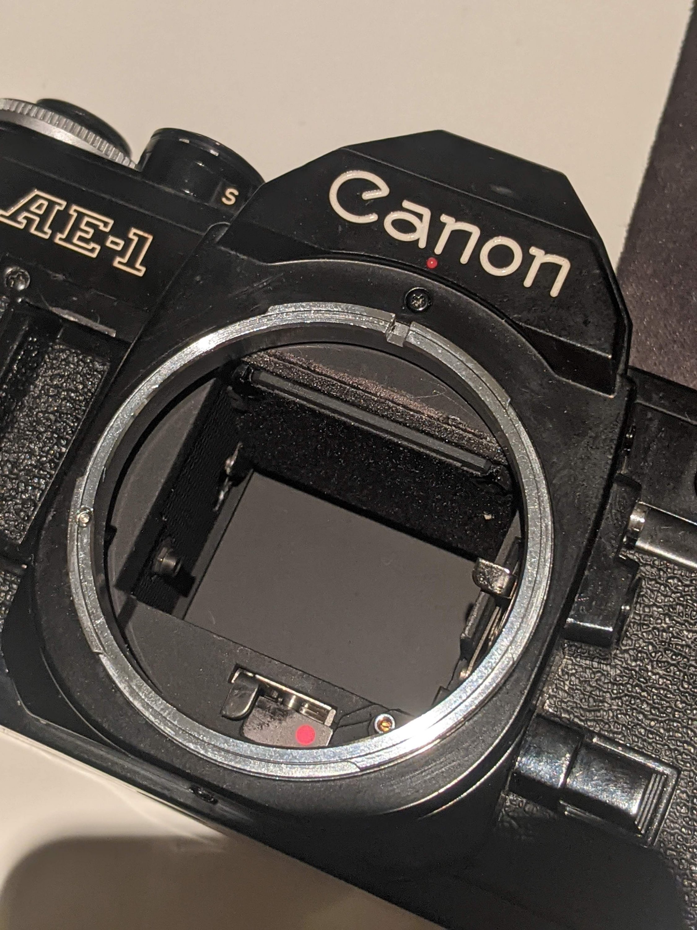

Hey all,
My dad passed his Canon AE-1 onto me with a problem and he's unsure how to fix it. It appears that the mirror is locked up? Batteries are new (we've tested 4 different brands) and we can't wind the film nor press the shutter. We're unsure what the problem could be? The lens is 28-55mm F/3.5 Canon FD.
I've attached the images just in case there's an obvious issue that I'm blind to haha.
Thank you for looking!
Pat

It could be due to sticky mirror foam, or something internal. You may have to take off the bottom plate and look around.

The only thing I see that's iffy in your photos is that the lens stop down mechanism appears to be engaged. The little Rube Goldberg looking tab on the bottom right of the lens opening needs to be disengaged. Not sure if that's the issue, but it shouldn't be that way. There are several people that repair these at reasonable prices, If someone here can point the op to the right camera repair person it would be good. As Ralph said, it's a special camera to you, why not get it working properly?

The camera has been released:mirror up and stop down lever off set to the right.
None of the canon A cameras had mirror lock up feature.
Try opening the back and seeing if the take up sprocket moves in the direction of film travel. It's a guess but easy to try.
The camera had a three part release switch under the shutter button that would tarnish and cause the camera to
not release has nothing to do with what you have.
SLR's operation goes release button, mirror goes up and releases shutter-shutter then times out and closes, mirror comes down.
The mirror being stuck to pad may do what you have . Gently move the mirror downward with a fingernail to see if it latches, then try releasing the shutter.
Canon AE-1 user manual, page 4:
"If your camera looks like this, with the red dot showing inside the camera mount, do not mount the lens yet.
First press the small chrome button as shown to release the stop down slide. Then mount the lens. Leave the stopdown slide as it is."​

It may have zero to do with the mirror being stuck in the Up position, but it was something I detected in the OP images of the camera body that was affected...something clearly in 'violation' of what Canon said not to try mounting a lens on the body.
