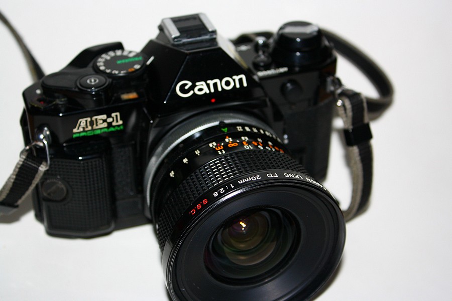

No, you are wrong here. Only the oldest breech lock lenses with chrome noses as well as the FL lenses have a green circle, all others have a button or rather a knob for the "A" position.
The A to M peg does no longer exist in FD-land.

Just to show you: breech lock FD with button:
