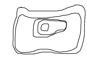

Whatever you call it, my A-1 has a strong central area with two f/stops of emphasis right around the focusing spot/microprism area. I just put up a light bulb in the darkroom and aimed at the bulb, noting f/stop as I moved around.
There is an odd cat-eye right included in the central spot, and a strong bottom-emphasis.
I don't know if the cat-eye is an alignment error in my specific camera but if not, it fits the idea that maybe the pattern was designed to be useful for horizontal and vertical orientation assuming you turn the camera clockwise for verticals.

The diagram I drew today was from my own measurements of my own A-1, and my diagram supports what some other sources have said: The A-1 evidently has a "bottom-centerweighted-average" type metering pattern.
