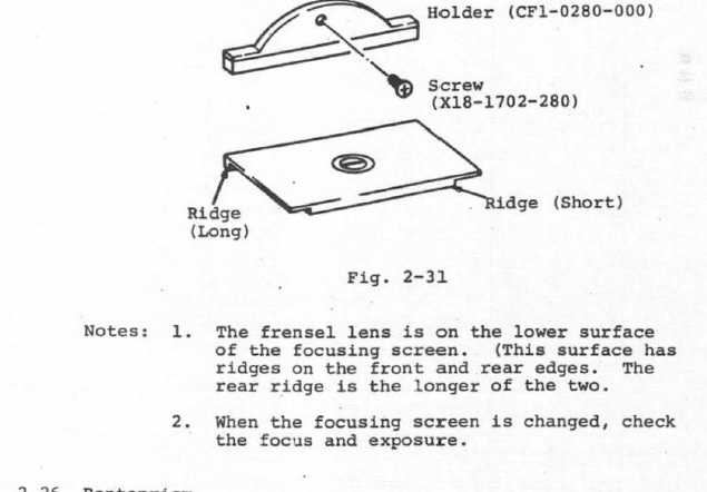

Update - after doing further research and some tests, it appears the focusing screen on this A1 is installed upside down. Everything I have read has indicated that the "shiny' side of the focusing screen should be facing down towards the mirror, and the matte should be facing up. Does anyone have experience on this and could verify?
From the Canon Service Manual: Hope this helps.
In every camera I've owned, the shiny side goes toward the viewer, the matte (etched) side towards the lens or mirror. But that may not be true for your particular camera for some strange reason. Here's a thread from someone w/ an identical issue w/ your model camera. Pretty confusing.
My guess would be that the etched side of the screen "should" go towards the mirror/lens to get accurate focus, and since your's isn't, and since it has focus issues........
It should be virtually impossible to put the screen in upside down. But it might not be seated properly.
Pretty confusing is right haha. From what i gathered from that thread the A series canons have the shiny side down while the F1 had the matte side down. Apparently this has something to do with the waist level veiwfinder that can be veiwed from the top on the F1s. My k1000 has the shiny side down. Dropping off at the local camera shop today, lets all hope its an easy fix because the rest of the camera appears to be in magnificent shape.
