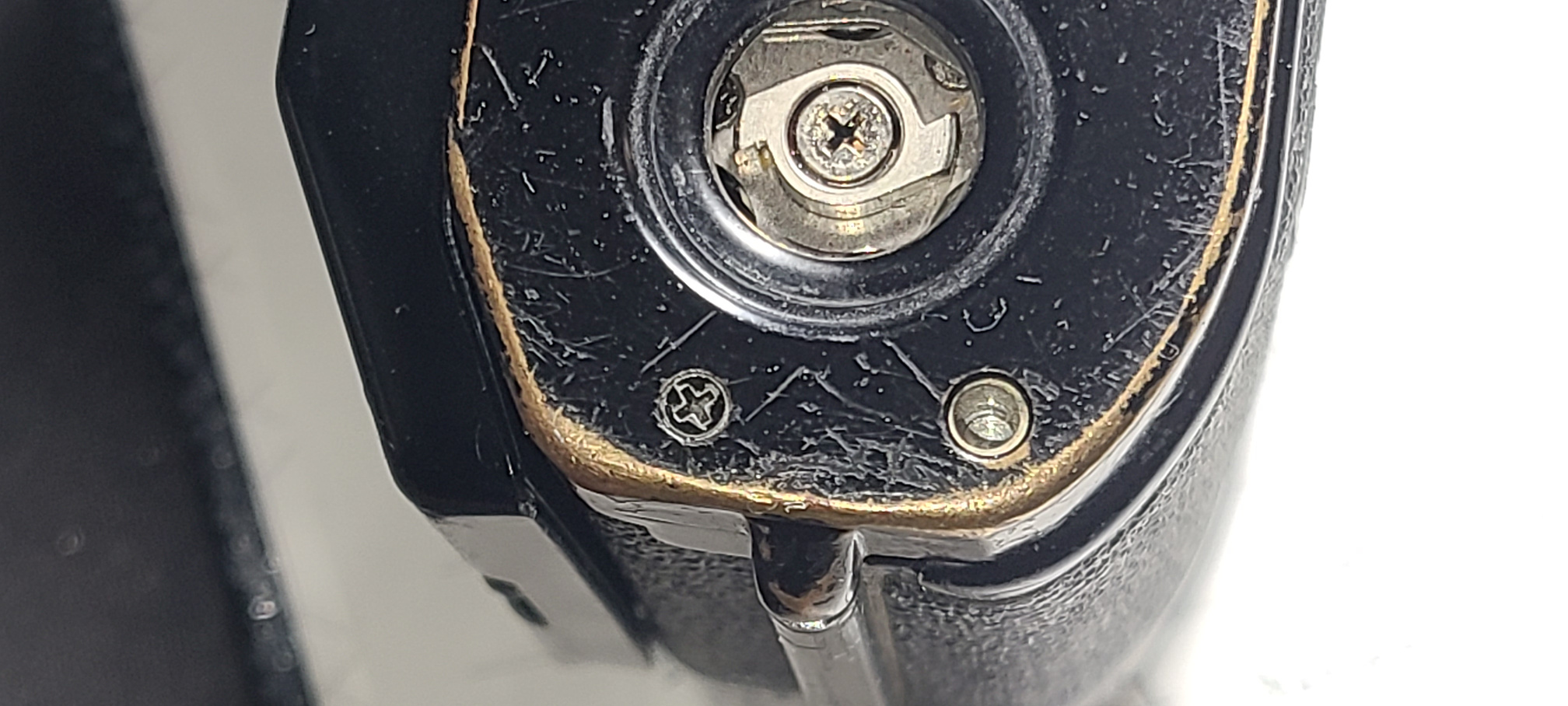

Bottom cover – There are just 2 screws holding the bottom cover in place. Be careful when reinstalling these screws as they sit next to alignment pin receptacles and it can be tough getting the screw back out of the recepticle if you stick it in there by mistake.

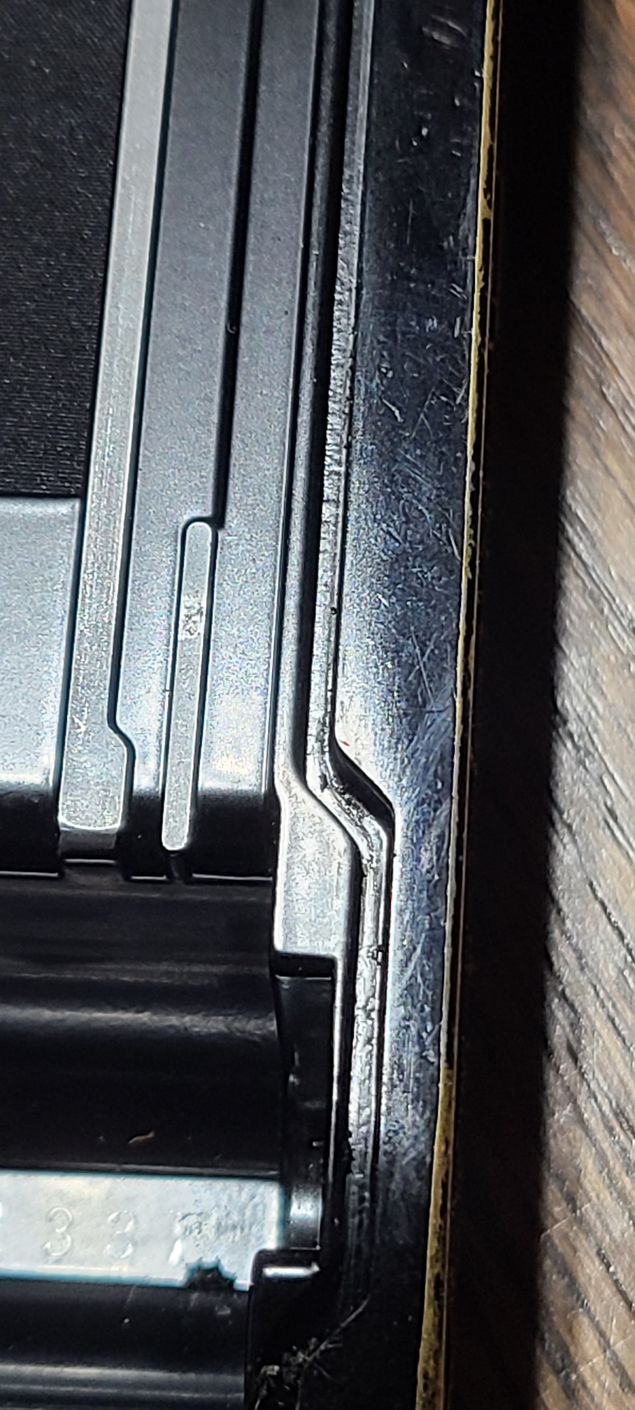

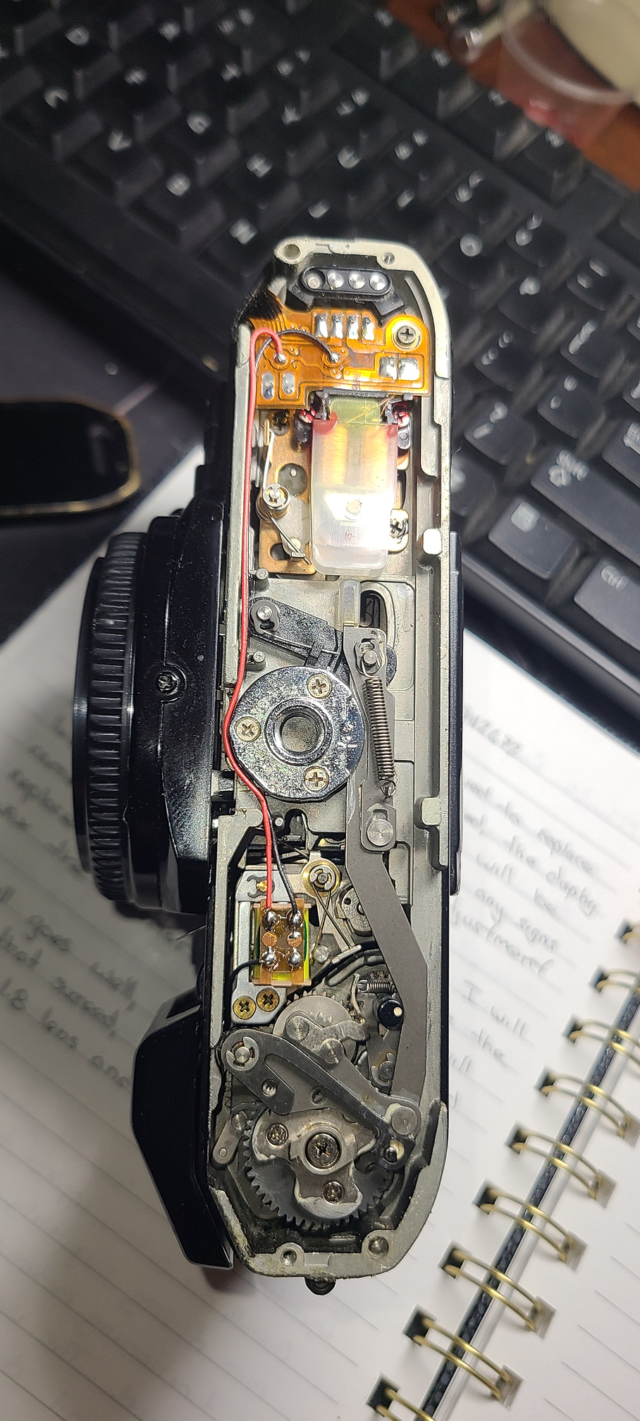

With the bottom cover removed, things look pretty good. I’ve worked on A-1s that have had corrosion in this area but this one is pretty clean. An operation test shows the magnets are functioning as they should.
While the bottom cover was off, I lubed what I could reach. Lube was done with a very light oil using the tips of needle nose tweezers. Once done, I replaced the bottom cover.

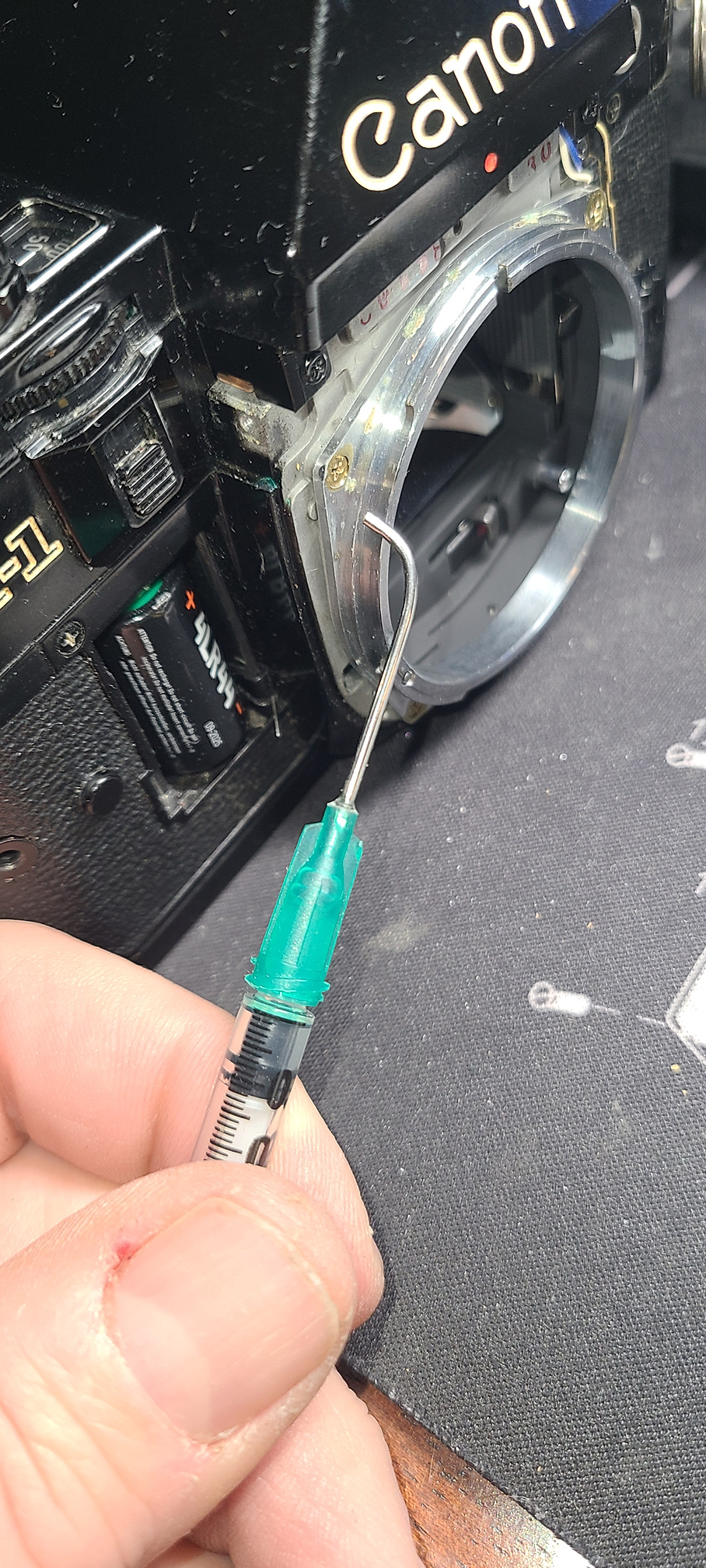

Remove the top left bayonet mount screw to provide access to the mirror lift mechanism. If this screw is very tight, try putting a swap soaked in acetone on the screw head to loosen the adhesive used to prevent screws from coming loose. The source of the Canon Cough comes from a flywheel located near this screw mount.
The process that I’ve had luck with to lube that flywheel is to take a syringe with a blunt needle and carefully bend the tip to about a 45 degree curve. With the syringe completely empty, draw the plunger back to about the halfway point to fill it with a air. Then put the tip in a drop of oil and draw it back ever so slightly. The plunger should barely move when you do this. Then , pull the tip out of the drop of oil and draw the plunger back another 1/8 inch. This puts a tiny amound of oil about halfway up the needle. When you quickly depress the plunger, you will get a tiny spray of oil kind of like a sneeze.
Practice this several times until you can repeat it easily. Now, prep the syringe and insert the needle. The area that you are trying to get oil to is just inside of the screw hole, to the left and down. It sits behind the side of the mirror box frame in the area where the needle is pointing towards in the picture below.
Spray the droplet of oil into the hold and then cycle the camera shutter a couple of times. If there’s no immediate improvement, try a second time. If still no improvement after about 10 shutter cycles, let it sit for a day to let the oil migrate. If it still is no better repeat the process. Be careful here though, as you don’t want to over do it. A little be of oil sprayed in the right direction is all that’s needed.

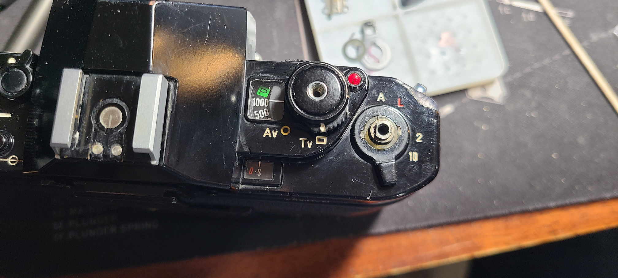

Top Cover – Gene Pate’s article served as the basis for the top cover removal process that I followed. He states that there are 36 parts that require removal before the top cover can be removed. I did not count them but would say that he’s correct. My process for disassembly of complex items is pretty straight forward. I use small divided trays to hold parts groupings and take lots of notes about how something comes apart and in what order I found the parts in. I also note anything that might not be obvious during reassembly.
To remove the top cover, you start with the AV switch guard. There’s a tiny steel ball detent in there, so you need to be careful. Next is the advance lever. The pin face cover screw scratches very easily. I put electrical tape on top to try to protect it but even then, it will show signs of my ham handed nature. There should be a thin washer, wave washer and plastic washer under the screw but sometimes I find the thin washer missing. I don’t know if Canon changed the assembly process or if someone just forgot to install that washer.
Under the advance lever is the advance lever seat. Then comes a snap washer, flat washer, CNTS and ME levers. You move to the shutter button next. This unscrews from the very top ring. It can be really tough to remove without marring it. I use two layers of electrical tape and a piece of thin leather. This lets me grab it with a small pair of pliers. The best way is a compression wrench though. I don’t have one so I take extra care to remove it cleanly. Under the shutter button are 3 washers and the A/T change lever. The manual has the 3 washers together between the button and lever but I keep finding cameras with the very thin black washer beneath the lever.

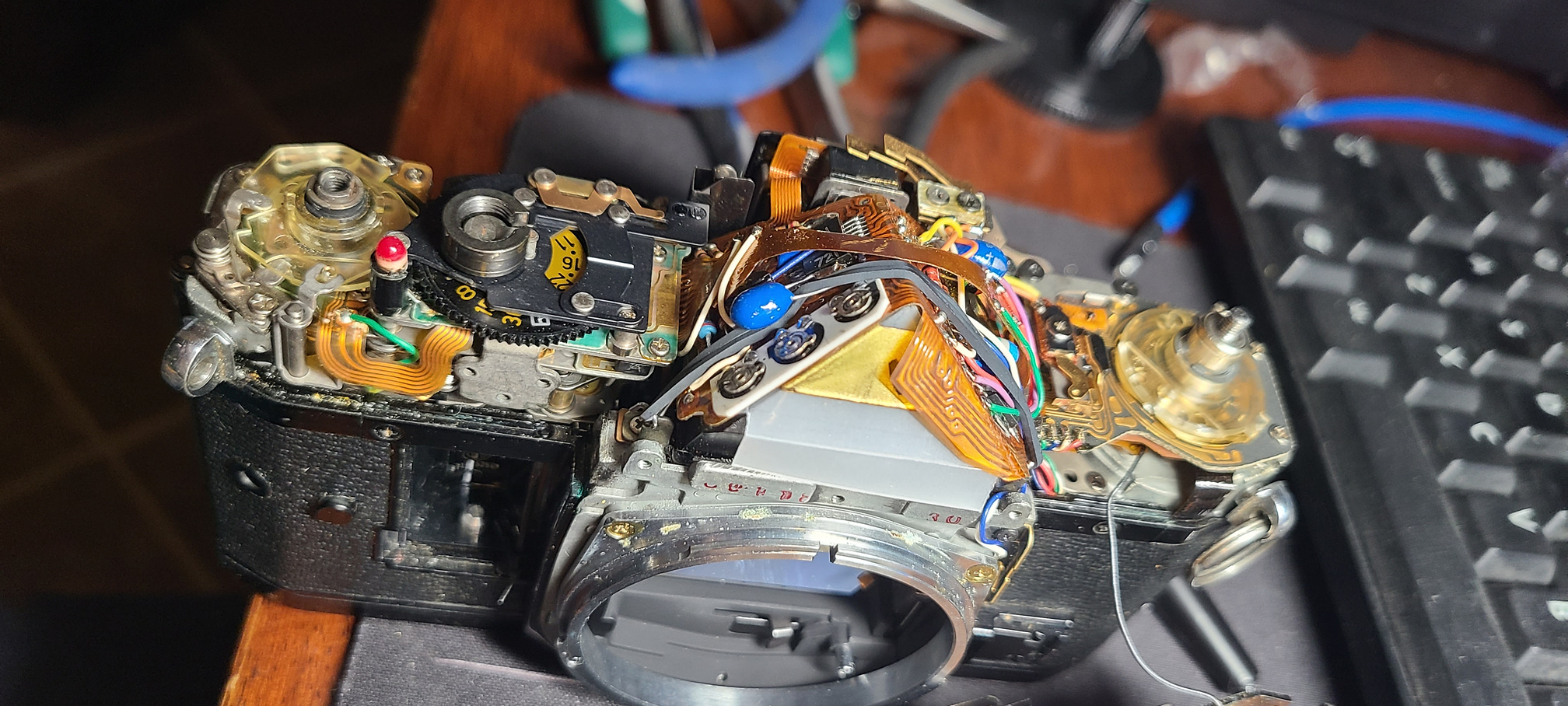

Remove 6 screws and then gently pull the top cover up just a bit. The LED battery indicator will pop off but might need a bit of alcohol to loosen any glue that might have been used during assembly. Sometimes the ring around the LED comes off. This can be reattached with a bit of Pliobond during reassembly.
Continue to lift the top cover off, being careful of the hotshoe wire. If the top cover will be off for any length of time, I recommend unsoldering that wire.

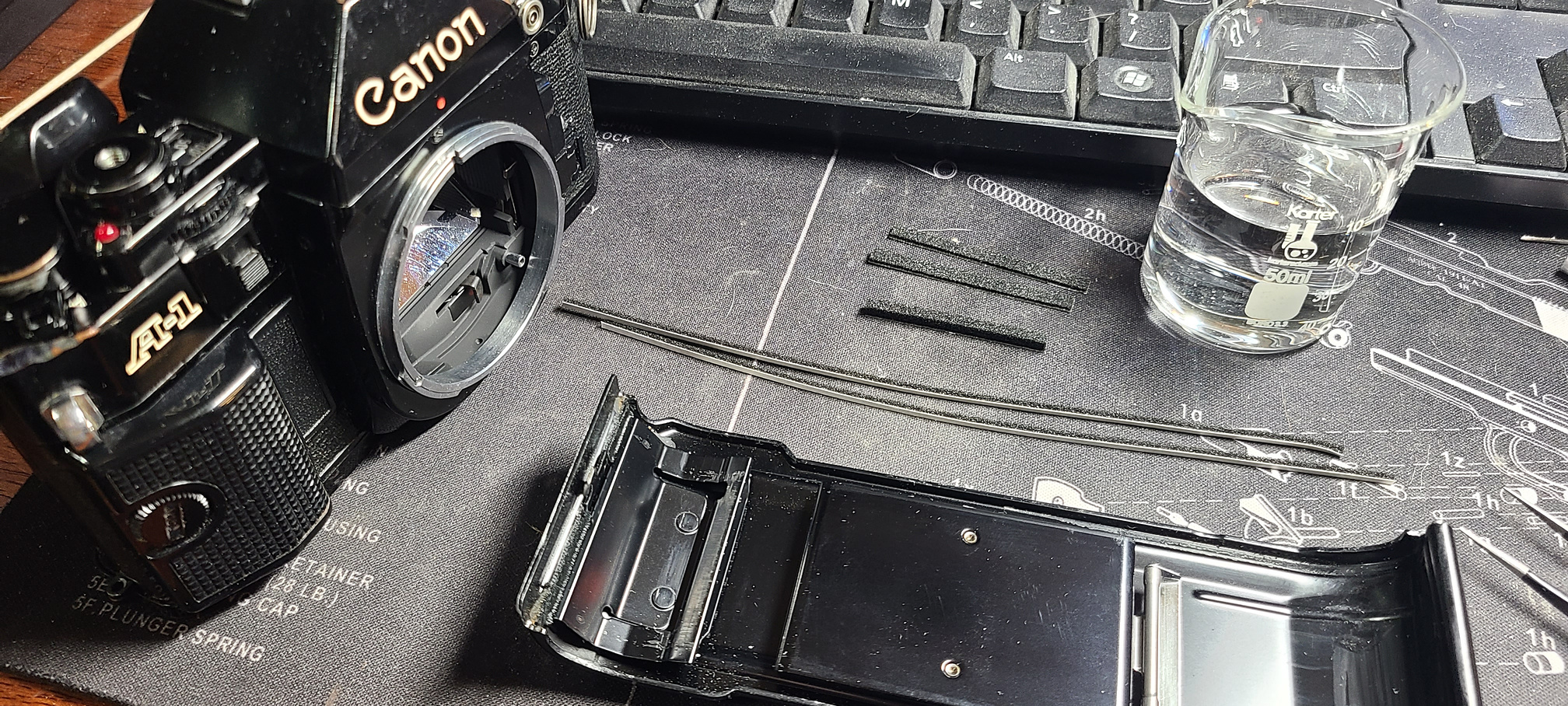

I did the light seals next. The key here is to keep debris out of the camera while making sure that you clean the channels very well. I have found that bamboo skewers work well but my favorite tool is a brass pick that has a flat end. This was designed for cleaning firearms. Here’s a link:
Pro-Shot Gun Cleaning Pick
Cotton patches with a bit of alcohol work really well with this tool. It is sized perfectly to fit in the seal channel and when wrapped in a soft cotton patch and alcohol, it leaves the channels very clean. I buy Canon A-1/AE-1 light seal kits in packs of 10 from US Camera. They include instructions on installation so I won’t go into detail here.

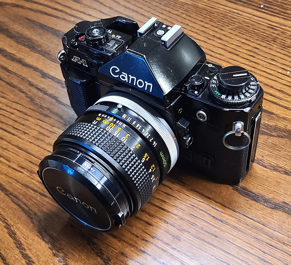

After installation, I let the camera sit over night to let the seals set. Then in the morning, I loaded a quick 15 frames from a bulk loader and took the camera out to the local airport for a test at lunch. In the evening, I developed and scanned the images. The pictures were mainly taken with AE exposure, both AV and TV but also manual exposure. The compensation dial was set to zero to see how the camera was metering. The lens was a known good Canon FD 50mm f1.4 from my F-1.
The results show that the camera is functioning fine now. I’ll shoot a couple of more rolls of film through it and if all is well, I’ll probably gift it to a friend that has an interest in film photography.
