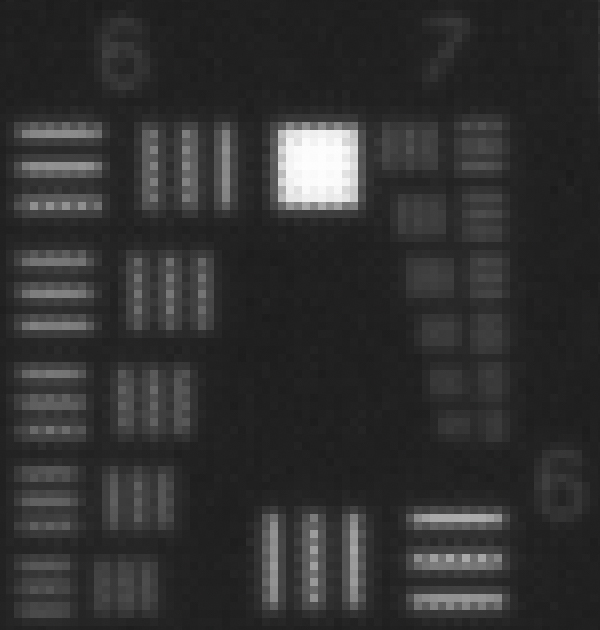

For reference and for discussion if people wish to: https://en.wikipedia.org/wiki/1951_USAF_resolution_test_chart
This is scanning 135 format film frame size, Black and White (color will be lower resolution due to the bayer array) using a Canon 90D, 1/200 second shutter, ISO 100, xenon strobe light source, and Sigma's newest 70mm Macro ART lens, at the lens highest resolving aperture setting, which is f/5.6. I've taken this exact frame from f/4 to f/22 in 1/3 stop increments and f/5.6 is easily the highest resolving aperture. Even a third of a stop in either direction is visually less resolution.
By my eye, Group 6, Element 4 is resolved, which is 90.5 line pairs per mm. You need 2 pixels per line pair, so 181 pixels per mm, multiplied by 25.4 mm per inch gives us ~4600dpi resolution. If you prefer to call Group 6 Element 3, then it's ~4100dpi.
Either way, for 35mm black and white film, you'll be fairly hard pressed to get more resolution with any other scanning system.

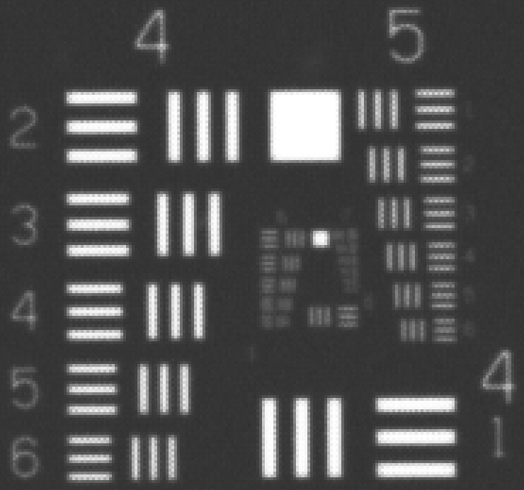

digital is not film. Digital sensors have a contrast response of 100% all the way up to the sampling Nyquist. The sensor in my system is 6900x4600 pixels and I’m scanning an area that vertically is from sprocket holes on the top to sprocket holes on the bottom, which means my 4600 pixels is spanning just over the 24mm, close enough to 25.4mm, and I’m resolving 4600 dpi…. Which means… there is no 50% or 10% TOC. Well there is, but they’re probably 4625dpi and 4650dpi.
this also means that the Sigma art lens resolves a lot more resolution than the sensor, or we’d be seeing the MTF of the lens as it rolled off, and apparently it doesn’t. I’d need a higher pixel density sensor, and nobody makes a sensor that has more pixels per square mm of sensor. If they did and it was even remotely cost effective, that’s what I’d be using.
