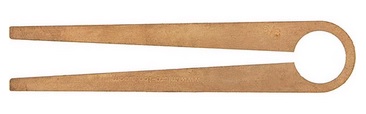

I am pretty certain that you will need to buy or DIY a "flexiclamp" wrench:

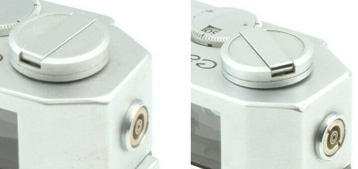

It appears that Canon had at least 2 versions of the part of that 7sZ part:

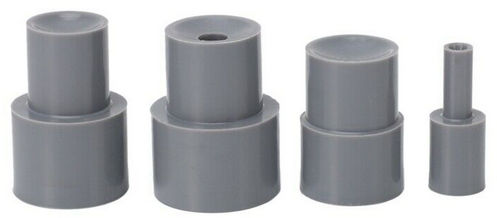

if yours has no slots cut to allow the use of a spanner wrench, and a flexiclamp-type wrench didn't work, the only other thing I can think of is to try a rubber pad-type tool:
Sembra che Canon avesse almeno 2 versioni della parte di quella parte 7sZ:
se il tuo non ha fessure tagliate per consentire l'uso di una chiave inglese e una chiave di tipo flexiclamp non ha funzionato, l'unica altra cosa che mi viene in mente è provare uno strumento di tipo pad in gomma:
grazie per la risposta; Il mio connettore del flash è come la foto a sinistra, quindi non ha "prese di forza" per una chiave, quindi penso che proverò con i gommini che hai suggerito.

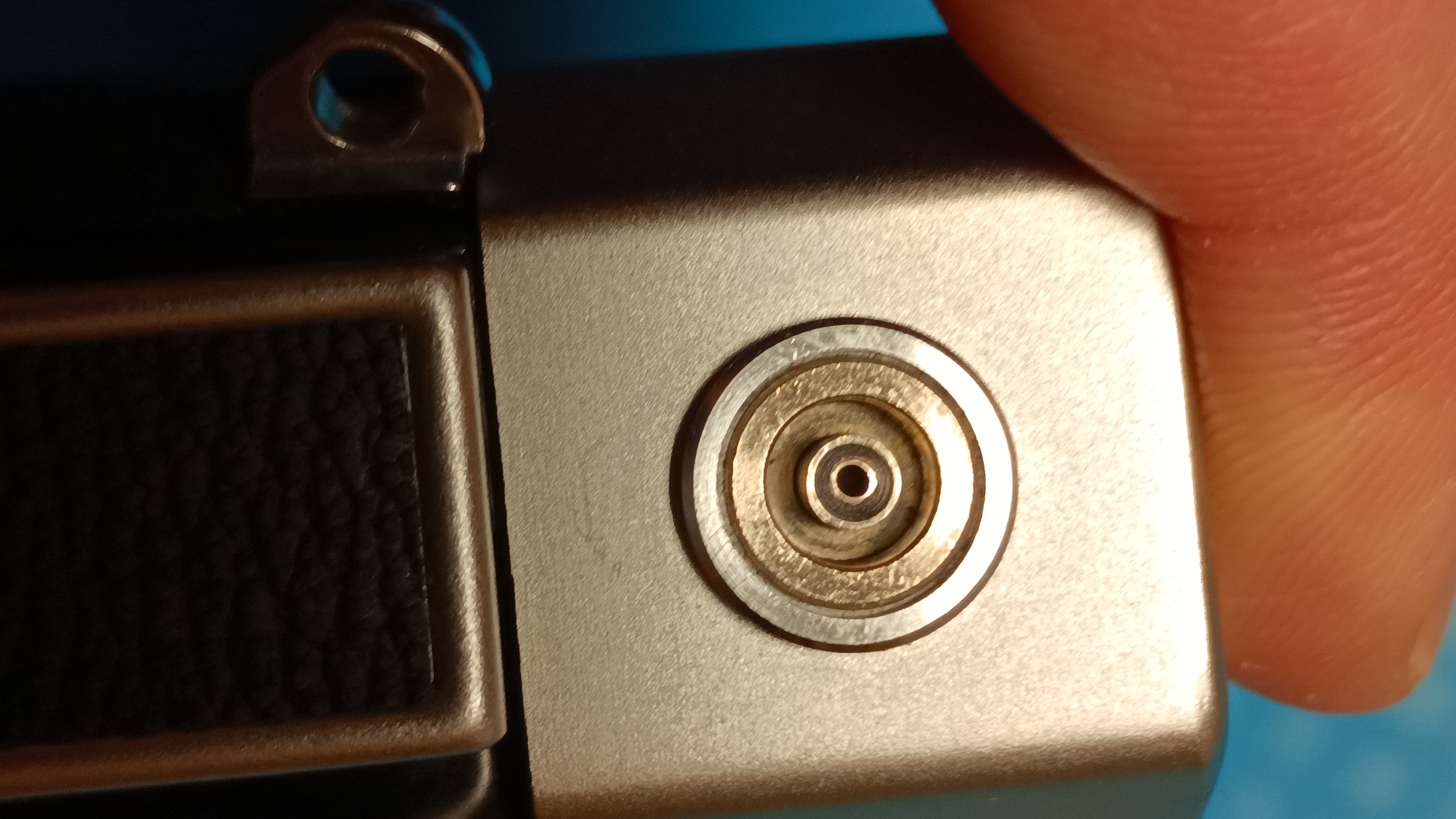

Flexi clamp would work only if outer ring can be used for unscrewing. If port is the same as in Canon 7 then actually internal brass part needs to be unscrewed?

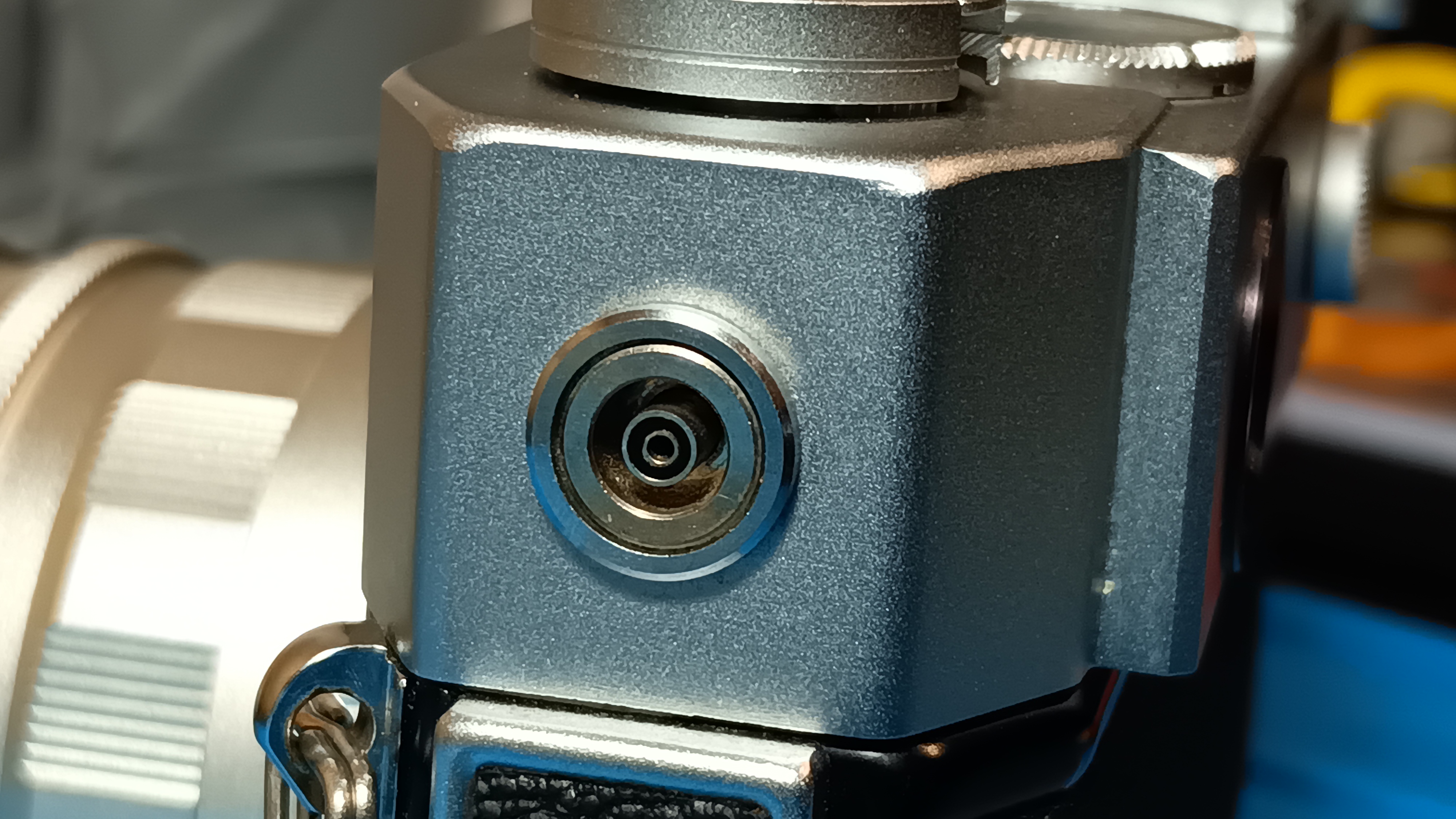

Isn't there a slot deep inside? Maybe I am misremembering. But I think that I can see it in your photo. A slot at about 5 o'clock and 11 o'clock at the bottom of the flash sync rod. Take a long thin screwdriver that fits down there and unscrew it- standard counterclockwise. Or carve one from a wooden chopstick.
Nope, no slots at all :sad: it's possible to grab outer ring with a flexi clamp - and I managed to do it but it just turns, does not unscrew.
