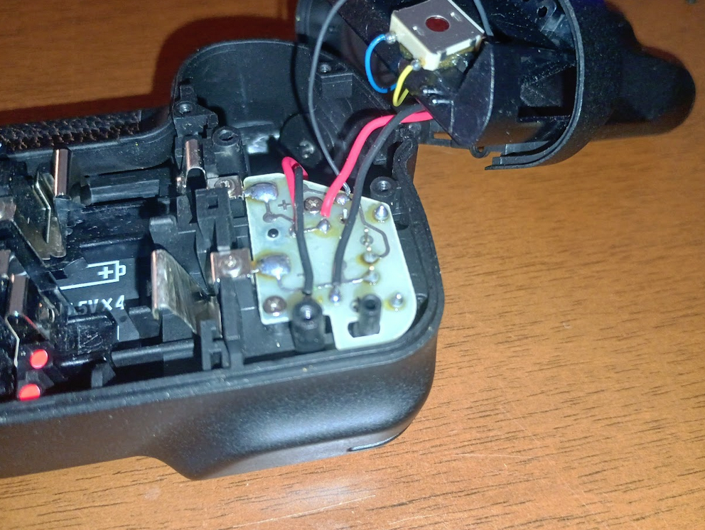

now i have make it more clean, but i would like to see what is inside the bp-50.

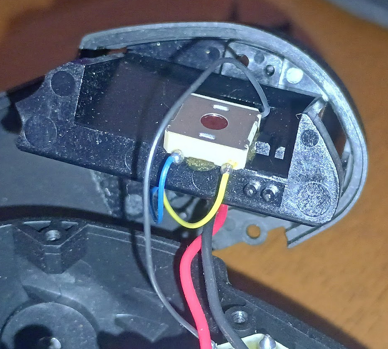

Open it up!
Anyway, fingers crossed, it seems like everything's resolved now. I disassembled the battery grip and thoroughly cleaned the contacts between the batteries, removing any signs of oxidation with sandpaper.
I also gently sanded the contacts in the camera's battery compartment, which weren't exactly shiny, and when I used the grip, it made things worse.
I unscrewed everything from the grip and only solved the problem after removing the grip's on/off switch. I didn't do anything major there, but I had to disassemble it twice. Let's hope it's completely resolved, but yesterday, burst and flash shots worked flawlessly with the IKEA rechargeable batteries (are made in japan and someone say are panasonic).
Very nice. I'll include some of your photos here in the thread so they remain available for future reference. If you're not comfortable with this, let me know and I'll remove them.
I can see how contact problems could arise from a loose fit of the BP holder inside the camera. It's been a long time since I've used one (I dislike the bulk and weight they add), but I recall the shaft that slides into the battery compartment on the camera and how this would only contact well if the BP holder is screwed into the camera securely.
