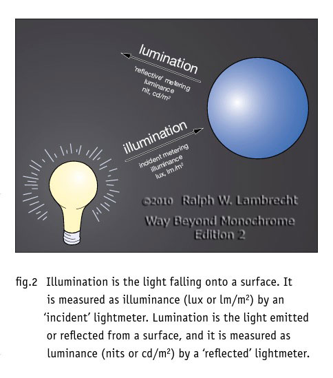

Lux and nits (candela/m^2) not lumen, but why don't you just record EVs? Most lightmeters measure in EVs.
