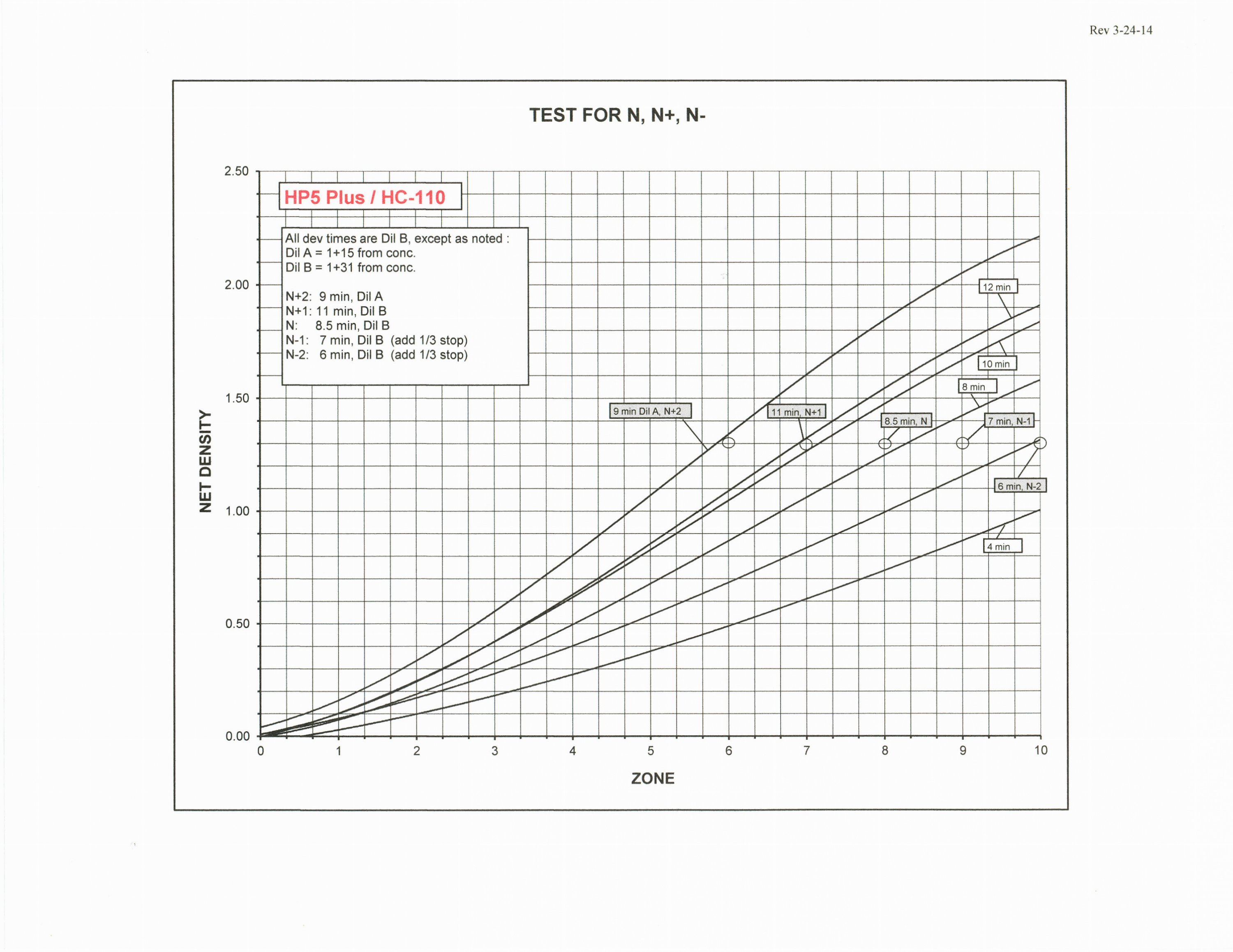

... Curve-wise, HP5 always has that "hump" which increases shadow and midtone contrasts (which I love). FP4's has a straighter line ...

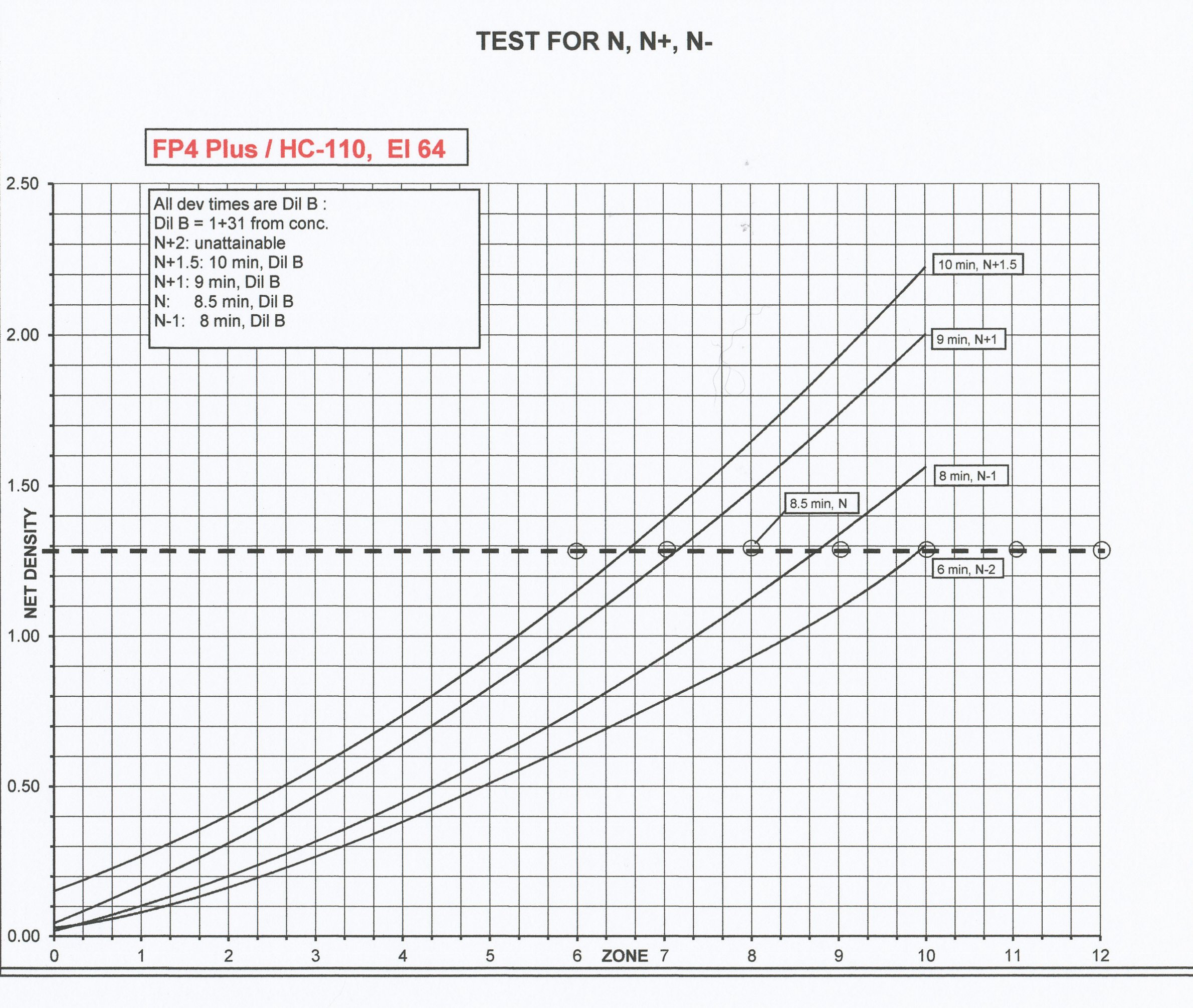

Andrew, I’m curious about the “hump” you describe with HP5+, as I see no such behavior in my tests when developing in HC-110 (EI 200). Granted, my tests were done with sheet film, but according to my query to Ilford (see below) some time back, this should not cause a significantly different result than the roll film version. And I doubt that agitation differences would cause a hump. Perhaps a staining developer might cause one, but I’ve never used one so IDK.
I’m attaching my test results for HP5+ in HC-110 (EI 200) as well as FP4+ in HC-110 (EI 64) for a comparison. For both plots, "Net Density" of zero represents film base + fog reading.
Ilford comments:
… there can be small differences between 35mm, 120 and sheet film as these do use different bases and slightly different emulsions. Although we endeavor to manufacture all three types to be as close as possible in order for development times to be consistent across the range for any one film type (and they are for most practical purposes) …
Ilford comments:
That FP4+ chart is very interesting to me... maybe I'm not reading it right. What is your development temperature and agitation scheme? I developed 35mm FP4+ in HC-110 and found I needed to use dilution 1+60 (from the syrup) for 7:00 at 20*C to get printable negs. When I followed Ilford's recommended time at dilution B the negs were denser than a black hole

All my curves were developed using sheet film, using Xtol 1+1, and Pyrocat-HD. This hump in the curve I referred to is subtle, but noticeable. DI#13, a developer concocted by the late Phil Davis, really exaggerated this hump.
Temp = 20*C, 4x5 sheets (6 sht stack, shuffled in tray, once through the stack every 30sec). No idea how that agitation compares to roll film inversions in a spiral reel. Stouffer 31-step wedge taped to film in 5x7 camera (Sinar monorail) to keep camera bellows farther from film, shutter speeds tested prior to testing, bellows lens shade to minimize flare, white mat board illuminated with blue floodlights to approximate daylight. Reflection light meter, calibrated by Quality Light Metric in LA, exposure placed on Zone X. EI determined prior to test with identical setup conditions.
