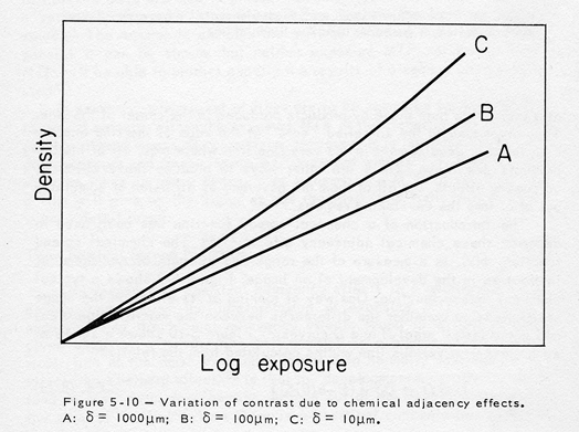

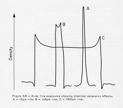

Patrick;
I'll repost this here. It is a depiction of edge effects and how micro contrast goes up as the image size decreases. This is the ideal developer film combination in which smaller formats have higher micro contrast.
It is how a 35mm negative can have the same relative edges as a 4x5 image and the same relative appearance at an equivalent magnification and viewing distance.
The higher contrast with smaller objects in smaller frame sizes is magnified to give roughly equivalent image quality to the larger objects in a larger frame size. In effect, a telephone wire on a pole might be 10 microns in 35mm and 100 microns in 4x5.
This is a real example using a film / developer combination that was optimum for each other. It is also why we all seem to get different results with different film / developer combinations. These types of effects do not work together unless the optimum is used. Kodak works these out and makes suggestions for every film and developer to achieve this type of result.
These figures were taken from Kriss' article with his permission.
PE

I presume you are showing microdensitometer traces across silver images of lines of different widths. We are lacking information about the widths of the lines that were photographed. It seems that the narrowest line would look even narrower.
I still do not know why we should be searching for more and more pronounced edge defects. They will in any case be added to those that the eye of the beholder supplies.

Patrick, the line widths are as indicated on the traces. They were exposed at exactly that width. They are made to roughly simulate a given object at 35mm, 120 and 4x5 format sizes.
