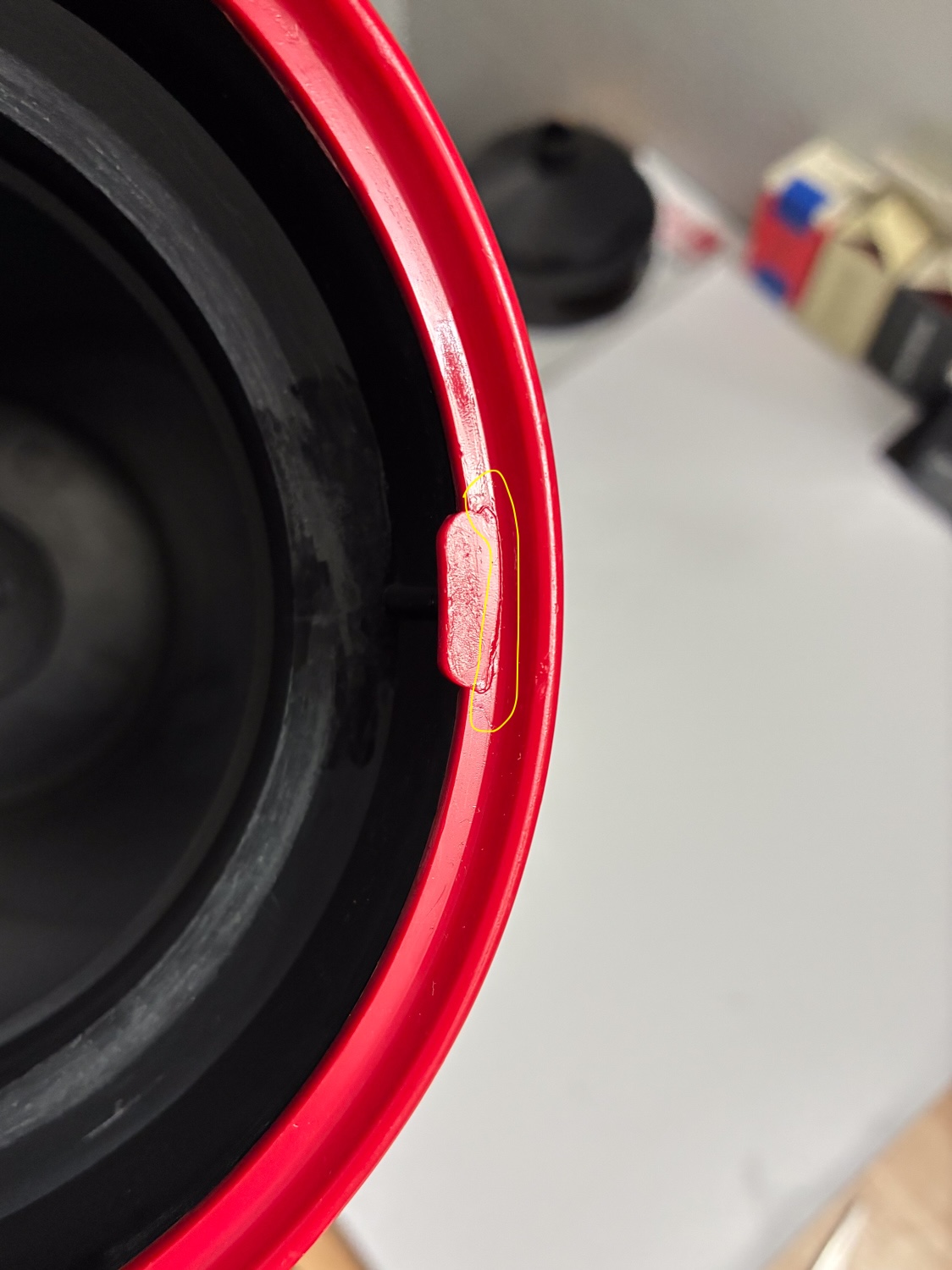

After years of diligent service, my Patterson tank showed its first sign of fatigue. One of the red prongs that holds down the light-tight funnel broke. I repaired it with a shoddy super glue job and a hair dryer.
The instructions read, "...not recommended for submersion in water." Well, darn.
I doubt I am the first person to try my luck with this. Nor will I be the last. Have you had luck with super-gluing your tank this way? I do wonder if there could be an unfortunate chemical reaction between the dried glue and hot C-41 chemistry. I have never tested super glue's mettle on an item that routinely bathes in 104-degree Fahrenheit liquids.
I am weighing the risk of the piece breaking, falling into the tank, and scratching every frame during my next development cycle. Nightmare.
Thanks in advance for any insight you may have.

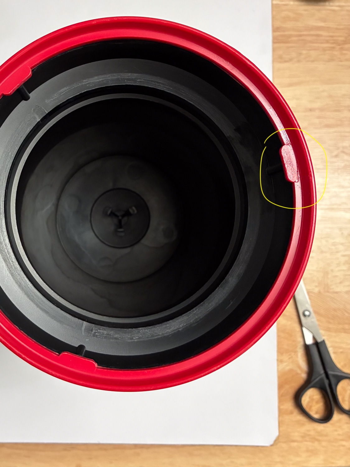

I forgot to take the "before" pictures. Here are the "after" ones:
I would replace the tank, but I think you can get away with the just 2 remaining as long as you are careful when turning the top on and off. In terms of glue, there are marine adhesives, tend to be expensive.

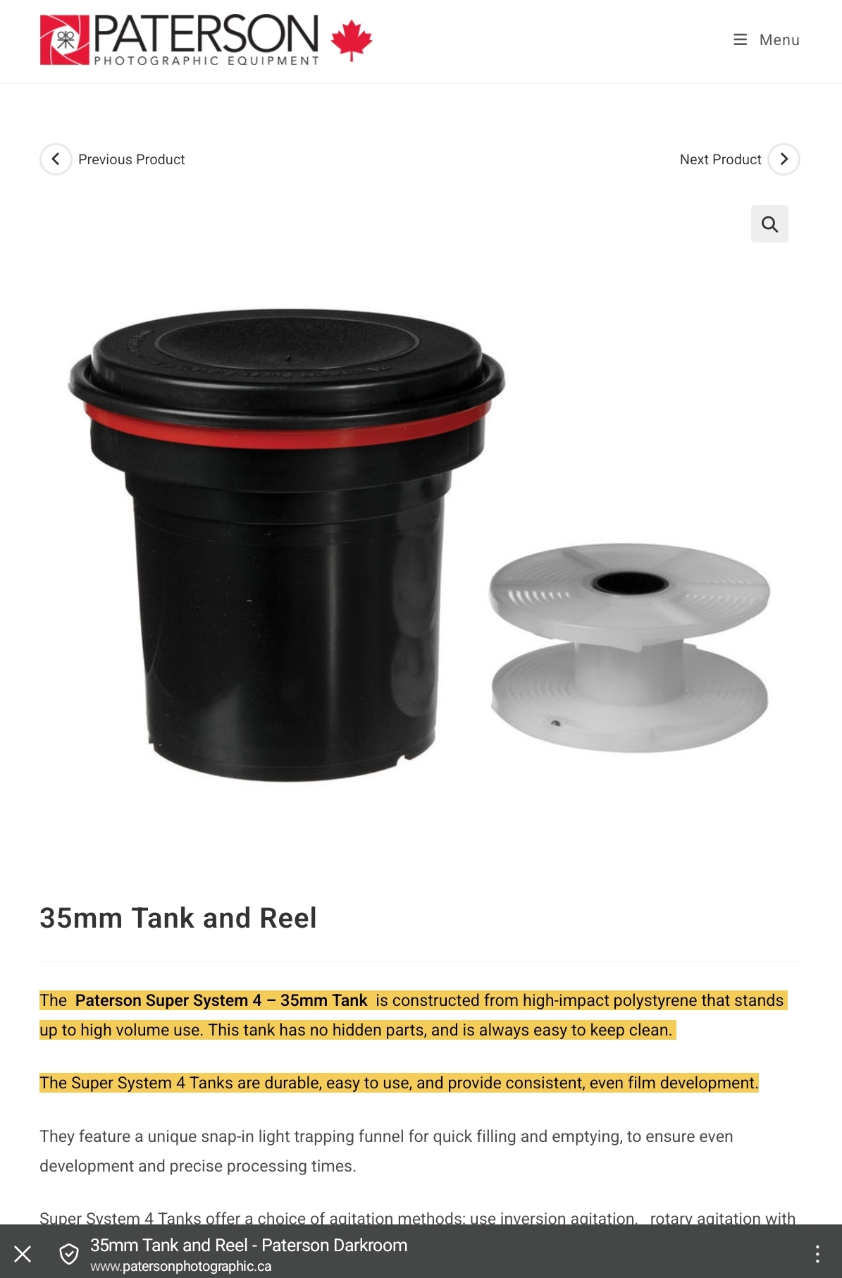

I think the Paterson tanks are made of polystyrene (HIPS), in which case I’d use a suitable solvent cement. There are many options.
Cyanoacrylate superglues are not great for this kind of stuff.
Yeah, the right glue will cost more than a tank, use the broken one for wash. Appeal to Paterson for a replacement.
The first step when gluing any kind of plastic should be identify what kind of plastic it is, if at all possible. A glue that works well with one type of plastic may not work at all with another type of plastic.
*If* the cyanoacrylate superglue is the right glue for your plastic tank, then I would worry less about the water warning. There are several adhesives that warn against continuous submersion, but which hold up OK if occasionally submerged for a short time.
Assuming those drums are either thin ABS or styrene, you want a solvent-style plastic plumbing pipe cement. Make sure the sections are held together tightly while the cement cures. Don't use Super Glue or a urethane glue like Gorilla glue.

I don't think that tanks are styrene, it is less rigid than the tanks are. It's more likely ABS.
You may be right, but I found this page that says HIPS:
I suspect the material of the tanks may have changed a couple of times over the years. Or, put differently - I can't imagine a 1970s Paterson tank being made of the exact same polymer as one manufactured today. Too much has changed in the realm of engineering plastics.
More likely, too much changed in terms of cheapifying the product : down-engineering for sake of low-bidder cost saving. Styrene breaks a lot more easily. But it might also have been chosen for stiffness in combination with thin walls.
To add complexity, the part that broke on the OP's tank belongs to the red ring piece, and that isn't necessarily made of the same plastic as the body of the tank. It might be, but we don't know. The Paterson copy probably refers to the tank body.

Hello everyone. Here is a quick update:
I will follow up again after I look into the details about the material the tank is made of and the glue I used. I plan to keep the broken tank for now.
I figured it would be easiest to just test this and follow up when/if it eventually fails. I'll save this repaired tank's use for unimportant test rolls.
I just used it in C-41 chemistry for the first time since gluing it. It held up fine.
Note: I'll come back and list the exact type of super glue I used at some point.
Successful Use Count: 1

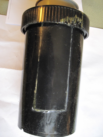

Here is an extreme case of repair using super glue. The seller wrapped the tank in brown paper only, and the Post Office handlers perhaps damaged the tank through rough handling. I received it in six pieces, the tank was split down one side. The patch on the side was cut out from a food tray.
Knowing that super glue is very toxic, I let the open tank sit for a week to let the toxic fumes dissipate. These fumes will ruin a film in seconds if the film comes within range of them. I've learned already with a camera repair to the rear of the bellows, and was a little too quick to expose a film after the repair. Fumes from the glue affected the emulsion leaving light grey swirling marks on the B&W film.
I've used the tank for sheet film since repairing it, it doesn't leak, it got me out of trouble while I searched around for a room-light 4x5 tank which I finally found and acquired plus 4"x5" and 31/4"x41/4" stainless holders.
