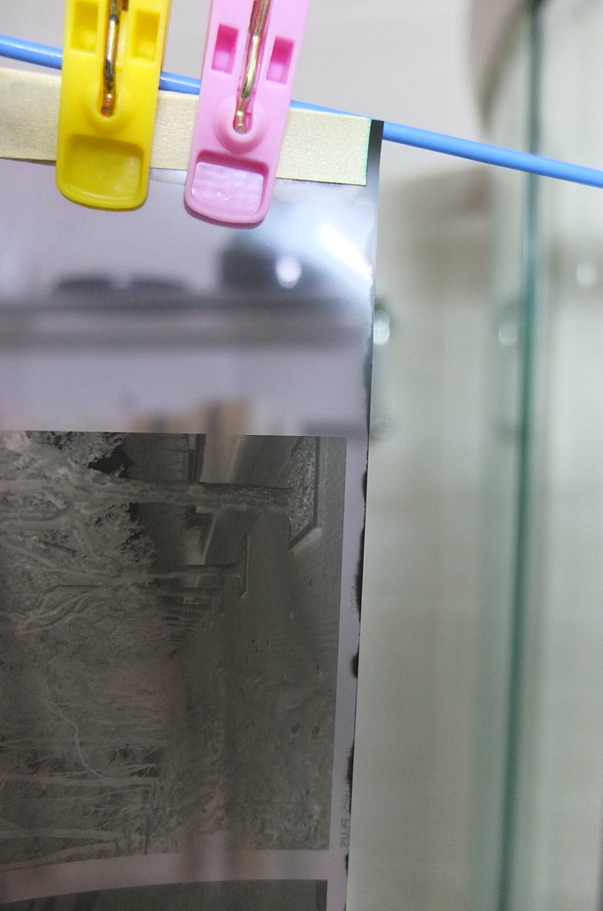

I am trying to hunt down the source of light that is fogging mostly the edges of my 120 roll film. Very very rarely the fog spills into the image area. Delta 3200 may be more susceptible to this fogging but I have not firm data to prove this.
I'm wondering if the "night light" in my dark room might be the source. The light switch in my closet has a thin strip of glow in the dark tape on it. There is certainly a glow when the lights are off but it is very very faint. I cannot see my hand in front of my face when in the dark room, but I can see this glow, about 2 feet away. I load my reels in this room, with my back to the light switch, but until this weekend, did not take particular care to keep the film out of line of sight of this glow in the dark strip. The strip is about 2-3mm wide and maybe 4-5 cm long.
Could this tiny bit of light be the source of my fog? When the film shows fog, it is not located only at the beginning or end of the roll, instead it is sporadic throughout the roll. My films always come out of the camera very tightly rolled.

Here's a picture of my latest film that showed this problem. It's pretty light fogging/damage. 99% of the time if it shows up, it is nowhere near the image itself. Because of this, I'm not all that concerned about it.

Now that I think more about this, a few of my Paterson reels show some light build up of a dark substances on them. The film is rubbing off onto my feels maybe?

My films started looking ^similar after I moved into my new apartment. Took me about a year to find out what was going on. I was able to rule out processing problems, as self-developed and lab-developed films showed the same problem; film brand or type didn't make a difference; my like-new Bessa-R with light seals in perfect shape was affected just as much as my older cameras with rather cr*ppy ones. The day the whole problem disappeared was the day I decided to no longer store my (loaded) cameras on an open book shelf in my living room that's hit by direct sunlight from noon to sunset...

I am not sure if I am seeing fogging streaks across the frame or not but the black "hills" on the very edge that look like a range of hills of varying height look exactly like the problem I have experienced with roll film that wasn't rolled tight enough.
You might not be concerned anymore if the "hills" are only on the edges of the film but one test might be to unload the film in total darkness and then place in a light-tight container and then processed in total darkness. If the problem is camera seals then the hills will still be there. If it is a post camera problem then the hills should have disappeared.
In suggesting this test I am assuming that when loading the film in only subdued light that the roll has been wound tight enough by the film maker at the factory to avoid any light ingress at the loading stage.
