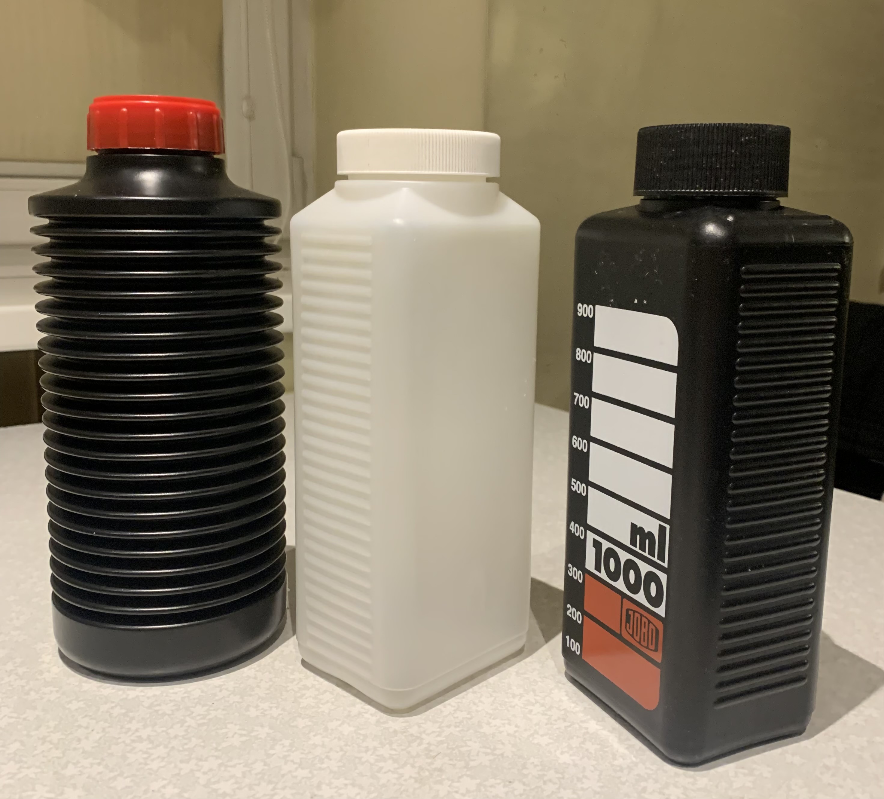

Hello,
I've bought some used bottles that are designed to store chemicals and I want to clean them because there are some impurities inside of them. To clean them I might need to pour boiled water and I'm not sure if these bottles can handle high temperature water. Did anyone tried that before? The temperature of boiled water can be up to 212 °F (100 °C).
Bottles:
Jobo Wide-Neck (1000ml) black,
KAISER / Cinestill Collapsible bottle (1000ml),
Plastic bottle white (1000ml).
Thank you!

They should be OK, but why would you need to use boiling water? If the deposits are 'crusty' such as dried on developer or other chemicals the safer way would be to fill the container with about 25% of the capacity and add either small pea size pebbles or small stainless washers and either shake them vigorously for about 5 mins, then clean out the contents and repeat.
Be aware that some chemicals can be partially absorbed by certain types of plastic and it will be impossible to get rid of all traces. This is particularly so with colour chemicals. Tetenal used to print warnings in their E6 kits such as keeping the measuring beakers for the 1st and 2nd developers in dedicated containers and not to mix them.
I would not use boiling water. Let some hot tap water sit in them for a while and use a good bottle brush.
Good luck!

Many plastic bottles will start to deform if you pour boiling water into them. Generally they bulge out under the weight of the water as the polymer softens. They usually never go back to their original shape afterwards. I wouldn't recommend it; stay below 60C or so to avoid such problems.
Those are a nightmare to clean anyway, and the harmonica thing is liable to develop leaks over time if used as intended as well. I'd steer clear of these bottles.

Those collapsible bottles are difficult to clean. The other one's will be easier, but the most effective way to get them clean depends on what kind of contamination they have.
I don't think citric acid is going to help very much, and there's a good chance that boiling water will shrink your bottles.
I think beyond hot soapy water and a good scrub, any further cleaning is going to be difficult without further information.
