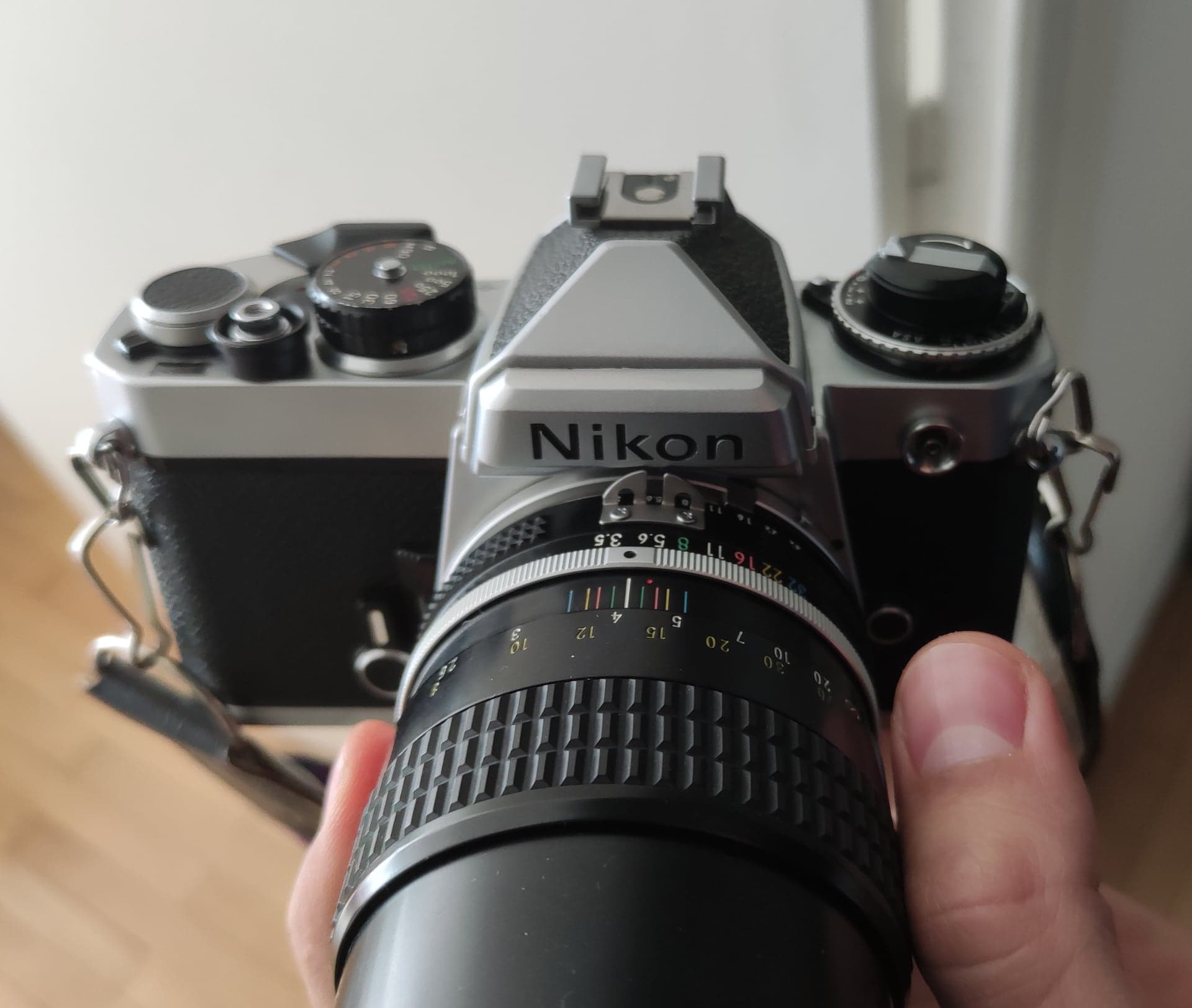

Hi everyone,
I'm quite new to the analog scene and I've been wanting to use my parent's Nikon FE SLR camera that was boxed with some nice Nikkor 50mm 1.4 and a 135mm 3.5 lenses for a few decades. Sadly, the shutter speed appears to be all mixed up for anything over 1/125 of a second. The body is in perfect condition, but I believe the electronic is having some issues (battery check lights up and I put some new batteries).
When I'm shooting I think the intergrated light-meter is indicating a correct shutter speed but as I said previously for anything over 1/125 the real shutter speed I get is very wrong, for example for 1/60s I get over 2 sec... so no need to say my pictures will be well overexposed ! At first I thought it was some kind of old oil in the mechanism and I tried several times to go from 1/1000s to the maximum 8s shutter speed to "clean" it but it didn't change a thing. Nevertheless, one time while shooting the camera at the sky I did have correct shutter speed on the whole range (I can't be 100% sure but 1,2,4 and 8s where correct at least, and the 1/x where indeed the double of each ones like when going from 1/1000 to 1/500 to 1/...)
I went to an analog photography shop (who saddly didn't do repairs) here in France and the guys told me it might be a faulty capacitor on the electronic board. After checking the Nikon FE repair manual at page 86 (click here) the trouble "incorrect shutter speed" refers to either a defective shutter or electrical circuit trouble.
I read online that this body is kind of considered "disposable" when it faces this kind of trouble because the repair would be too expensive but having a really stubborn repair-man like mindset I want to save it because it has some history (they bought it in Japan while traveling and it documented my whole youth).
#1 The "go ahead buddy you can do it" situation:
Being quite good with my hands I think I can handle a complete disassembly but how will I test the circuit in order to find what is going wrong with it? The repair would require me to unsolder a component and replace it with something new but do you think I can still buy that kind of capacitor? Can you recommend a good oil to do the mechanism too? Do you have any advices?
#2 The "it's a dead end buddy" situation:
What body should I buy? If I want to use my lenses my last resort would be to buy either a Nikon FM or FM2 or FM3a (because I wouldn't want to bother with something needing electronic to function...) but which one should I get and at what price?
Thanks in advance to everyone who will try and help me !

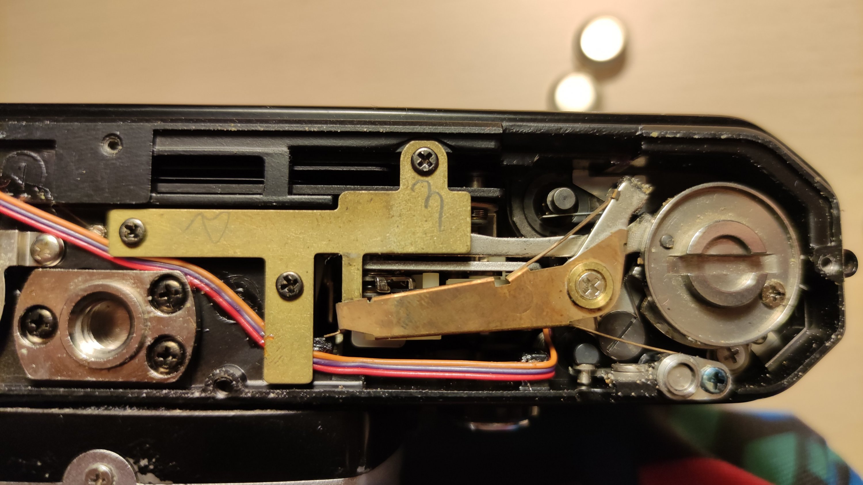

You can safely remove the base plate of the body and inspect the mechanical parts there and the battery wiring.

The previous disassembly guides linked seem enough for me to try it out and look at the timing circuit board but I would first need to understand exactly what I'm looking after.

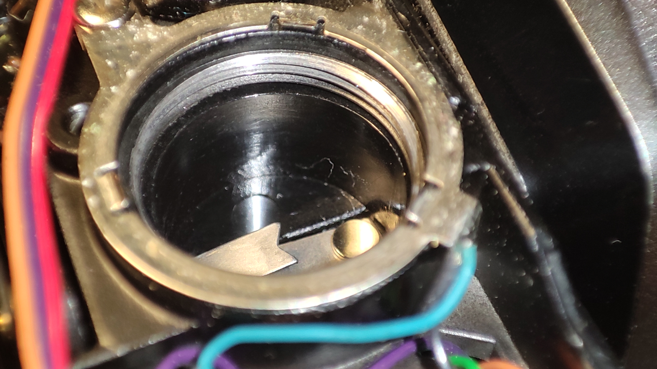

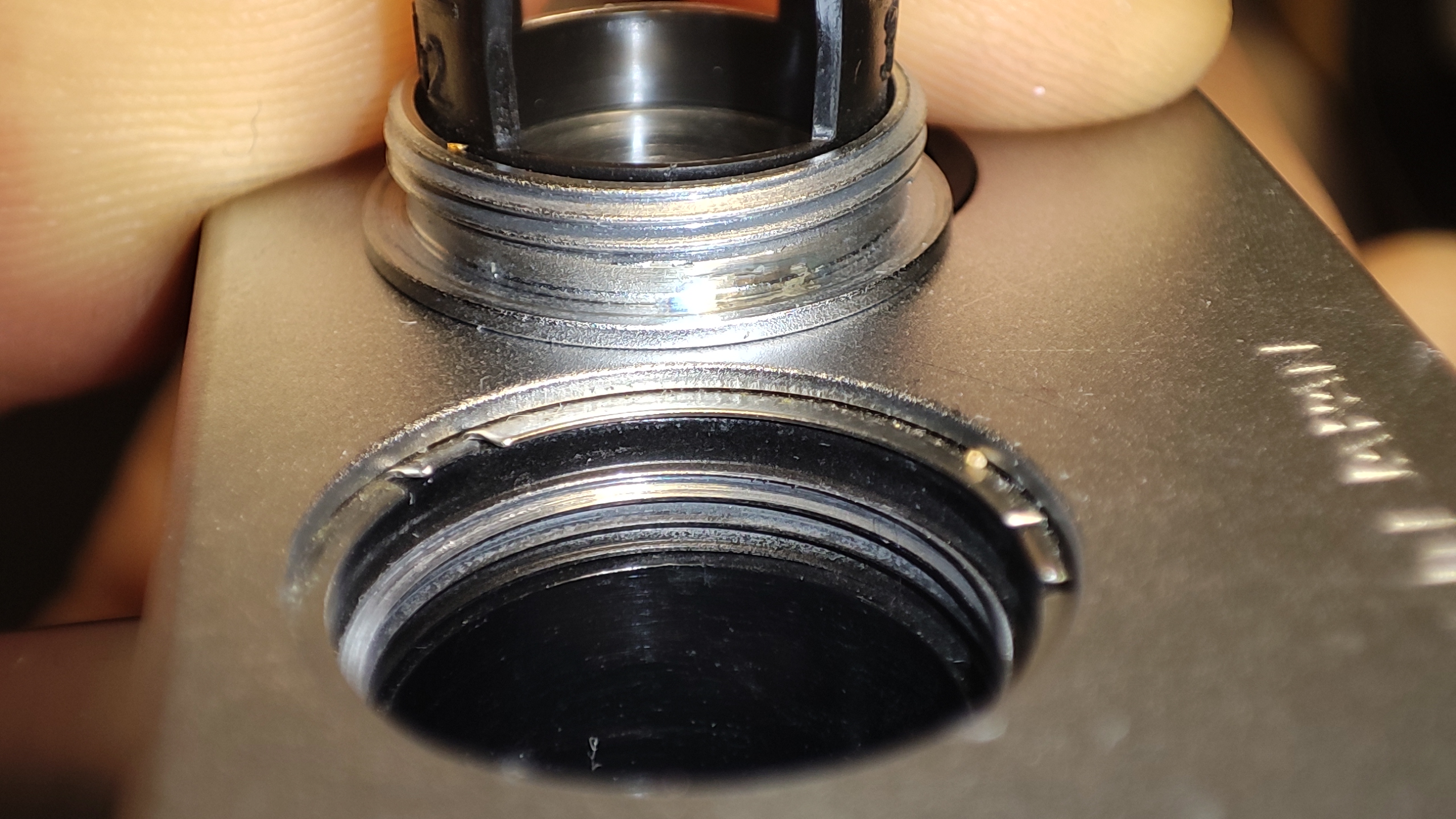

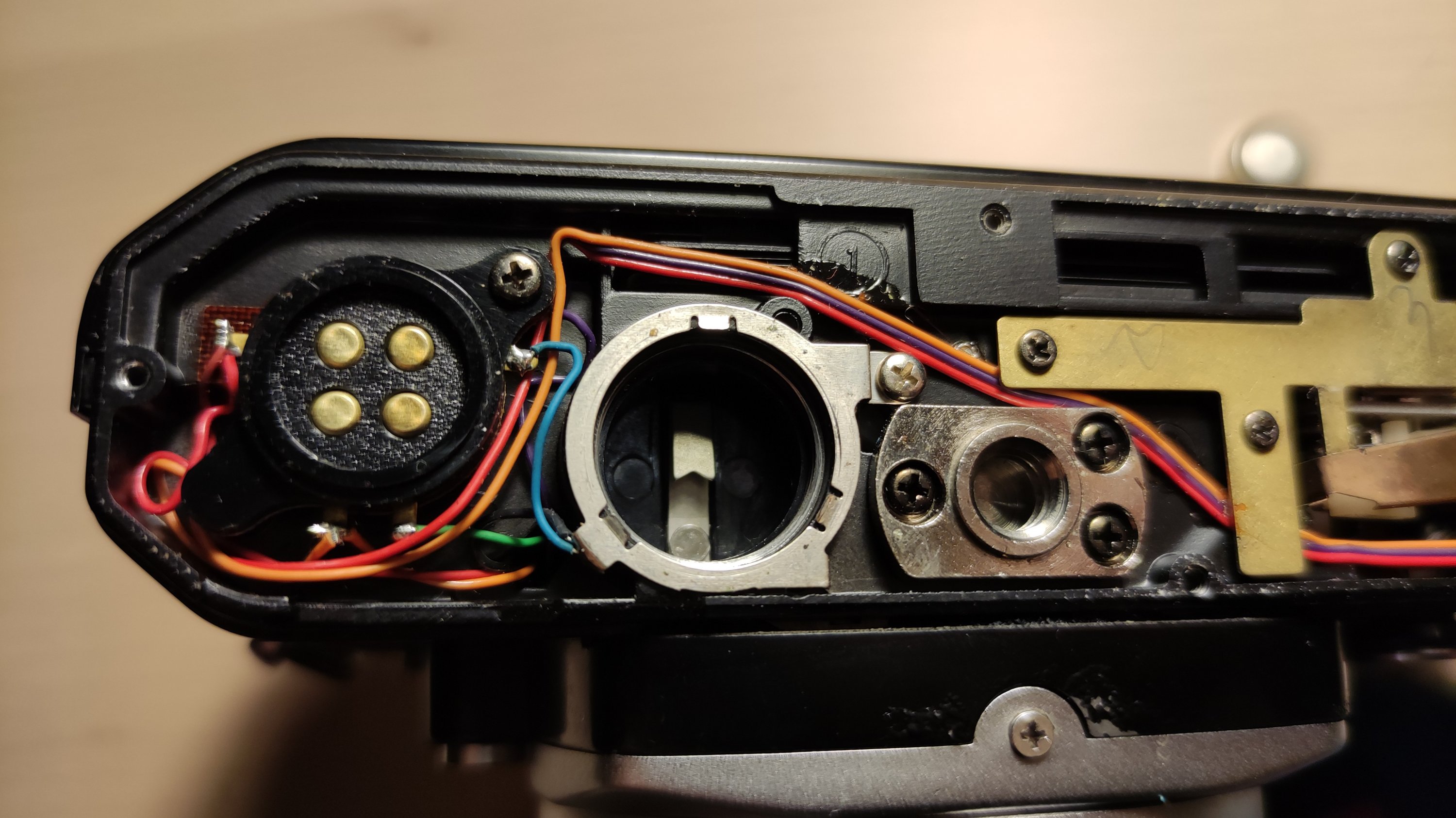

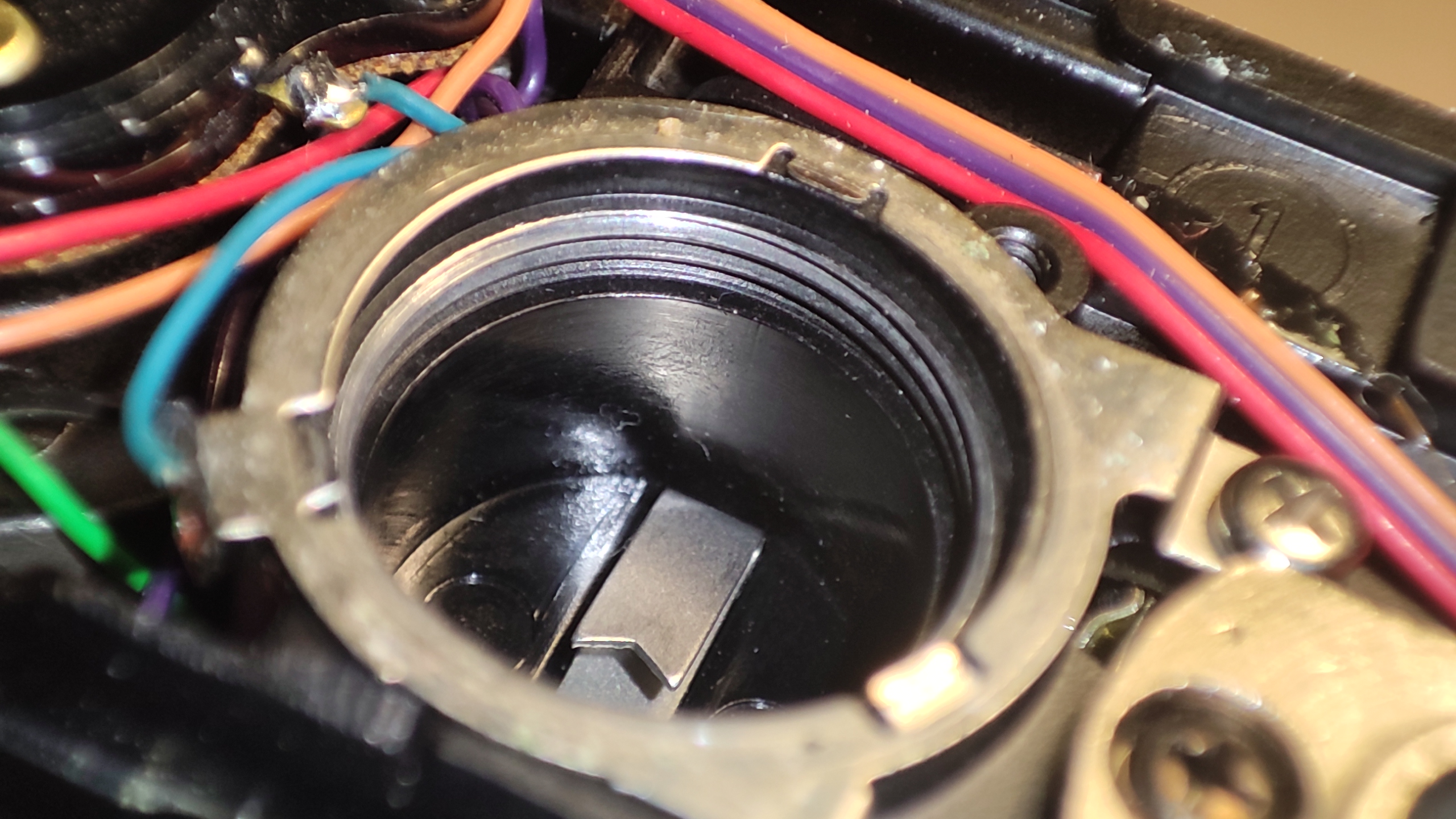

Please post a picture of the battery cap battery side and the threads of the cap and the bottom of the camera with the base plate removed.
Thanks, I read the procedure which seems doable but I'm missing some tools such as "Shutter tester J190022-1" (maybe I can somehow use a hack or buy a cheap tool somewhere) and "Special top cover for brightness adjustment J15145" (I'm not sure if it's necessary). There is something I don't really understand, like for example, EV14 stands for Exposure Value 14 but how do you read this value?
Here are the pictures:
And the bottom of the camera without base plate. Don't hesitate to ask me macro pictures if needed. I can also make videos in macro. I so much wish I could solve this issue and go out shooting some Hilford with the 50mm 1.4 lense...
While I'm aware that digital cameras pick up more dust than you see with the eye there is light corrosion all along the the edge of the camera body, the battery holder threads and the battery socket threads. Use a standard toothbrush and clean the edge of the body where the base plate fits onto it. Take a scotchbrite pad, green or red, and clean the threads of the battery socket and holder and the base plate internal edges.
Now take your VOM and measure the resistance from the threaded area of the socket to the top cover on the lowest ohms setting of the meter. It should be less than 10 ohms.
The motor drive socket contacts have some tarnish. The motor drive contacts have a make/break contacts that disconnects the camera battery when a motor drive is connected. You may need to take the MD socket apart and clean the contacts. Do not loose the springs inside the MD socket or bend the pins. A good metal polish will be fine for cleaning the contacts..

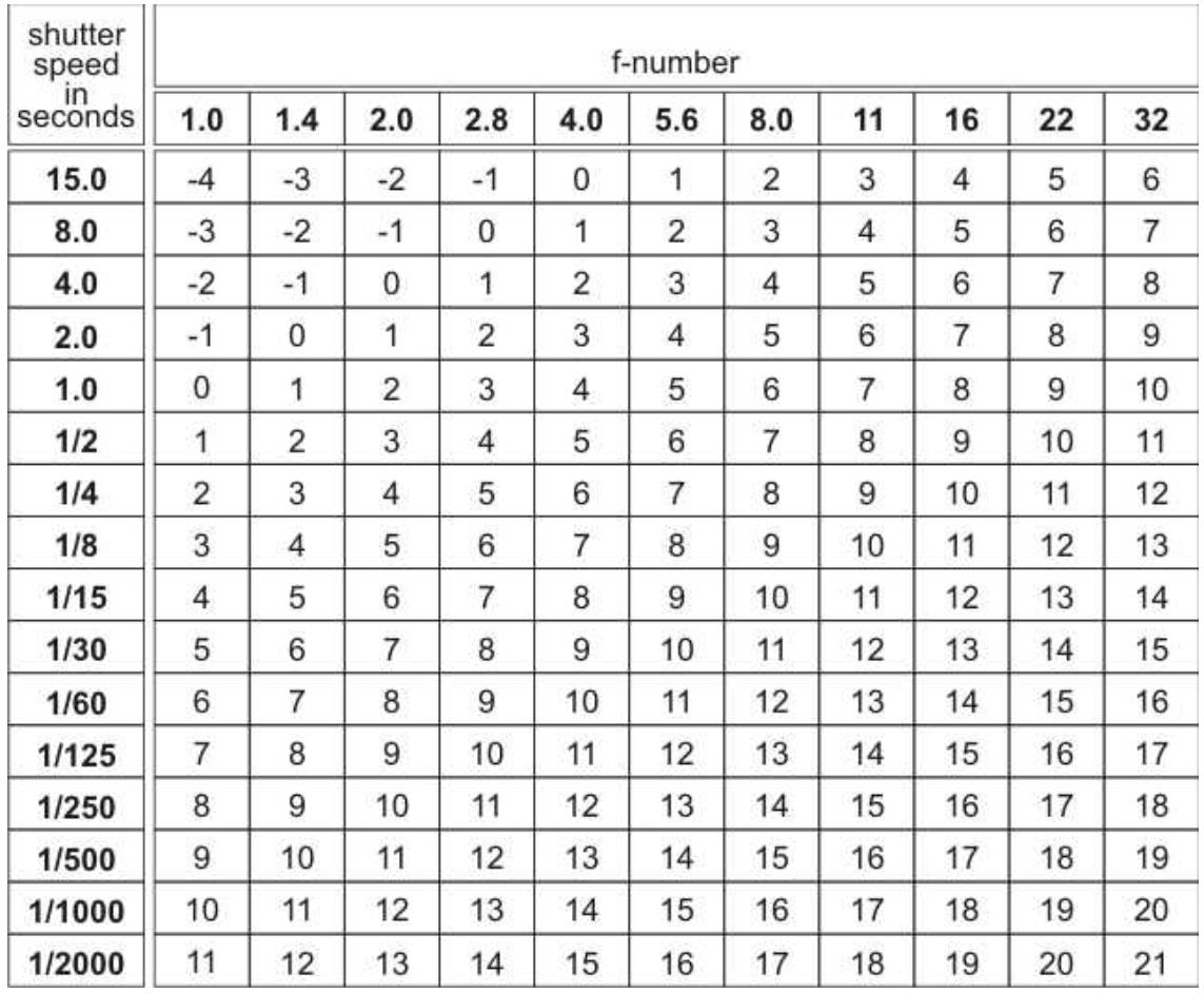

As for EV

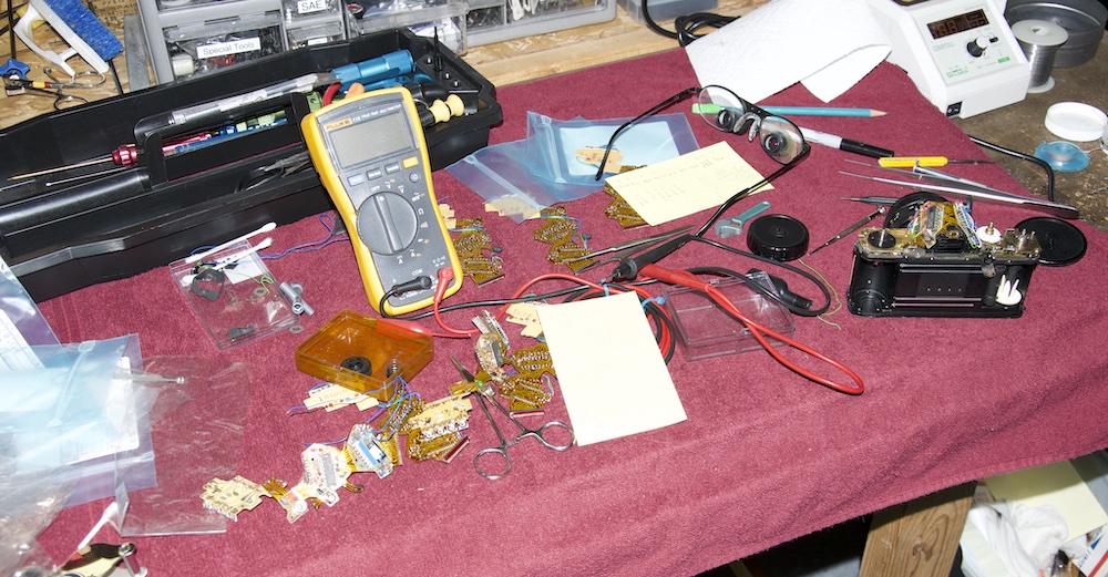

I came upon some NOS PC boards I thought I'd use to repair some electronic cameras with good mechanics, but faulty electronics.
Took about 4 hours to replace each board, start-to-finish. Needed to do some back-and-forth replacements to diagnose what was wrong.
In the end, the NOS PC boards had some of the same faults as the cameras. Likely deterioration of some components due to age (no, there were no electrolytics).
In the end I suspect some (many) electronic cameras will just fade away without any hope of resurrection.

Is the mechanical 1/90th second shutter speed functioning?
Also, do you have any clearer photos of the PC boards which allow for parts identification? Tantalum capacitors are also known to fail. And yours appears to have some blue-dipped devices which might worth a closer examination. Best case scenario is that you got multiple lifetime's worth of good NOS spares that just need a bit of reworking.
