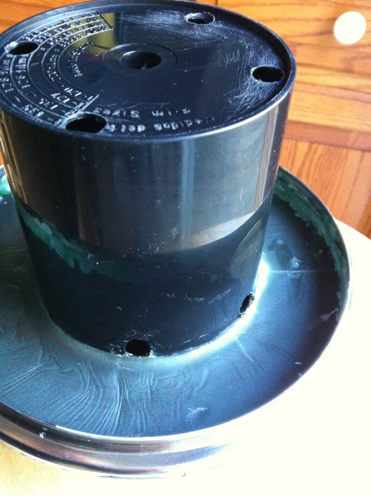

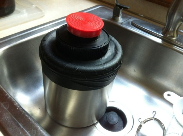

Sure, I made one from a Jobo and a pot with a glass lid...that I broke out, then used a small plastic garbage pail bottom that I cut out and layed into where the glass was then cut a hole in that and inserted a Jobo, then sealed it all Wirh glue, drilled holes in the bottom of the Jobo and top of the Jobo, then filled the top with wax to allow for drainage to hit the holes I drilled, it works but its a beast, I would be much happer to own a daylight tank MADE for 70mm...
I think I'm almost done with 70mm and thinking of selling, I have both a Mamiya RB67 back and Hassleblad back in 70mm, one 70mm reel, one 116 reel for testing old 70mm and about 300 feet of 70mm perf in my freezer...

StoneNYC,
I read this part about your DIY-project again and again:
..., then sealed it all with glue, drilled holes in the bottom of the Jobo and top of the Jobo, then filled the top with wax to allow for drainage to hit the holes I drilled,...
but still got no idea what you are talking about.
But you made me curious!

I think he means (from the photos) that he hacked a Jobo 1xxx lid onto a bastardised lid for a jar that was big enough to hold the Hewes 70mm spiral.

Hmm lots to respond to...
I think the confusing thing is this...
I had trouble pouring the chemical out because the drainage holes were too high so I added wax to lift up the level o reach the holes flat, I wouldn't process color film in this (heat + wax = bad) but B&W is fine.
The point of 70mm is to shoot and process 15 feet (5 meters?) at a time, of you have to shoot shorter lengths in order to process in smaller reels, it kind of defeats the purpose.
Also, FYI 116 reels are 70mm tall so you don't have to re-design new 120/220 spirals just buy a 116 reel/tank and use that, but again, you only get like 1 meter to process at a time. That's what I use to test new 70mm for exposure / processing if its expired.
Anyway my "daylight" 70mm tank isn't FULLY light proof, but as long as it's not high noon, it seems to work fine.
I wish I could see a picture of a real 70mm daylight tank, I wish some nice person would offer me one lol
