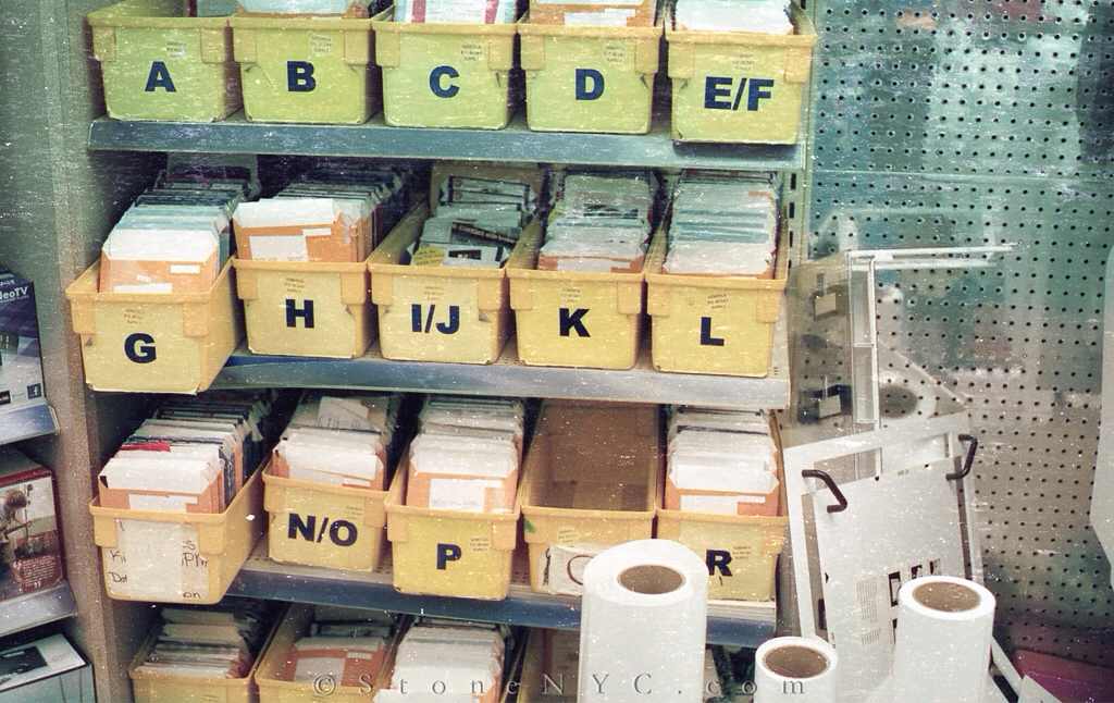

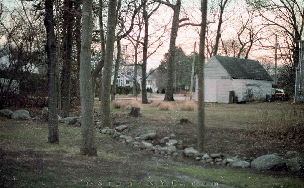

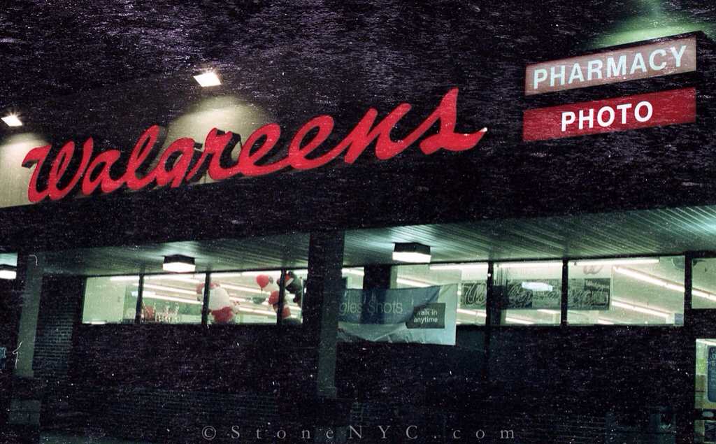

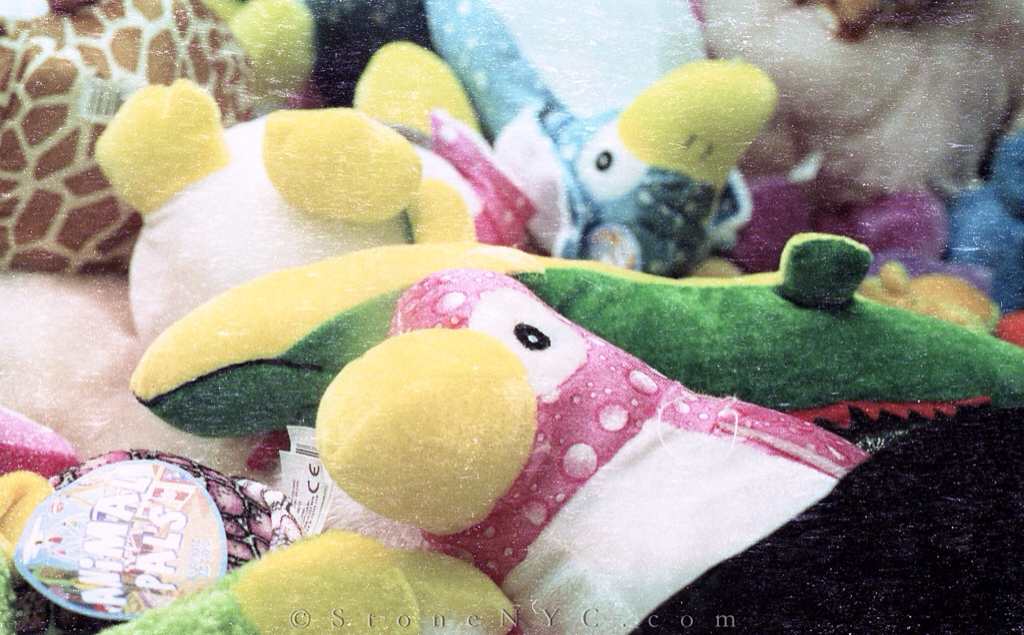

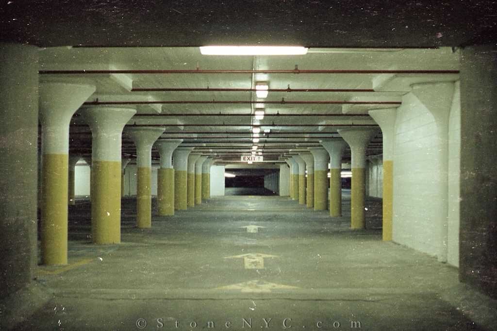

Ok examples, heres the lab and a few other images, I didn't have a fluorescent light filter at the time so I DID do slight post correction on the white balance, but that shouldn't cause any issues with identifying any problems.
And finally, the "solarization" I saw seems to have been a color shift, not sure if this was the "beginning" or "end" of the roll (it was the end... But I don't know which end the machine started with to know if it's somehow their issue or something else... As you can see there's a blue tone to the top half of the frame, this was present in a fee images.

Having just seen your scans and assuming they are a good replica of the film frames I have to say they are truly dreadful. If this isn't a one-off mistake by Walgreen's and one to which they have apologised and both refunded the cost of the processing and given you the cost of a new film then I'd never go there again.
No wonder colour film sales are suffering if this is what the newcomer to film gets and in his ignorance maybe thinks this is the best that colour film can deliver.

I would not call these artefacts solarisation.

A mix of bad processing and uneven removal of rem-jet. The white spots are rem-jet.
Also, there is fluorescent light in the pix. This is a difficult situation for any film to handle due to the discontinuous spectrum. Mixed with tungsten or daylight, it can cause a big problem with color casts across the image.

Second on the spots being remjet. C41 can get acceptable results out of motion stock but proper removal of that gunk is an absolute must.
