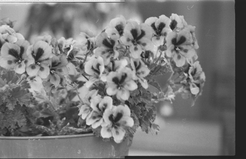

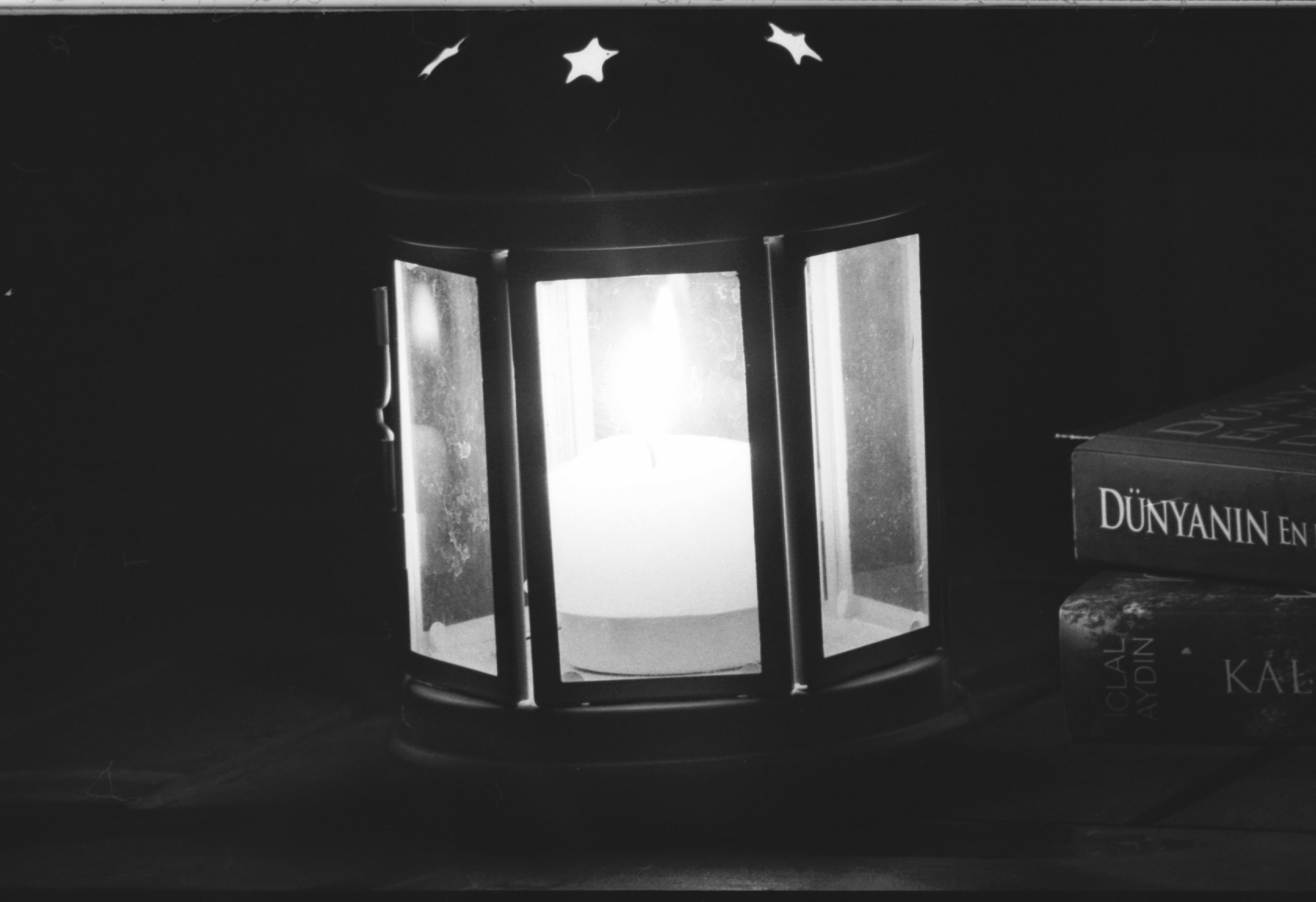

I made the development tonight. It was very difficult previously to wrap the film in a spiral. It was really annoying. I hope I can share the results tomorrow. Thank you for your encouraging information.
Camera: Olympus OM10
Film: Ilford HP5 plus 400
Lens: Miranda 70-210mm
Developer: Ilford PQ Universal
Development time: 4.5 minutes Stopper: Ilfostop 15 seconds
Fixer: Rapidfixer 5 minutes
I had a lot of difficulties while transferring the film to the spiral. The result appears in the photo. I'm so clumsy about exposure. I think the developer is very fast and effective. A few more photos to share. As a result, the developer was good but I was bad.
