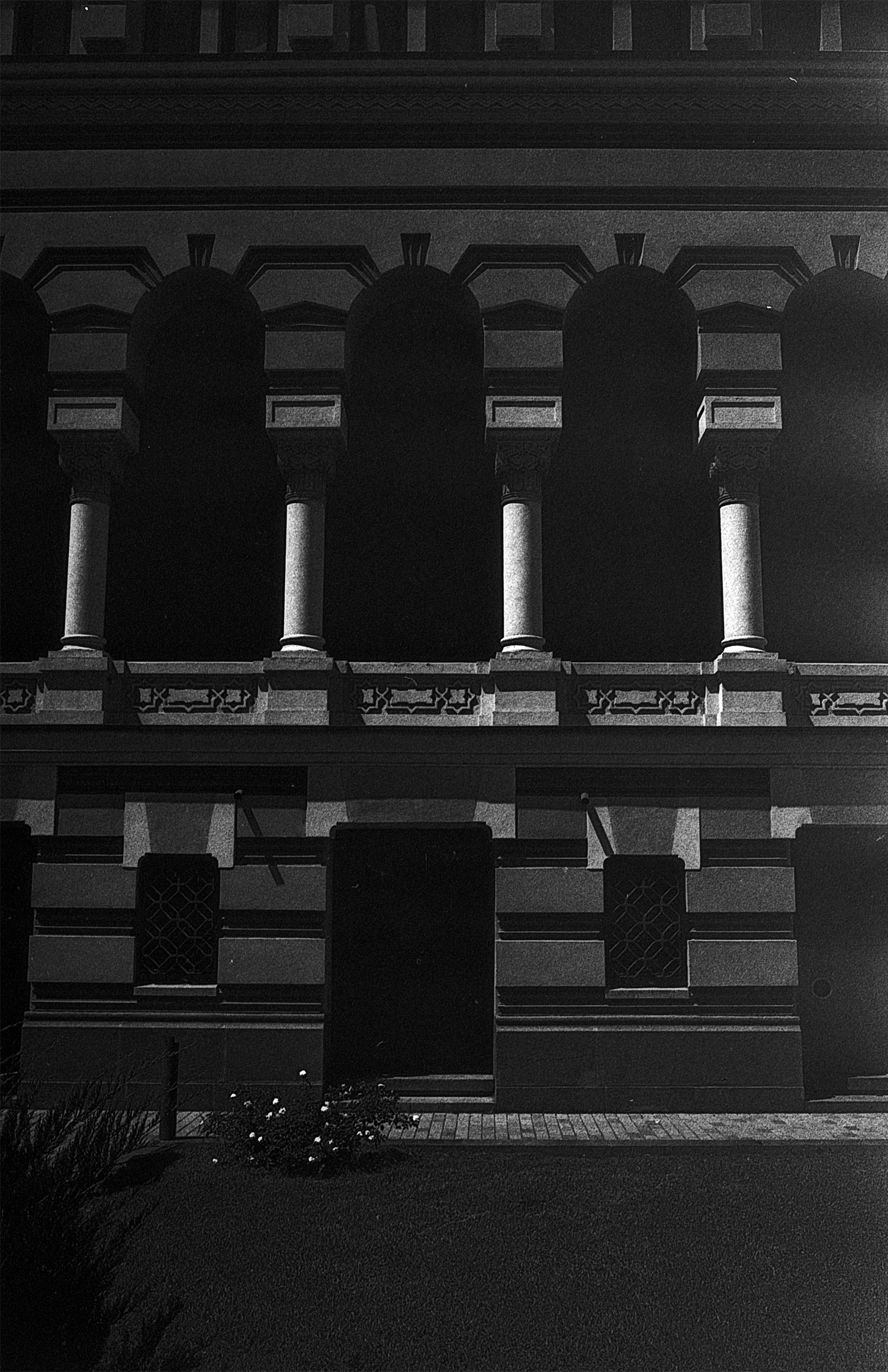

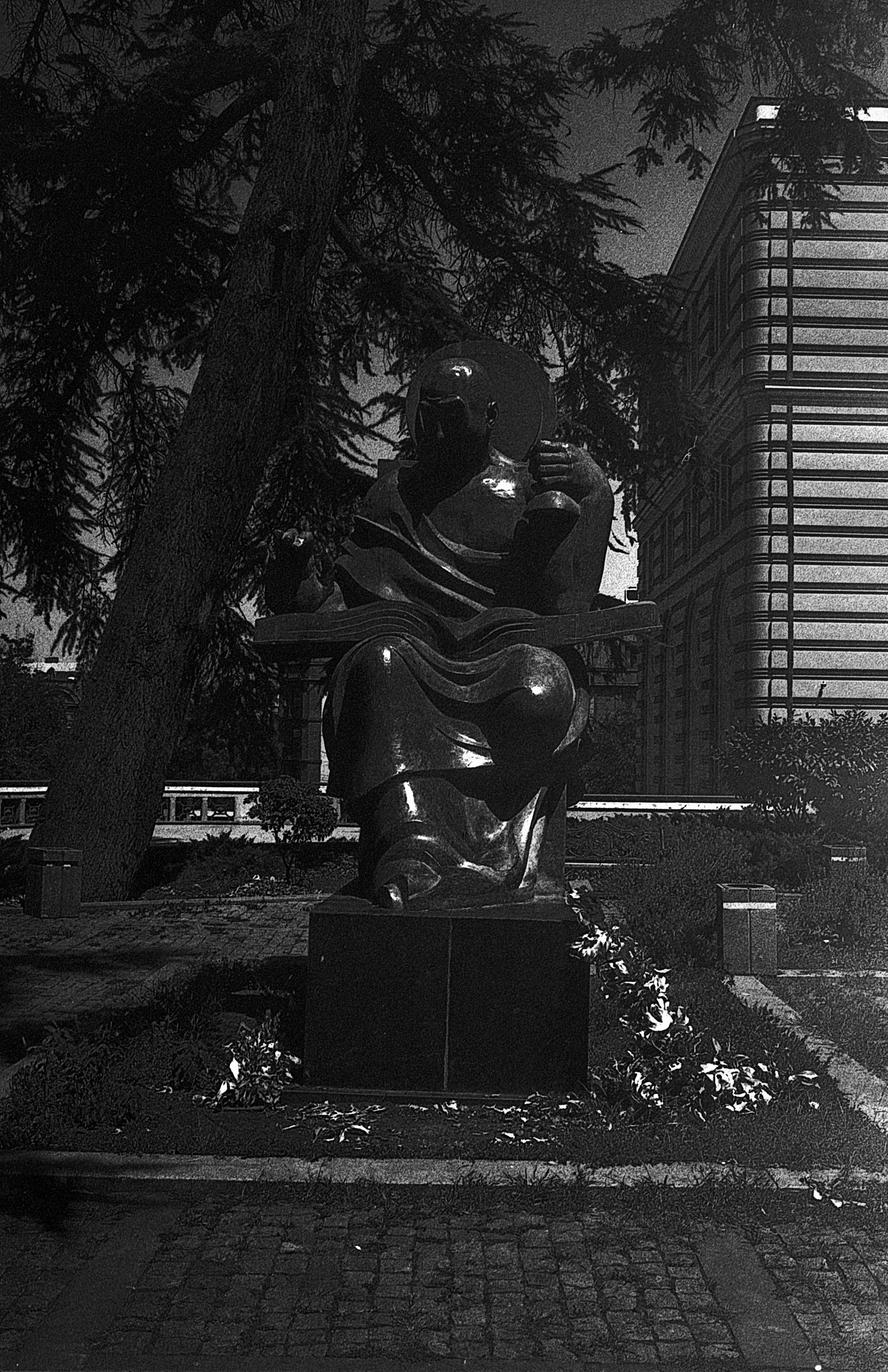

I've read the article and the comments of "happy users" as well. Since Rodinal is the only thing I have at hand at the moment, I decided to give it a try. I didn't go all the way to EI 6400 because Rodinal would already mean above average grain and EI 6400 seemed like an overkill to me. The weather was sunny this morning, so all of my shots were taken at 1/1000, f/16-f/22, meaning something like EV18-EV19. I shot ten frames and developed the film in Rodinal 1+25. Sadly I forgot to do an inversion, so the film suffers from heavy bromide drag. Because of this, I scanned only three frames, which had less drag. Here they are:

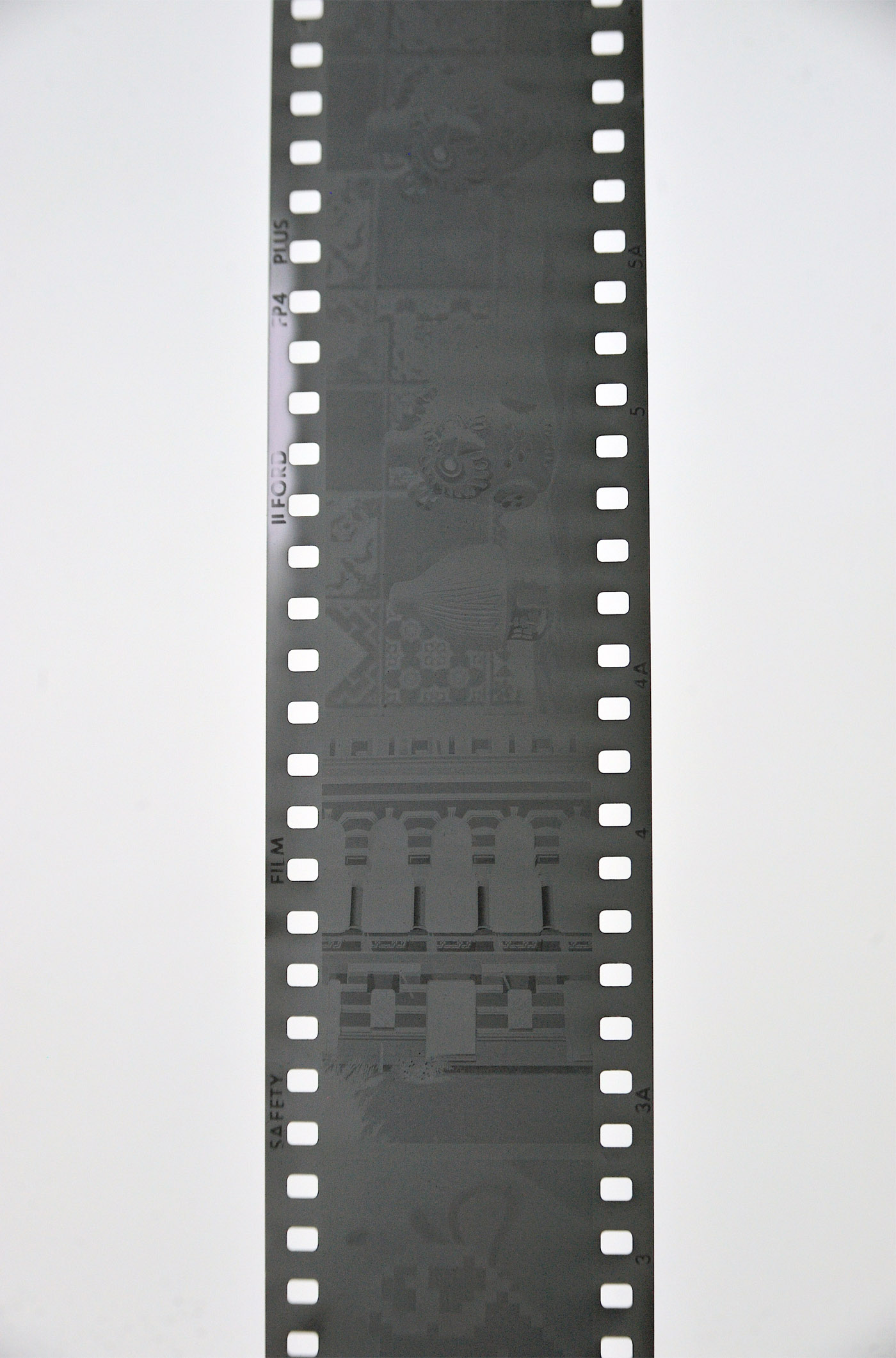

And here's a photo of the strip itself:
Is it a grainy mess? Frankly I expected worse and I've done worse back when I tried to push Kentmere 100 to EI 800.
Would one be able to print from these negatives?.. I once actually printed a picture from such terrible negative! But at the same time, my miserable experience and wasted sheets of magic paper prompted me to always expose the negative properly - it's a key to less headache in the darkroom.
Would I try molesting my FP4+ again? Absolutely not. Even with HP5+ I only go up to EI 1600, but if OP or anyone else wants to try it, I think it's doable. Especially if using a developer with less grain than what Rodinal has to offer.

Edit: I metered at EI 3200, with camera's internal, average meter.
Thanks for trying this, M88. can I take it that this was FP4 at about EI 1000/1250 based on your light conditions of bright sun and your shutter speed?

The only thing going on is that about four stops of shadow value and lower gray scale are being lopped off, with the balance getting overdeveloped to make it marginally printable, in a salvaging sense. All kinds of developers might be potentially employed in that sort of act of desperation.
pentaxuser
Oh, my bad! I forgot to mention that I measured with my camera's internal meter, at EI 3200. It's Nikon FM, pretty basic, no spot readout, no matrix or anything like that.
