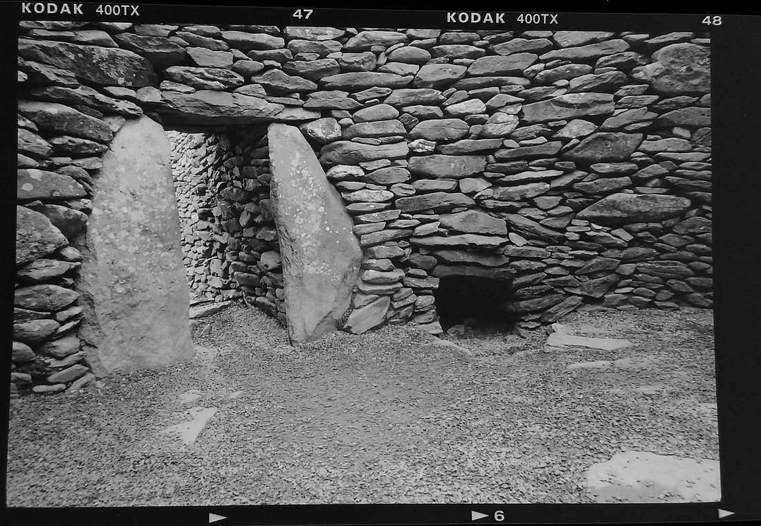

Thanks all. I had the choice of the pack film holder in beautiful shape and a roll film holder in dreadful shape. I went with the Pack film holder after the seller sent me pictures with measurements of the opening. Hoping for the best.
I'm looking forward to seeing what the 6x9 Negatives print like. (if you're curious from a Fuji gl690)
Negative peek on the light table:
