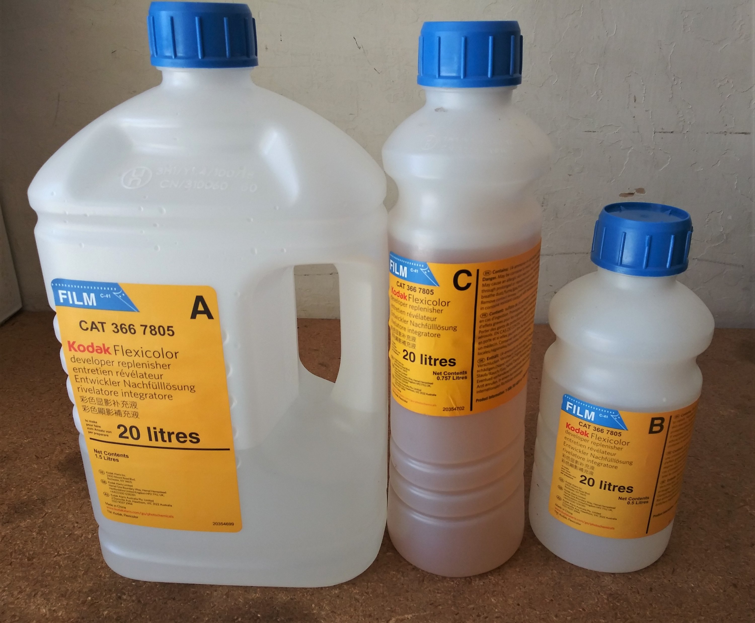

I found this partly used set of flexicor c41 chems. was about to order some fuji as kodak chems are not available, I thought before I ordered I would ask if this was usable. I know I could just mix up a small batch test with a junk roll and see for myself. but thought I would just ask a quick question.
PE back in 2014 posted that " Part C, when good, is yellow to tea colored. If it is brown or tarry it is bad. If it is bad, bad color and contrast result or there is no image at all."
so here is a small pict of my developer set. would you consider this tea color? the bottle says it was opened in 10/19. I top off all my chems with propane and it seems to keep them for a while longer than I ever thought possible (at least my e-6 fuji stock chems). thoughts?

When it looks like black death it's bad. It will start light orange and darken over time.
FYI some of these concentrates don't last very long in half filled bottles. You can either decant into full glass and/or top off the concentrate with butane from a lighter to purge out oxygen.

I, OTOH, have a set of LORR color developer that I opened and used part of to mix tank solution and replenisher in 2020 and a couple weeks ago the Part C looked just like the picture up thread. Dunno why the difference...

After two years all my unopened bottles C were black.
Oops, I just realised that I mixed this up with Ektacolor for RA4. My Flexicolor should be okay. Sorry.

Yeah, I still have some unopened C-41sm developer kits that have an expiry of 2013, and the last I checked the Part C was still tea colored. Anyway, I know I mixed and used some successfully last around 2018. It always shocks me when I check and find that it’s still good. I’ll have to look again and report back.
