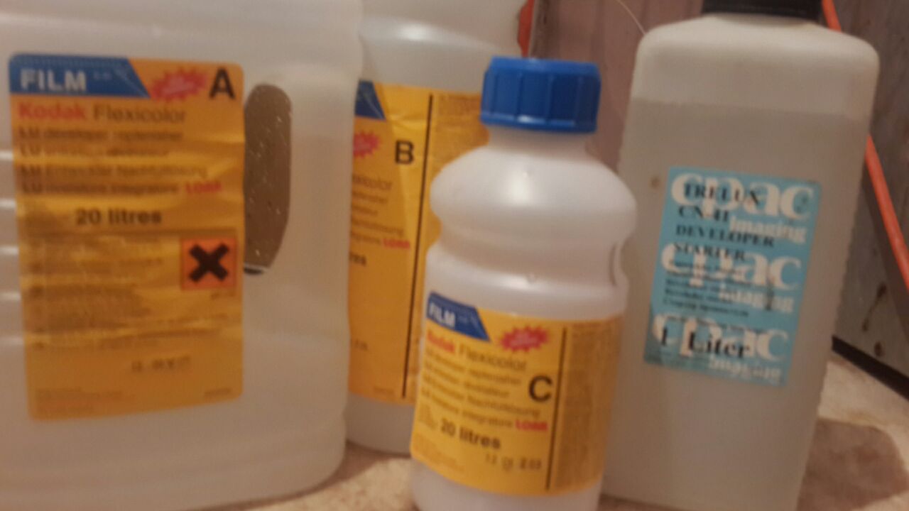

hello brother
Yes, I found that package with that kit.
- I was certain, beyond any doubt, that the package marked (C) had already expired and tested it on a test strip. So I got rid of that package.
- I still have the package that says (A) and the package that says (B), and that's the starter
I also have a component (CD4) and I don't really know how to do that, what are the quantities and proportions that I should mix.

I only have experience with Kodak C-41 Replenisher. In my kit, there was parts A, B and C and the starter is purchased separately. I replaced the bad part C with CD-4, mixing in 5 grams per liter to the replenisher mix (with parts A and B). I then just followed the instructions on the starter bottle to make a working solution out of the replenisher mix.
Finally, adjust the pH if necessary, of the working solution to about 10.0-10.2 before use.
Yes Yes, the kit I have is (Kodak C-41 Replenisher.) A & B

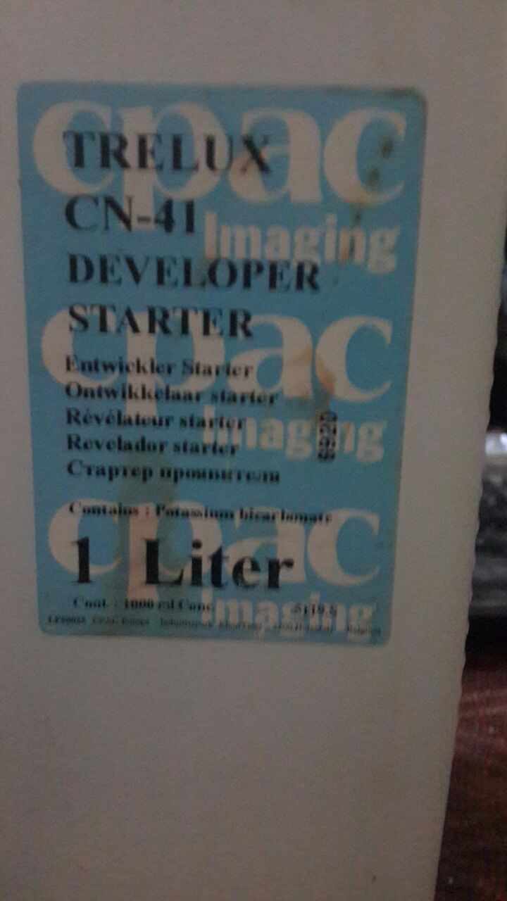

Only the starter solution is from another company, but I asked that guy who gave me those bottles (he was the owner of an old lab) and that guy told me that he was based on that starter solution and it worked just like it was Kodak,,
Please tell me how you handled this situation.
I don't have that instruction sheet you're talking about,
How many ml of package A
How many ml of package B
How many ml of starter solution?
How many grams of CD4
Then add water until the amount of solution reaches 1 liter
Is CD4 only added without potassium iodoid?
Can you give me any picture of the results of this developer.?

The mixing instructions should be somewhere on the bottles for the replenisher mix. I no longer have my bottles. The kit makes 20 liters and you would use the entire contents of each bottle. So to make 1 liter divide the volume of each bottle by 20. The part C in your photo does not look that bad to me, but if you want to replace it with CD-4, just do as I said earlier, put in 5 grams of CD-4 per liter of replenisher mix consisting of parts A & B. The potassium iodide you asked about is probably in part A but may also be in the starter.
Are there no instructions for the starter on the package? Sorry, but I do not have any amounts for the Kodak starter. After I used up all the chemistry I made with this method some time ago, I started mixing my developer from formulas and scratch chemicals.
Perhaps if anyone out there has any figures they can chime in.

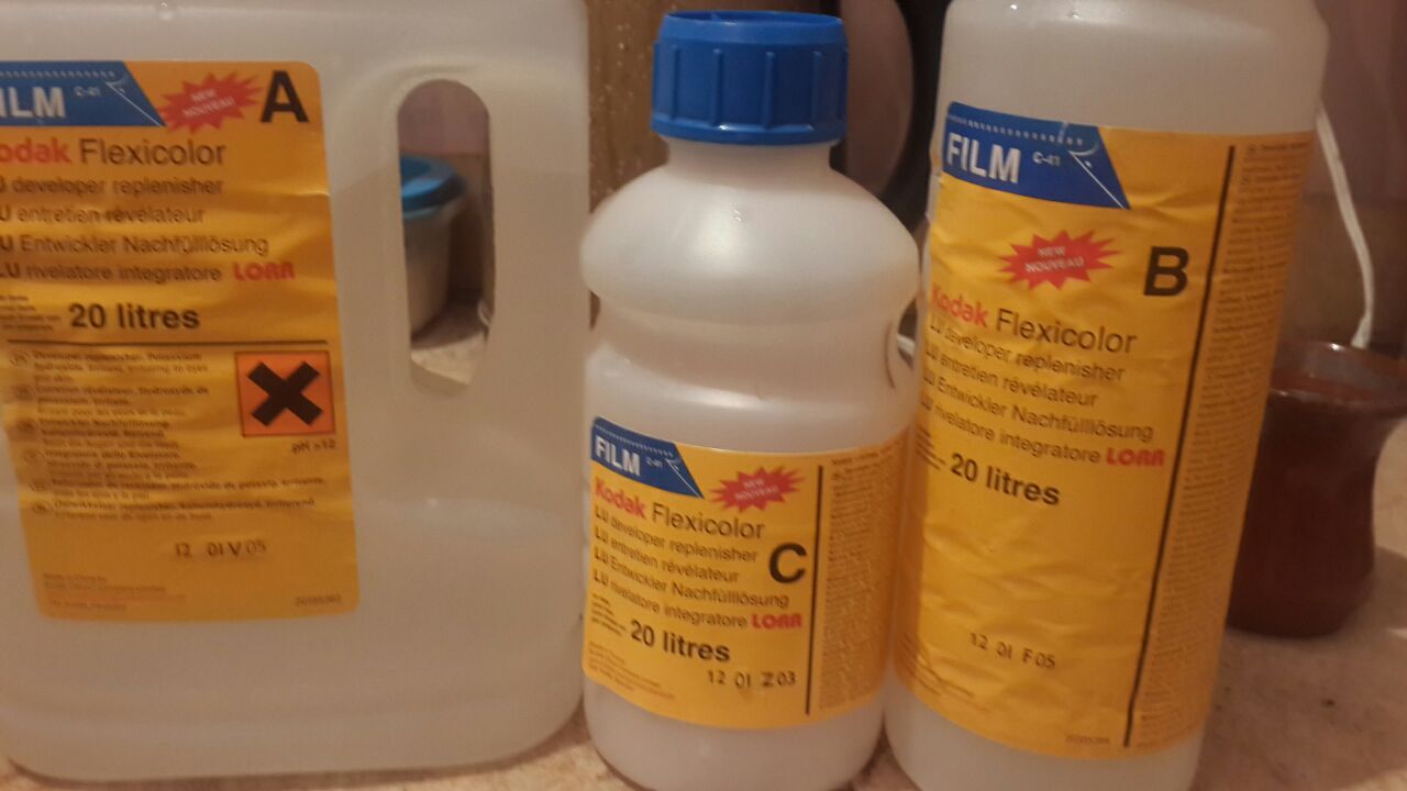

I do not have the detailed mixing instructions, it is written only on the bottles that it is enough to produce 20 liters of deflator.
I don't want to mix 20 liters at once,
I only want to mix a pint when I need to develop a roll or two.
Is there anyone who can tell how I can mix a pint, given that I got rid of the contents of the package (C), so I will need to add (CD4)
Does anyone have any suggestions?

I've got the per-liter amounts for replenisher, starter, and water, at least for LORR color developer, but they're on my home computer. Don't think this was published by Kodak, but they do have the amounts for mini-lab size batches (in Z-131?) and the arithmetic is straightforward.
I do not know what to do ,,
If you have any suggestions, that would be appreciated.
This is the picture of the kit that I have, the carton is worn out and there are no instructions papers at all..
The packages do not have any instructions.
The starter pack wasn't in the box of course, it was separate from the box, but the old lab guy gave it to me and said it was the complement to that kit (although it doesn't have the Kodak brand) but he said he was using that brand and it was working fine and it's perfectly compatible. With a Kodak kit.
I want to know how to mix a liter or half a liter at a time,,
I do not want to mix all the quantity at once.
Note that I will need to add CD4 in lieu of damage package C

Given that's a 20 L kit, you'd mix 1/20 of each bottle in about 700 ml of water, add the CD-4 (said above to be 5 g for this quantity) to replace the C component, and make up the volume to 1 L. On my last 5 L kit, the bottles were each marked with their content volume, so you'd use that figure for the division. Then you mix the replenisher so made with the right amount of water and starter (divide Kodak's published figures, available online, by the size of the tank solution they give) to make your tank solution.
Obviously you'd divide everything by two to make a half liter of working solution.

In my case of Kodak Flexicolor LORR developer starter here is the instruction. 763ml of LORR developer replenisher + 30 ml of the starter + 207 ml of water to make 1 liter of working developer. This is when you add 5 grams of CD-4 to it. Then there is the standard Kodak C-41 developer.
My LORR replenisher comes from a LORR replenisher kit that makes 10 liter of replenisher. I toss the bad part C bottle and mix only part A, B and water to 10 liters all at once and store it in a plastic bottle that has a capacity of 12 liters.
Please note that this is only for Kodak LORR developer repleniosher. For non LORR Flexicolor developer the fomula is different here. 860 ml replenisher + 18 ml of starter + 122 ml of water to make 1 liter of working developer after adding 5 grams of CD-4 powder.
The starter is from Unique Photo. It is in a 1.2 liter bottle.
