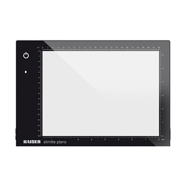

Before that some of the negatives were just rolled up in one strip and put in film cannisters. Perfectly preserved since the late 1950s. Id also like to get a small light table so i can preview the negs and slides for scanning and printing.
Aug 29, 2017
9,279
New Jersey formerly NYC
I use Kaiser Slimlite Plano. They come in different sizes.

oh that sounds good do you have a brand or part number link or anything? Im using PrintFile pages also.
I do not remember who made the plastic box, but it was a company that made binders for PrintFile like products. I hope that helps.
Aug 29, 2017
9,279
Thanks for the advice.
This one in my dreams.
I have a smaller cheaper model that you can see one 4x5 but not a lot of slide.
