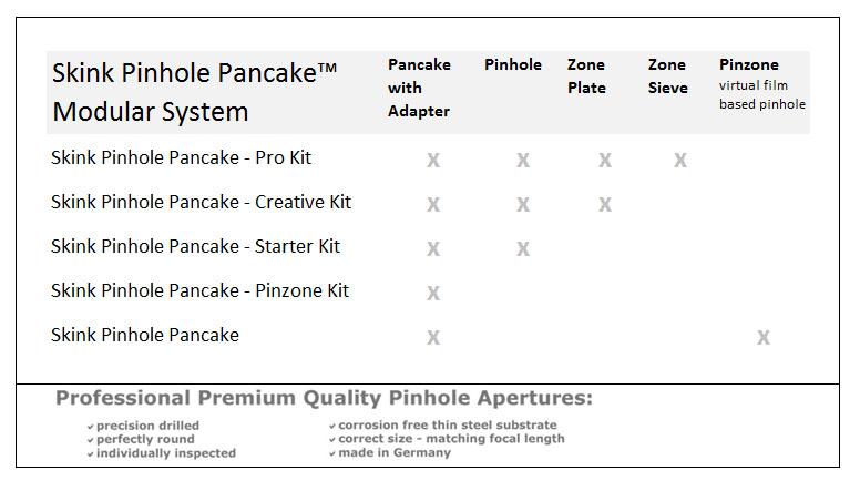

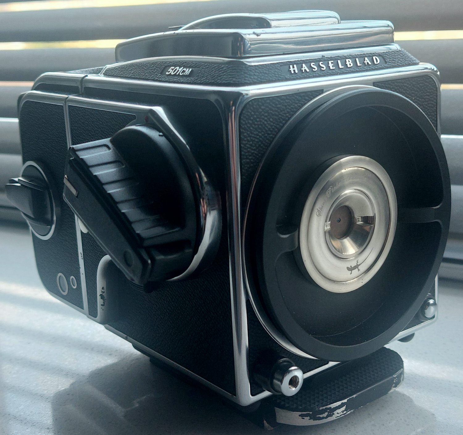

Yes, you can. You can buy laser-cut pinholes. These have known focal length and f-number, unlike the ones you make yourself.
You might want to watch Martin Henson's recent video on Youtube where he converted an old plate camera to a pinhole.
There is a number of ways to mount pinholes to you camera, including gluing the pinhole to a camera body cap, using macro bellows or some sort of a lens adapter.
Use the film you are most familiar with. Knowing the f-number of the pinhole you should have no problem calculating
the exposure time. It is important to compensate for the reciprocity failure since your exposures are likely to be long.
Framing could be challenging. Using a normal lens of the same focal length as the pinhole is one option. An external viewfinder or a viewfinder app for a mobile phone could also be used.
While it is totally possible to turn you Hassy into a pinhole camera, a much simpler folder or even box camera would produce the same results (possibly for the price of a Hassy body cap). Good luck with your project.

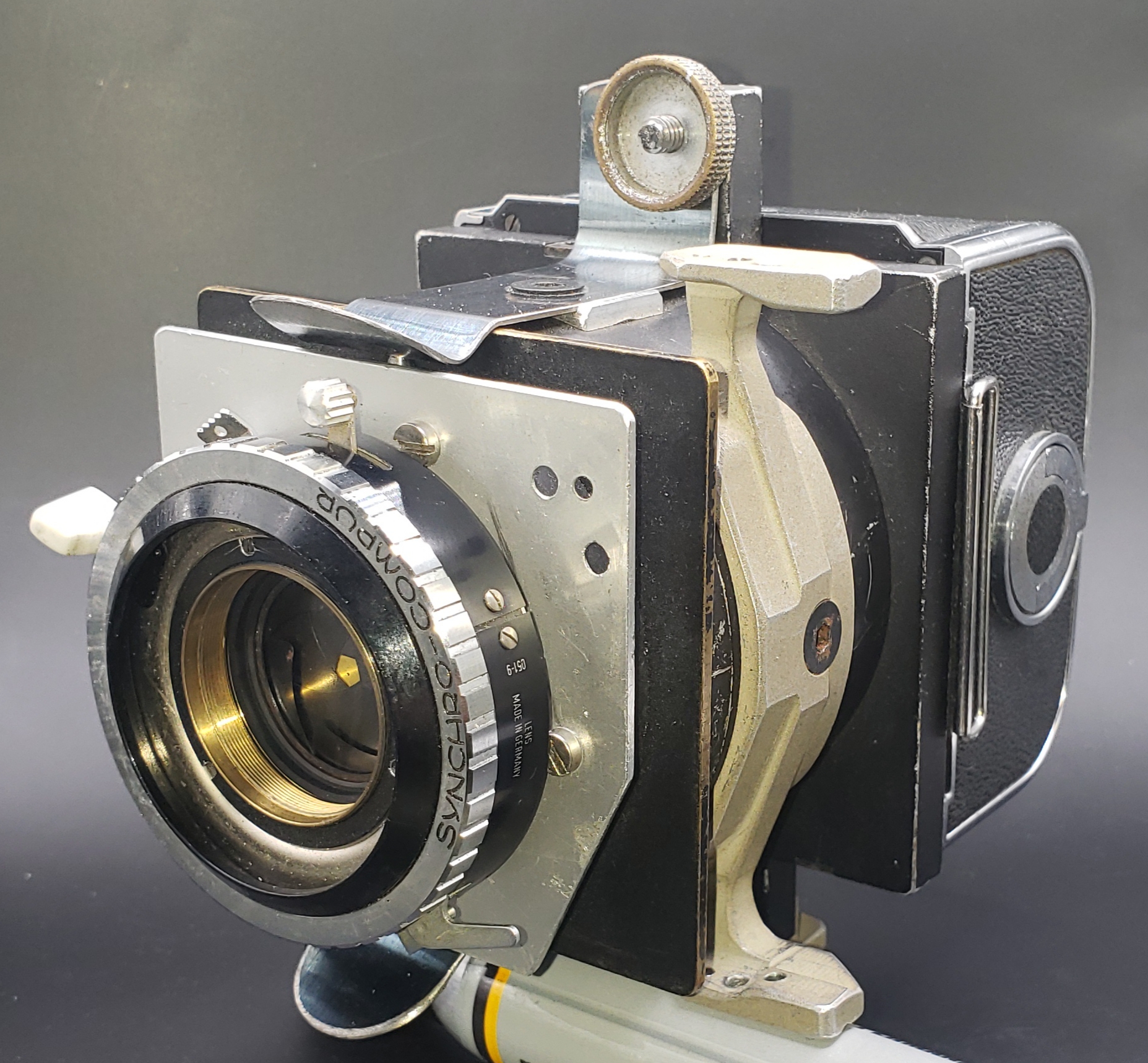

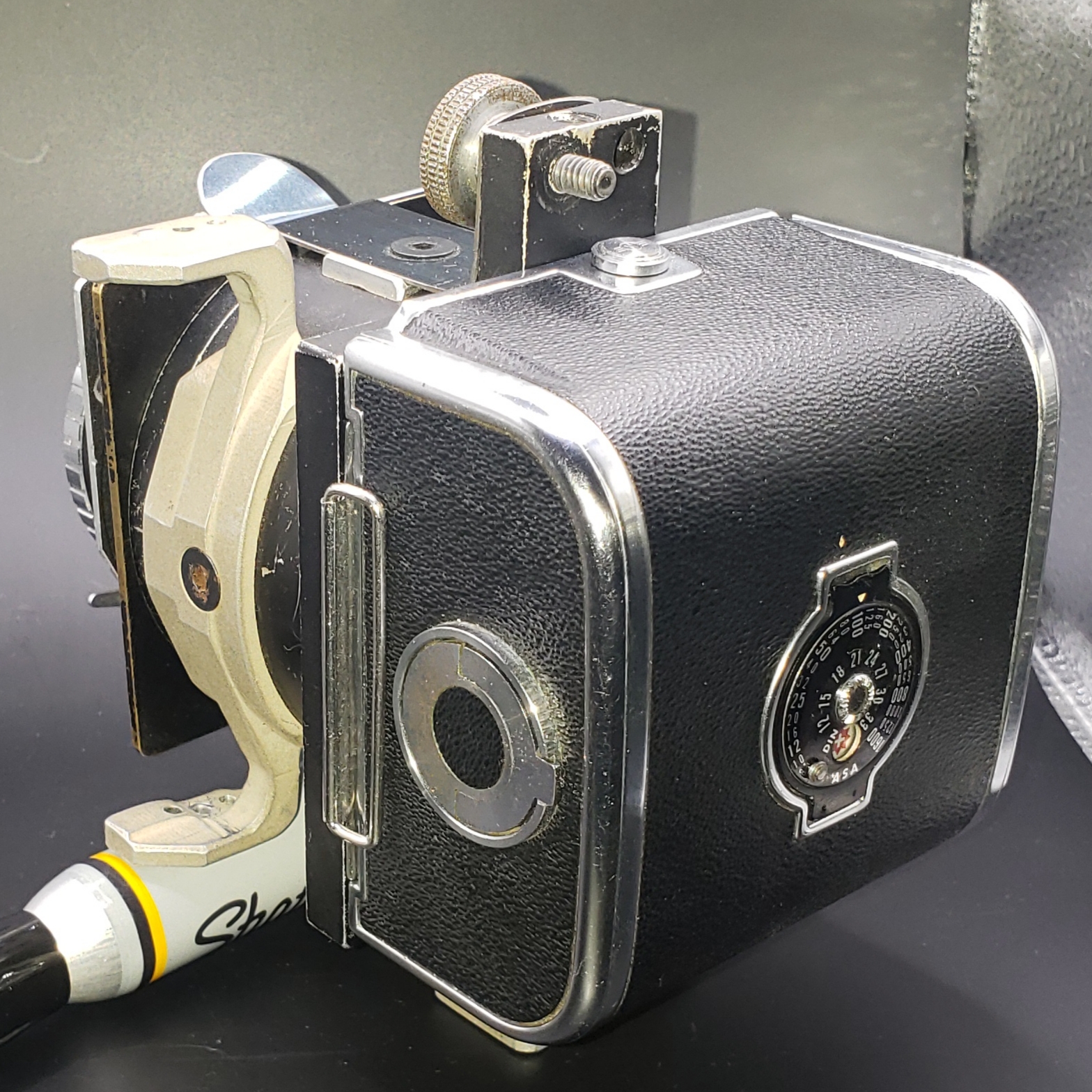

Custom Camera Building.
You can get or make pinhole body caps, but that restricts you to one focal length -- the distance from the pinhole to the film. If you want to use different focal lengths, you'll need pinholes of different sizes (diameters) and you'll need a way to change the distance between the pinhole and the film -- extension tubes, helicoids, bellows, etc.
http://www.subclub.org/fujinon/pinhole.htm
I've also seen conical body caps for some lens mounts, specifically for pinhole use -- these let you recess the pinhole inside the body.
I use a cable release with a lock. Once triggered, the mirror lifts up and the baffles open just like using the 'bulb' setting.
There’s at least one pinhole design out there that skips the. ‘Blad body altogether and just uses the back

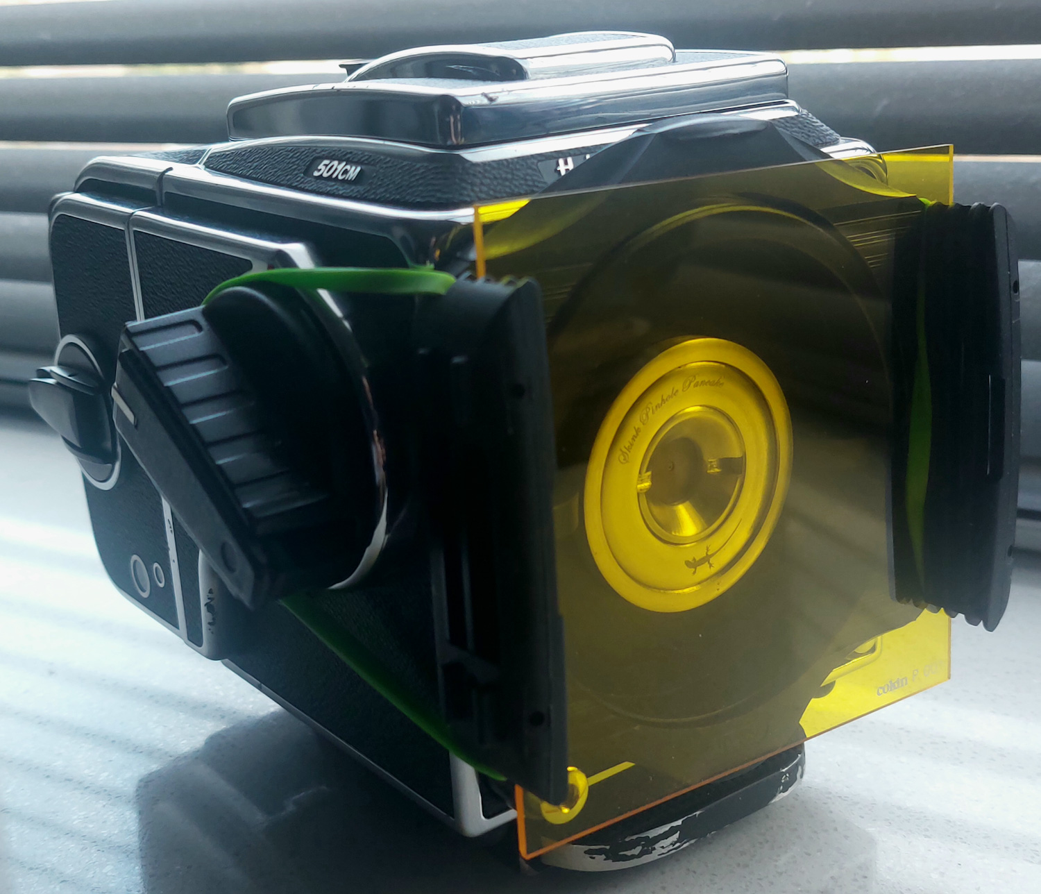

I made an 80mm for a Mamiya 645 film back, I think the shortest I could make was going to end up around 20mm. It was wood with a piece of sheet metal for the back to latch onto too. Was a fun little project but I'm not sure where I stashed the build pictures.
