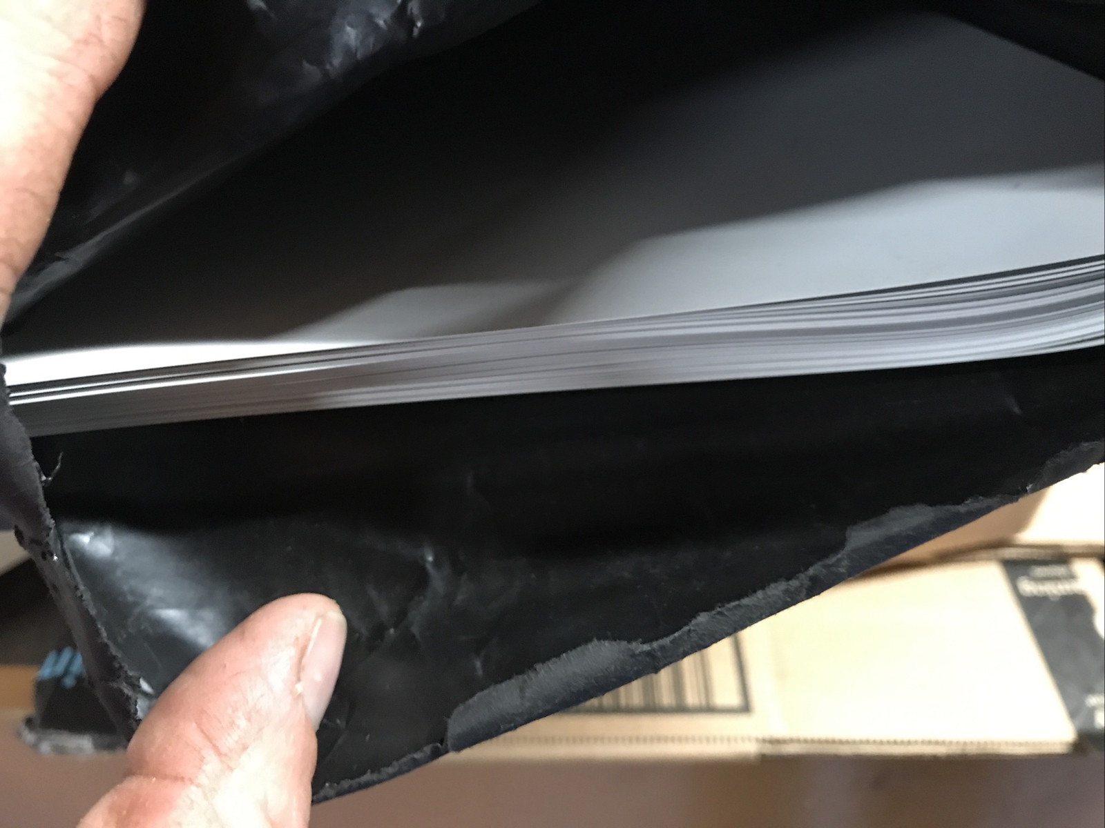

I have an almost full 250 sheet box of 8x10 mgii (maybe iii) rc paper that develops black. I got it second-hand but find it unlikely someone rifled through the entire stack of paper in a bright room. But maybe someone did.
Don't assume that opened packages have not been exposed to light.
You see listings showing the actual paper all the time on ebay. As in, for sale right now
