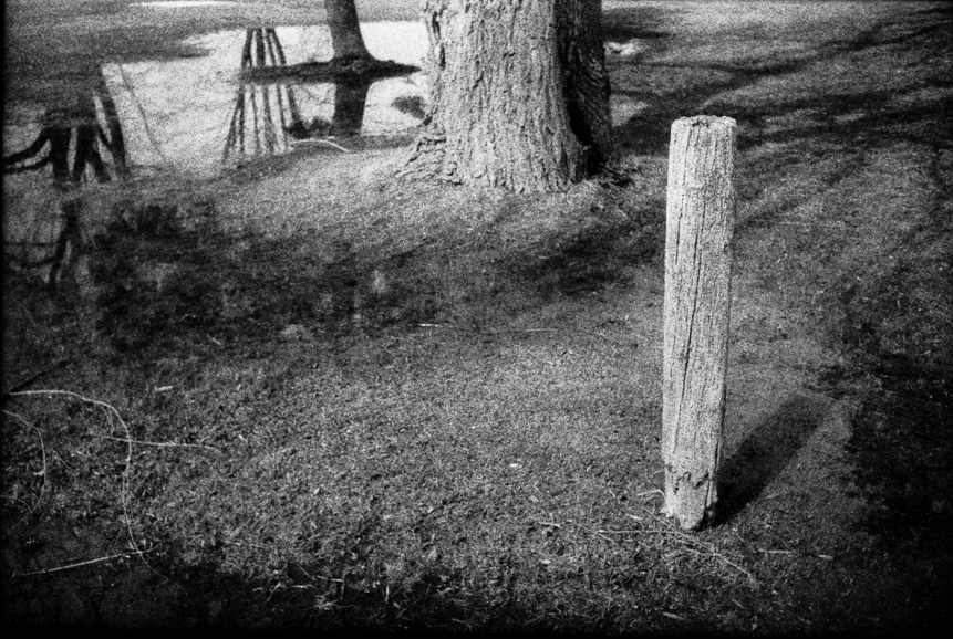

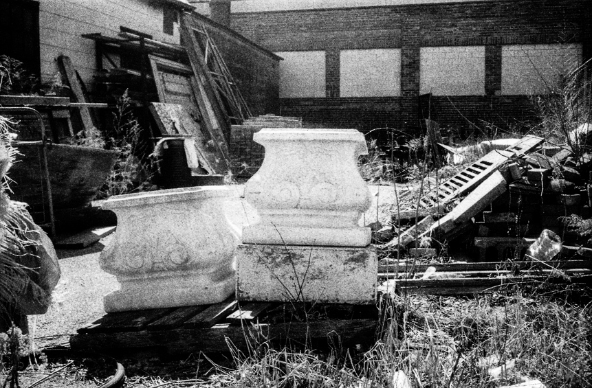

I did the mix, this developer 20 min first and then rodinal for 15 min. Kentmere 400 negs scans.
I didn't bother with more experiments since I lith the prints.
