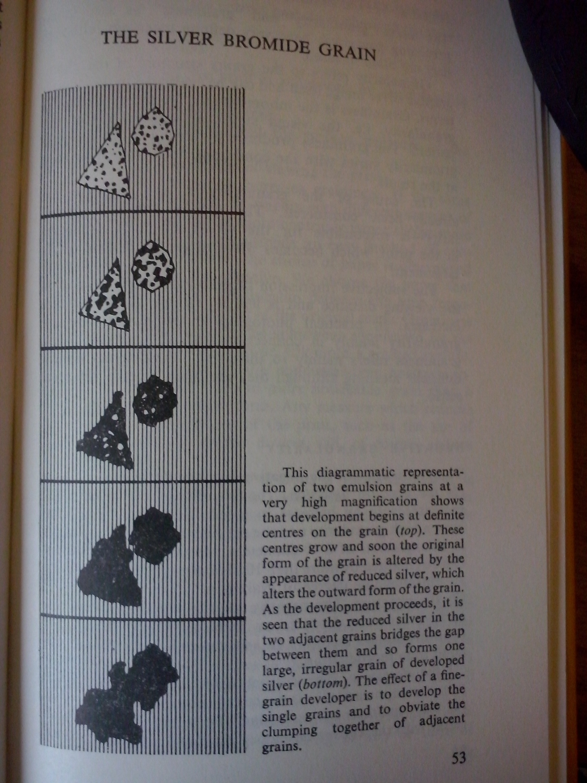

Please don't be unhappy with me, I am not trying to destroy APUG by bringing up "grain clumping", but I have a question I'd like to find out about. I tried not to give this thread a clickbait title.
I understand that AgX crystals are fixed in place and cannot migrate in an emulsion, however I was just reading Kurt Jacobsen's book "Developing" (18th ed.) and on page 53 there is a diagram and explanation of what he calls grain clumping -- where the reduced silver between two adjacent AgX grains that are developing can form a bridge between each other, thus forming a single, irregularly shape large silver grain. Is this notion of "grain clumping" also incorrect? I'd be interested to learn more about it. I don't take Jacobsen's book to be an absolute authority on photographic science (such as Haist's or Mees'), but I was under the impression that his book was fairly reputable (at least the later editions). Has the meaning of grain clumping changed over the years from "an actually occurring process of discrete adjacent AgX crystals developing into a larger irregular mass of silver" to "a fictional process whereby AgX crystals can move throughout the emulsion"?
If adjacent developing AgX crystals can form a larger agglomerate of silver, can solvent developers prevent this from happening, and if so what is the mechanism?
I have more questions regarding covering power of developed masses of silver, and the effect of physical versus chemical development on this, but I'll try not to complicate things all at once.

NO Two developing silver grains can grow toward each other but they don't actually merge at least in the conventional sense of the word "merge." In other words they never become a single crystal. The Law of Entropy makes it energetically impossible. BTW Jacobson is an old book and a lot has changed with the understanding of the photographic process.

Here Erwin Puts describes how individual particles develop to filaments in chemical development, the term "grain clumps" applies to the overlap of such grain particles at different depths.
He apparently does not discuss any movement of grains through the emulsion or the agglomeration of grains so this is not a complete answer to your question.

Perhaps our discussion should recognize the fact that an emulsion is a 3-dimensional space, not 2-dimensional.
When collimated light passes through an emulsion, it can be blocked by any silver grain at any height in the emulsion.
Thus, two silver grains need not be physically attached to be a single optical entity.
This is the whole reason diffusion enlargers and condenser enlargers render dense highlights differently.
The condenser light source produces collimated light. Diffused light can take multiple paths through the emulsion.
Think of trying to look through a sheet of cardboard with a hole in the middle. No problemo.
Now try looking through two such sheets, one atop the other. Unless the holes are aligned, problemo grande.

You should think of the silver particles as growing outward from the grain of silver halide. As they grow outward they can overlap, entangle and obscure, but they do not merge.
If a silver halide solvent is present, the grains can be etched and this halide can be deposited elsewhere or result in development elsewhere, but there is still no merging or overlapping physically.

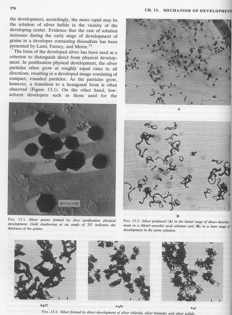

I am not a native English speaker, and it is rather hard for me to explain this process, although I understand it.
Developing starts at the edge of a crystal. You need four free electrons to start this process. From there there starts an grow of silver filaments, which takes its material form the developer: Every developer has the ability to dissolve silver halide and gives free silver ions. These filaments form the grain and not the primary crystals (which are in fact very small).
I own the 4th edition of The theory of the photographic process form T.H. James which explains this very fine.

I have scanned a page of this book which shows the process quite clearly. We can see easily how the snarls of filaments form the "grain", and not the primary crystals.

Thank you all very much. I consider myth busting a very important part of this community, and I am very glad for the members who have the knowledge to do so.
I would like to know if I understand things correctly. Sulphite can complex silver weakly (in alkaline solution), which is released, reduced, and deposited elsewhere. Sulphite and other AgX solvents promote physical development by releasing silver into solution where it is rapidly reduced and deposited on already developed filamentous silver. Developers containing very large amounts of AgX solvent (such as reversal first developers) can be thought of as a competition between chemical development (rapid process promoted by the activity of the developer) and physical development (slower process promoted by the activity of the solvent and restrainers).
How does the structure of physically developed silver compare to the structure of chemically developed silver? Haist mentions in his chapter on reversal processing (V2, p322) that silver that is physically developed is deposited on the filaments, thickening them slightly but this does not appreciably increase covering power. When considering emulsions as 3 dimensional, it makes sense how, for a given mass of silver, thickening filaments will not increase covering power as much as lengthening filaments. Is it generally true that chemical development primarily lengthens the filaments while while physical development mostly thickens the filaments? The James publication answered a lot of the questions I had, thanks for sharing it.
I guess I'm finding it frustrating trying to determine what information is true or not. For example, I have the first revised edition (1954) of Mees' Theory of Photographic Process. Therein, James wrote a chapter on the mechanism of development similar to the publication posted above. However, in this first revised edition of Mees, James writes about clumping saying:
"The tendency of a developer to form projections appears to be correlated with the tendency to form clumps of developed grains. [...] Apparently, a silver projection from a developing grain thrust into the lattice of an adjacent grain can initiate development of the latter." (p508)
I take it that this is now known to not occur. However, if there are two adjacent AgX grains which are in contact with one another, and one of them is developed, the second grain will also be developed, even if it had no latent image centers. The number of AgX grains that are touching each other can be decreased the etching action of sulphite. The grains can be reduced in size, and therefore the grains that previously touched can be made to no longer contact each other and the distance between adjacent grains may be increased. This results in an increased distance between masses of developed silver, yielding a more uniform distribution of silver filaments and appearance of lower graininess (Haist V1, p225-226).
I find James' "Fundamentals of Photographic Theory" fascinating. Do you know if there were any editions beyond the 2nd edition. Is the following a fair summary of what James describes? :
it is clear that physically developed silver can adopt filaments since the silver is mobile in solution. It is also clear that the chemically developed mass of silver is not the same size and shape as the AgX grain it originated from. This is to say that the reduced silver atoms do not occupy the same positions as the oxidized Ag+ ions originally occupied in the AgBr crystal lattice. During development the AgBr lattice is destroyed, and the Br- ion is released to solution. Somehow, the newly reduced Ag0 must adopt a new geometry. James seems to suggest two mechanisms that contribute to the movement of silver to the growing filament. 1: Oxidized Ag+ can move from the outside of the silver halide grain to the site where the silver is being reduced (without being dissolved, at least in my limited understanding of the word). 2: Silver can be reduced elsewhere on the crystal and can migrate to the growing filament. At the active reduction site, the newly reduced silver pushes a filament outward from the grain.
I've clearly got a lot more reading to do before I can ask more informed questions. Is the 4th Edition of Mees and James the most recent one?
