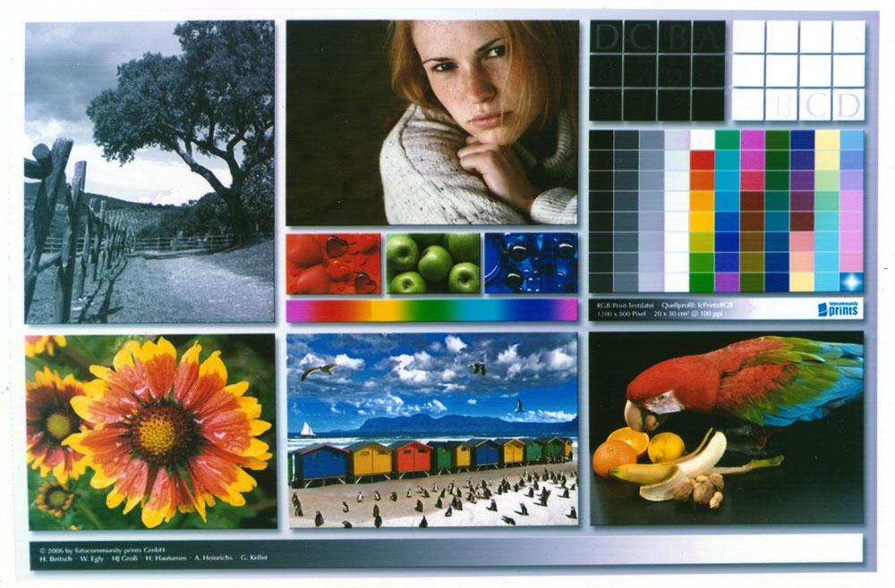

Pure red, green or blue from RGB cannot be shown in CMYK. The RGB colors you know from your PC or TV sreen are nearly single wavelengths.
Such colors are normally printed too dark, when printed in CMYK. Red could be better, but the big problem is green.
This is because you need 2 colors C + Y to create green. But when using 100% of C + Y, density is too high making the color dark. ICC profiles match the colors best as possible by making the colors brighter but it is just an approximation to RGB.
Here is an RGB Testpicture.
When I printed this to RA4 using my homemade laser imager, you can see that R, G an B, but specially G is too dark.
You can see this at the 2nd picture. This is a scan of the print. It has some color shift but you can see the big difference in the green parts.
So if I want to print a better reproduction I have to use an ICC profile, which exposes the picture like the 3rd one. Red, blue and specially green is much brighter to be exposed to the paper.

Thanks for the examples, what is the laser imager?
