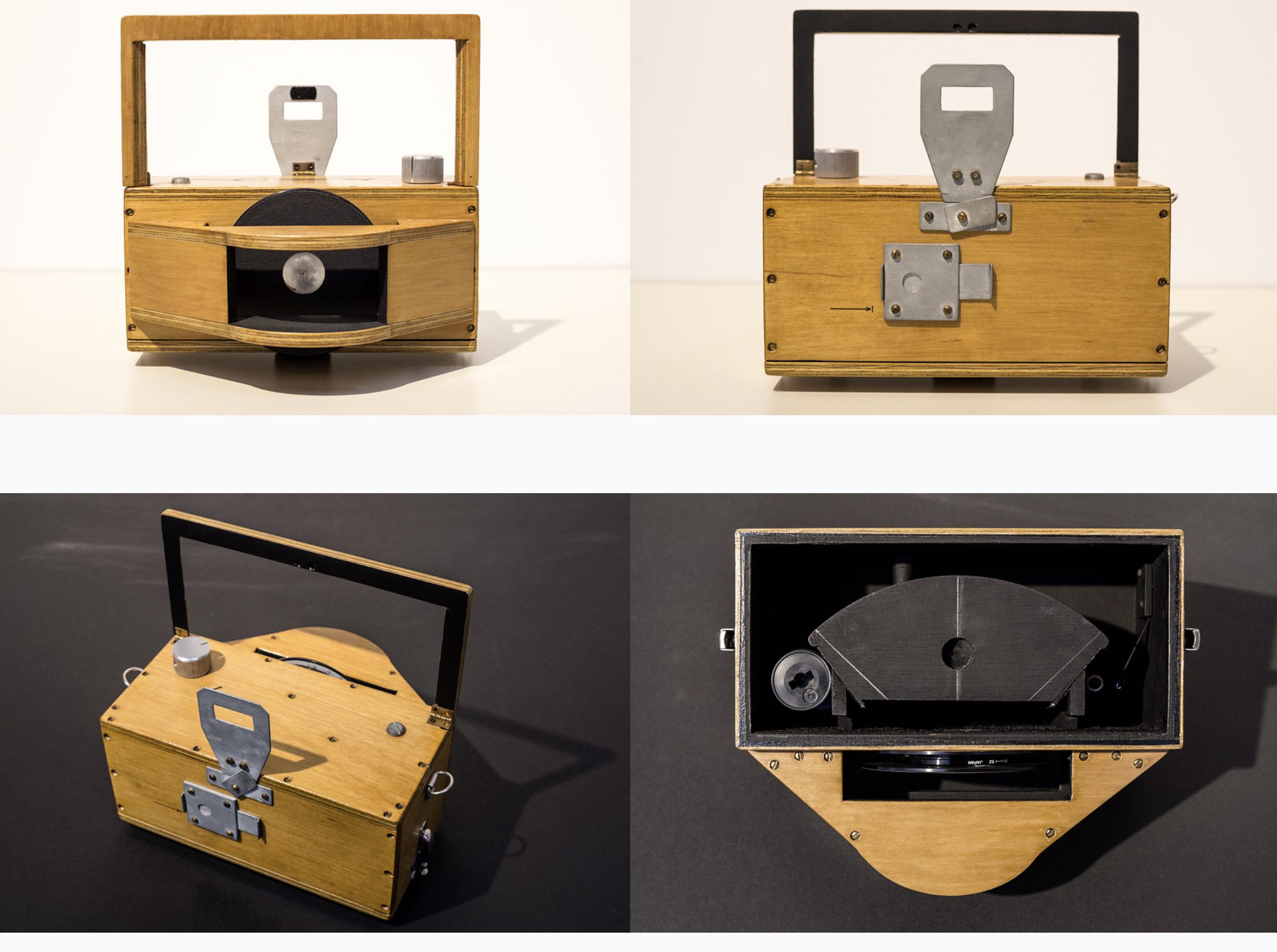

DIY Swing Lens 120 Film Jeff Bridges inspired Camera with Canon EF 35-80 - Which Format Should I go ?
I loved the attitude of jeff bridges to widelux cameras and I found his idea a widelux is between cinema and photography. It takes time photographs really.
As a poor folk , I found a canon ef 35-80 zoom lens and I want to take 35mm high format swing pictures with it when the lens set to f:22 and the zoom to 35mm.
I want to learn your wildest ideas what format should I go , 35mm X WHAT ?
OAPOli
Sep 26, 2022
859
Toronto
Nominally, the lens will cover a 43mm circle. Some lenses have a rectangular baffle at the rear which may vignette the circle. 35x35mm fits in a 49mm circle.
This choice of lens is an awkward one to make a DIY camera.
