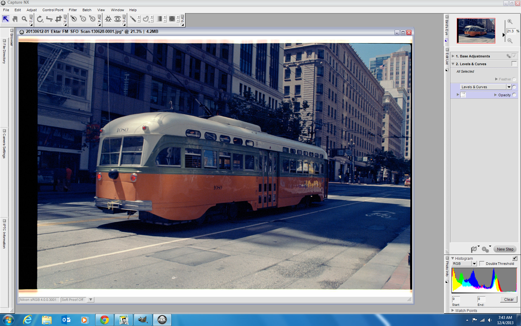

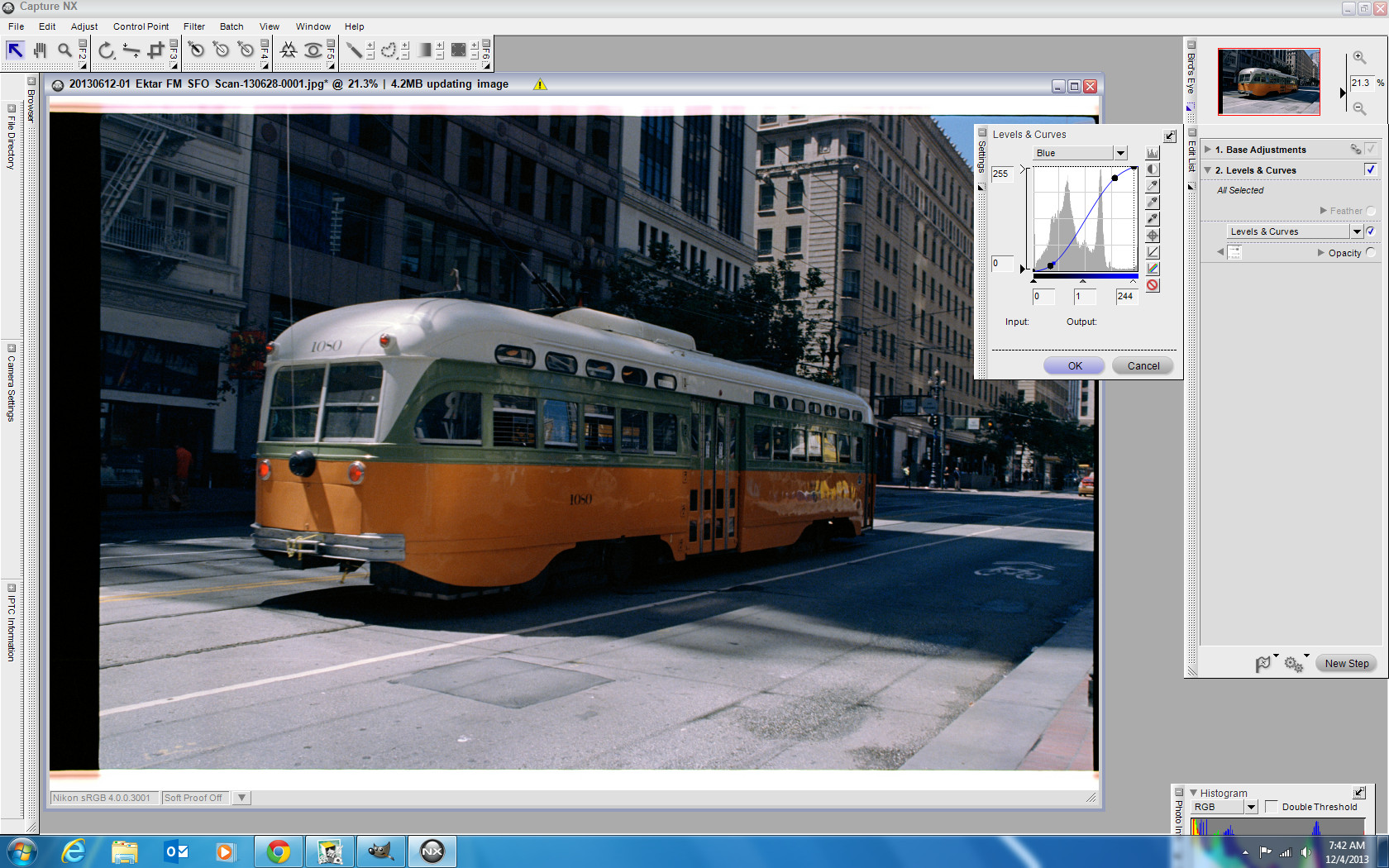

I find when I scan Ektar I usually see the shadows shift blue. In some cases I see an overall cyan cast. When using Ektar I always make sure I expose well for the shadows because they seem to shift to a purple color that's hard to correct if underexposed. I use VueScan and can get close if the film is exposed correctly but I usually have to use the RGB color curves in an image editor to get the final look right. A picture is worth a thousand words in this case so I am attaching before and after screen captures that I think will give you an idea of how to do this. In the scans I am using the tone curve to correct for too much blue in the shadows but you can use the same method to correct any color cast. Don't give up. It takes a bit of trial and error but once you figure it out you will be happy with your results. It's just the nature of scanning color negative film.
Before Correction.....
After tone curve adjustment of the blue curve only......
Thanks lamar. A great reply and pics too. I will dig out an old ektar neg and try this out. Nice pic btw! I really like the ektar rendering so hopefully I can crack this. I have PS5 so will try in that. Thanks again for taking the time. Paul
No problem, glad to help. BTW, I just took a look at your flickr stream. I like your work! Really nice shots!
