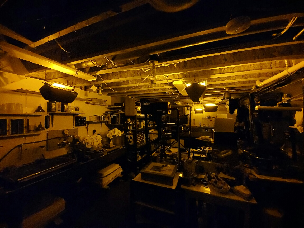

Do I count FOUR Thomas Duplex in there? Wow!
Yep, I have them open more than usual for the photo. I have an 8 foot and a 10 foot sink. They all have color print filters in the outer vanes. I still use 1960's Kodak Rapid Color Processors. These safelights provide enough light to handle color paper. The biggest issue with color is you need to give your eyes time to adjust to the low light level, that takes about 5 minutes longer than making a color print. :laugh:. If you look at the spectra of a low pressure sodium vapor lamp these safelights make sense. Black and white paper is very blind to the narrow bandwidth, our eyes aren't. I don't know what the bandwidth is for LEDs. I don't think I have more than 75 bucks each in these. I have aquired these over the last 20 years.

Or just get a gigantic darkroom. Holy crap, how big is that space?
About the size of a small 2 car garage. Keep in mind with the outer vanes closed for color printing I need the coverage. I would look very closely at inexpensive LEDs. I've been accumulating darkroom stuff for 45 years. I have 5 enlargers set up, extreme GAS. It's all a matter of letting the stuff come to you.
