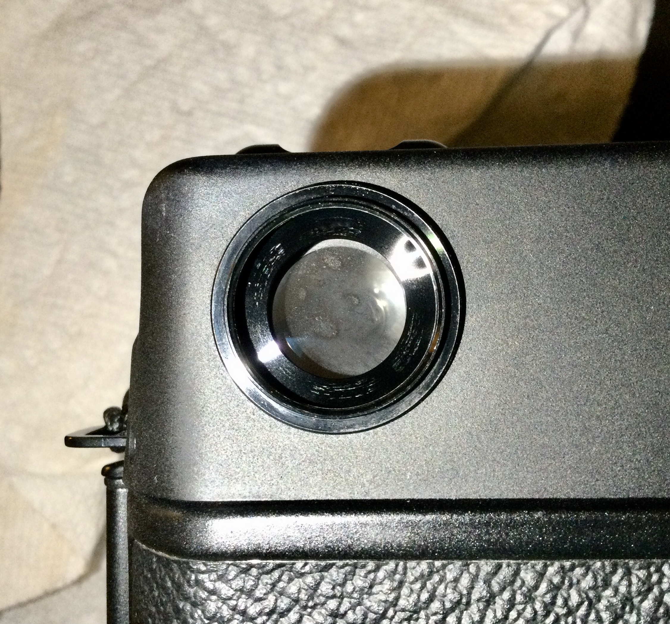

Hello fellow analog friends,
I recently purchased a Fuji GW690III from Japan that looks practically brand new a few days ago. However, I quickly realized that the rangefinder/viewfinder was quite "foggy." I can still use the camera, but this "fogginess" is really, really bothering me. I told the seller about this and he kindly refunded me $220 because of it.

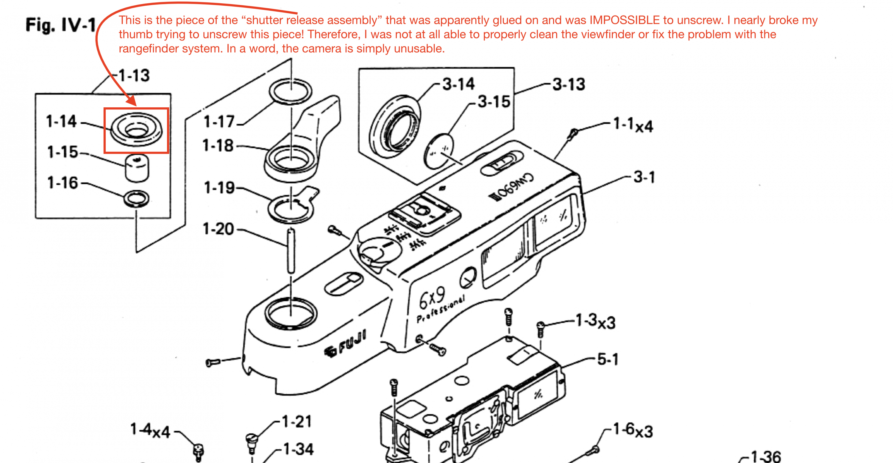

Can anyone help me with how I can fix this? I looked at the Fuji GW690III Service Manual (https://galerie-photo.com/manuels/fuji-gw-gsw-690iii-service-manual-en.pdf) and it includes a description on how to remove the top cover assembly on page 12, as well as a diorama on page 13 that shows how to take off the top part of the Fuji camera so that I can actually get to the rangefinder/viewfinder part to work my cleaning magic. It says, rather vaguely, "Apply a piece of rubber sheet to the shutter release assembly and turn it to remove, and pull out the advance film lever, stopper, [and] shutter release shaft."

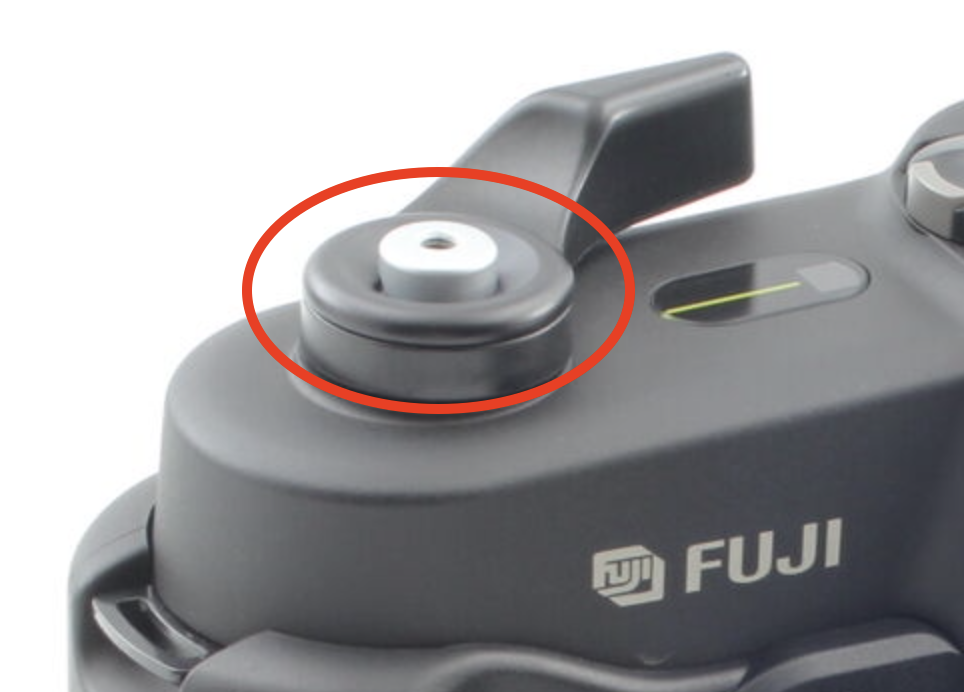

The problem is that it is seems impossible for me to turn the shutter release assembly. I can move it just a little, but that doesn't do anything. I already have blisters on my thumb from doing this for so long.
Can anyone explain please explain how to do this properly, step by step? I'm feeling pretty desperate. Any help would be very much appreciated. I would be understandably really sad and upset if I'd have to return this otherwise excellent camera.

Part 1-14 was also stuck in my case. I finally cushioned it a bit with tape and twisted it off with Channelock pliers. The damage was minimal and easily retouched with a black Sharpie pen. This was my beater camera anyway. I have an almost new one too. Afterwards, the stubborn ring went back on similarly, and everything works fine. Once that wretched thing is off, the rest of the process is easy. Carefully remove and retain the little screws and remove the whole top. After that the inside of the viewfinder window is accessible and easily cleaned. Just be aware that spare parts are no longer available unless you buy an AS-is camera for sake of parts cannibalization. So don't outright break anything.
No need to unsolder or disconnect any wiring. Just be careful not to detach it during the process. And note the NOTE; it's important.
Thank you so, so much for this! Part 1-14 is an absolute nightmare, indeed. I’m literally tending to a blister on my pointer finger caused by putting in so much force to twist, with no success. Unless you (or anyone) have other ideas, I’ve been thinking about getting pliers with soft, rubberized tips for this, based on your method (which is brilliant, by the way). I’d perhaps also cushion it with tape like you did. If you have any suggestions for tape or pliers, I’d love to hear them.

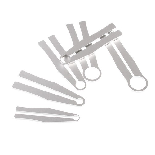

IMO, this or similar is one of the best tool buys you can make, and more you can use it instead of a spanner, the better.
https://www.bhphotovideo.com/c/prod...hobby_tool_jht9520_vacuum_pad_for_camera.html

So I've used every one of the new tools I've purchased from Amazon, inclusing 2 different rubberized pliers, 2 different types of double sided tape, silicone jar openers, a silicone/rubber mat, rubbing alcohol and ammonia (dropped in via a q-tip to help loosen) and NONE of them worked to release the Shutter Release Assembly, no pun intended. I've even used a rubber stopper and that didn't work either.
The Shutter Release Assembly has almost no side to grip onto as it's basically a curve. This makes grabbing it very hard, if not impossible. (See attached.)

A quick update!: I purchased some pure ammonia and doused the entire shutter release assembly with it a few times and gave it a good half hour to set each time, and even with all the tools I had recently received from Amazon at my disposal, I still couldn't get the damn thing to open! After staring at the GW690III service manual, I hatched a plan to disassemble the camera from the bottom up to get to the rangefinder glass. So, that said, I unscrewed off the bottom plate as well as the plastic piece directly under the front viewfinder, which was a bit tricky as I had to remove the little straight vertical rubber grip to get to the screws. Anyway, I managed to get that plastic part under the viewfinder off. I unscrewed all the screws for the entire top plastic assembly, and while the film advance lever wouldn't let me move said top plastic assembly much, it still gave me just enough wiggle room to get to the front part of the viewfinder (and rear part of the clear plastic in front of the viewfinder of the top front plastic assembly). And Voilà! I managed to insert a rubbing alcohol-doused q-tip that I had 'thinned out' with the clean new pliers I had bought and subsequently gently started cleaning both the inside part of top plastic assembly clear plastic and the front part of the internal viewfinder. I did it all carefully with extreme caution, but at least managed to get that front part extremely clean, to a point where it looks spotless.
Nonetheless, the actual inside of the rangefinder is now the challenge since there's still a bit of residual fog, specifically on the lens nearest to your eye when you unscrew the rear diopter. (It's the side of the lens that's facing inward, of course, with the fog that I can't get to). Since I've now basically given up on ever removing the shutter release assembly, I'm not sure how to clean this. Any thoughts? (I've attached a photo so you can see what I mean.)
