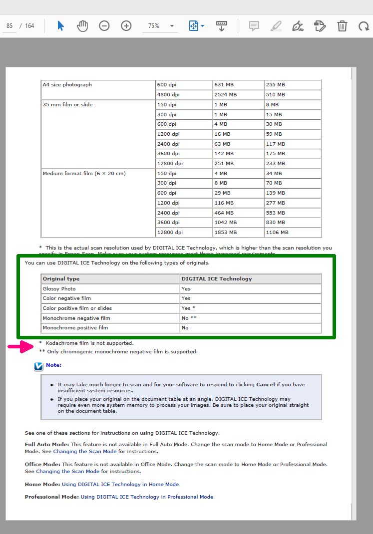

The Epson V600 scanner manual says the following: See the picture for the exceptions and which films are covered.
* Kodachrome film is not supported.
** Only chromogenic monochrome negative film is supported.
